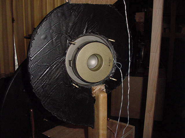

I think he was more scientific than you think. I've made a couple of pairs of dipoles and had to let the midrange run fullrange. I tried low pass filtering and it screwed up the integration of the bass to the mids. With dipoles you don't sacrifice the clarity and quality of the sound just to pick up a little extra SPL.

But... But... if you were to use a bigger amp and a Wagner record... Flying cone syndrome!
At least highpass it!
(I bet your decision was not so much scientific but that you just wanted to hear them as quickly as possible)
Well thats why it's called a system. If I build every part of it I can make it work properly together. I will not be using bigger amps in this system. The mids are so overly built it would be very uncomfortably loud for me to launch a cone. The magnet is 4 1/2" D the cone is 4 3/4" D
Bingo!
The system plays louder than I would ever want to listen to it right now with no signs of distress.
