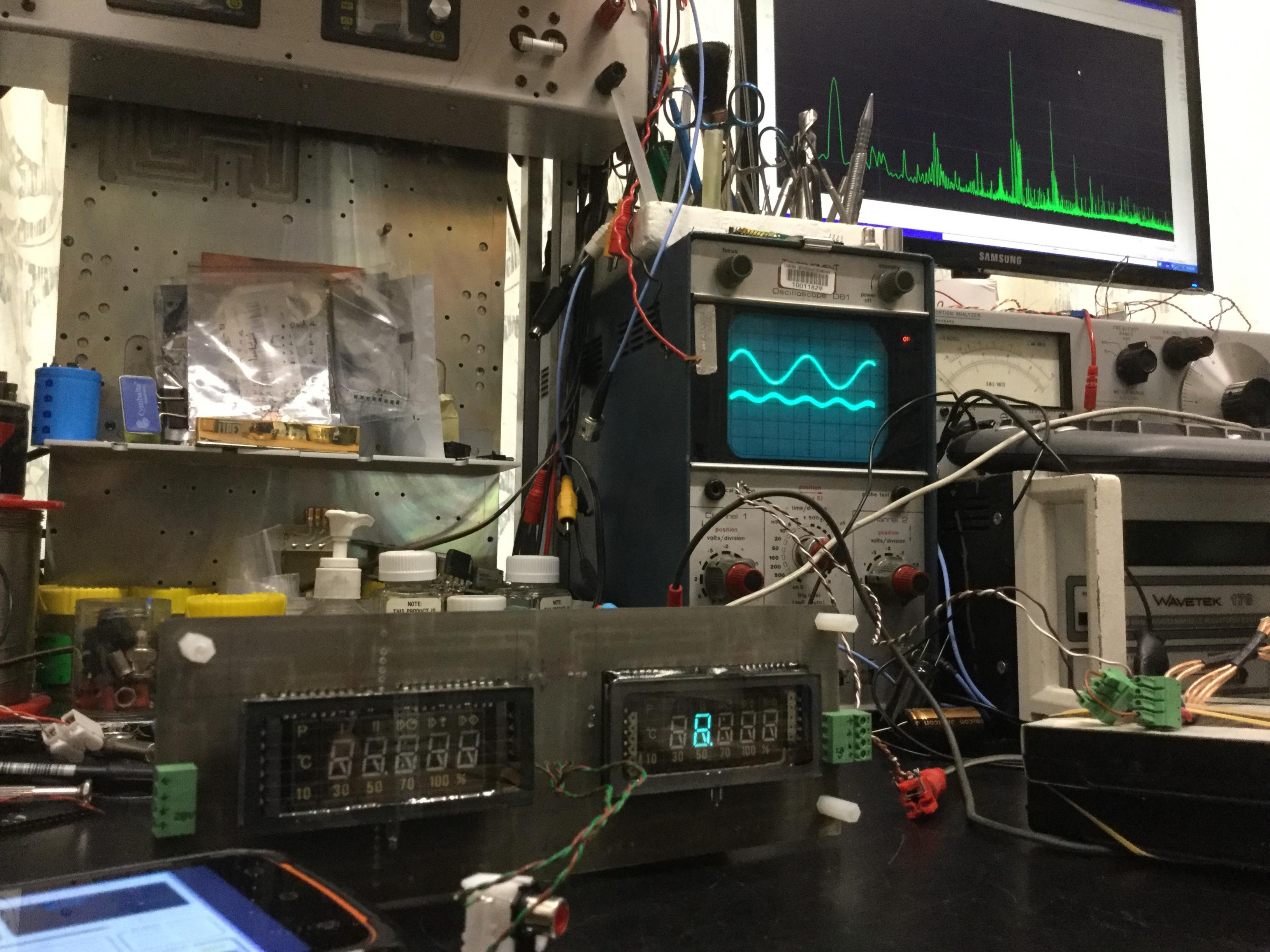

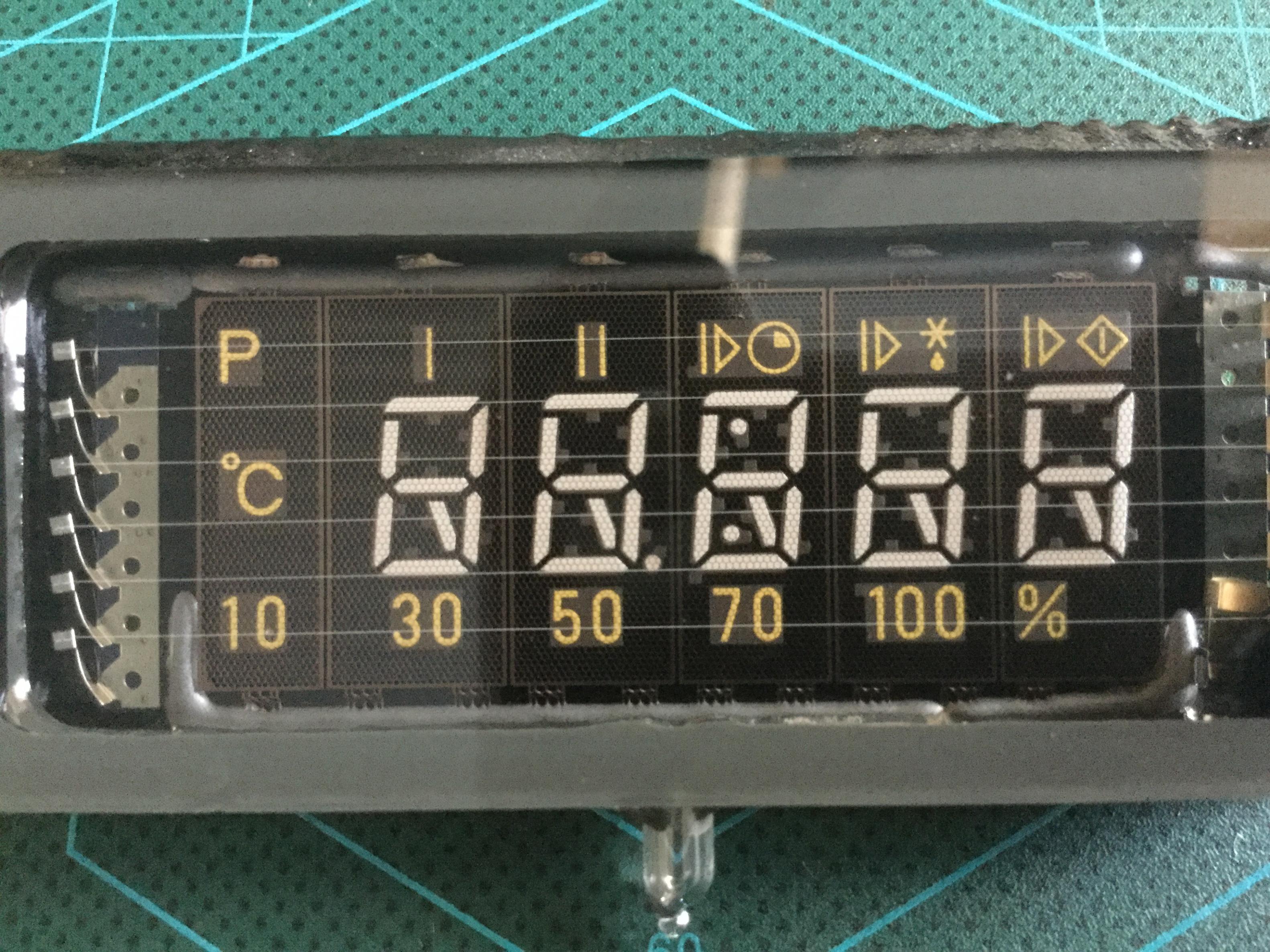

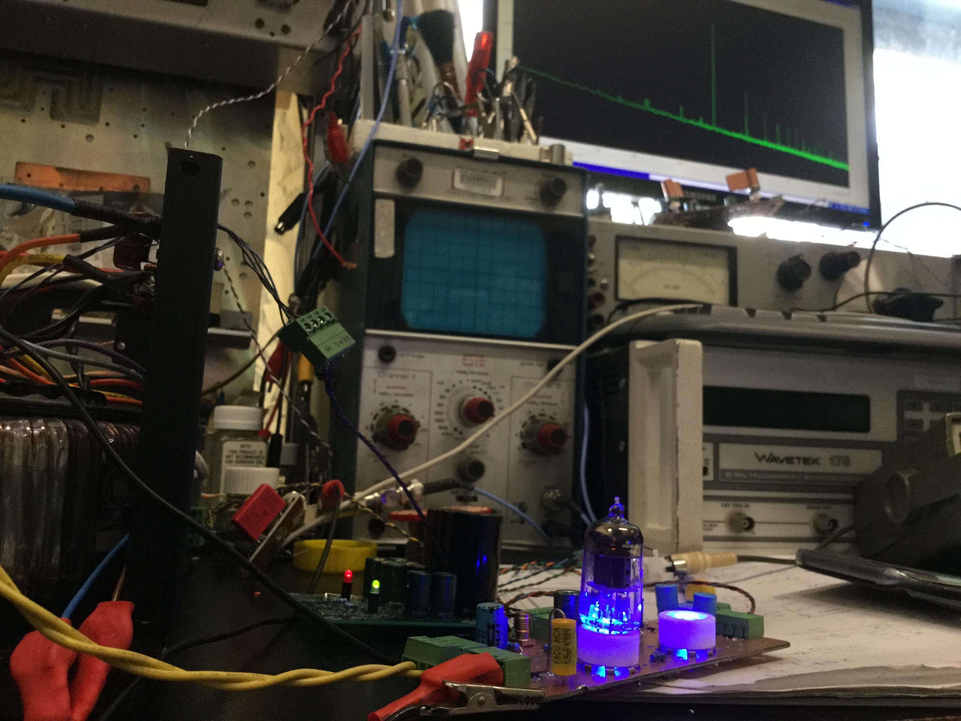

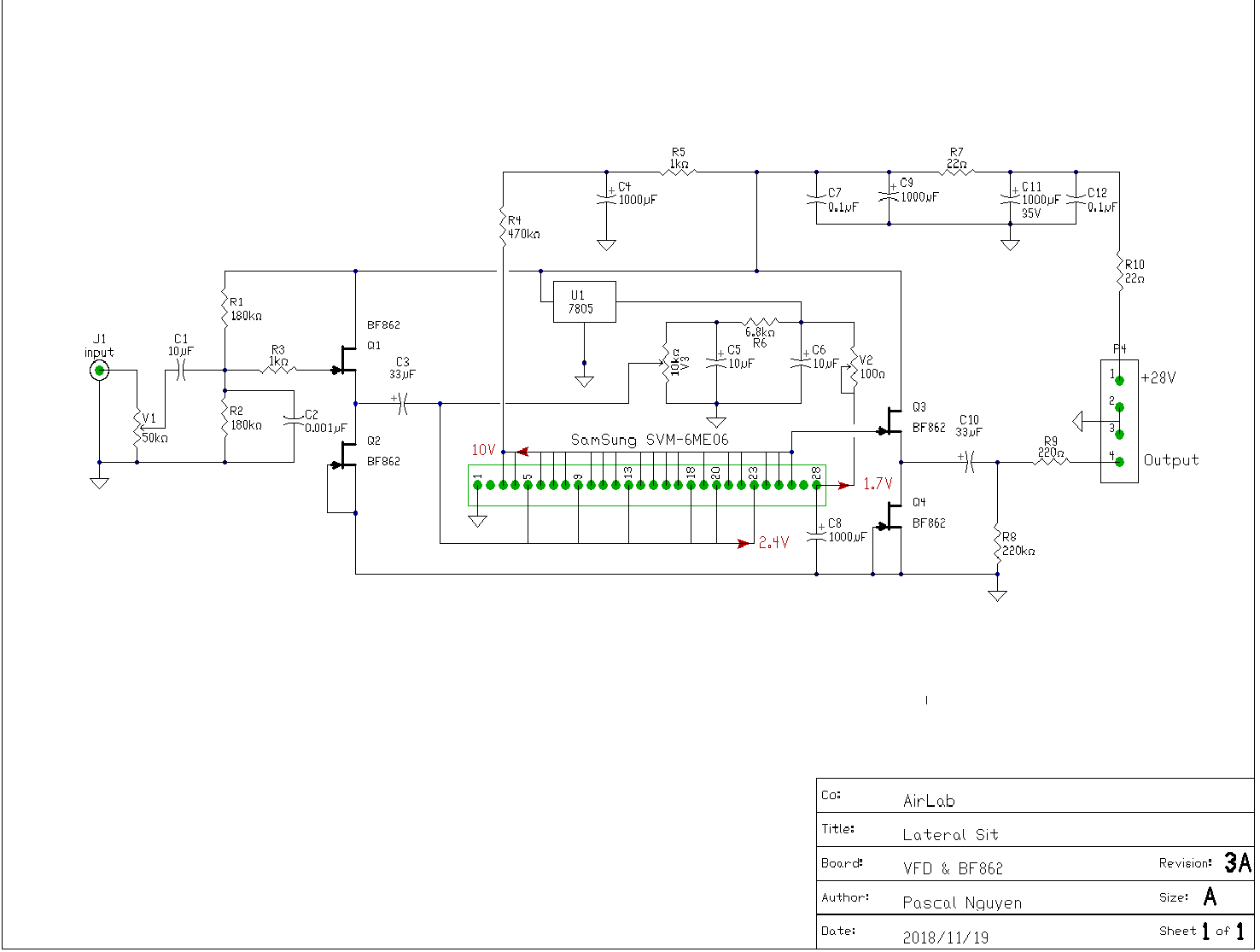

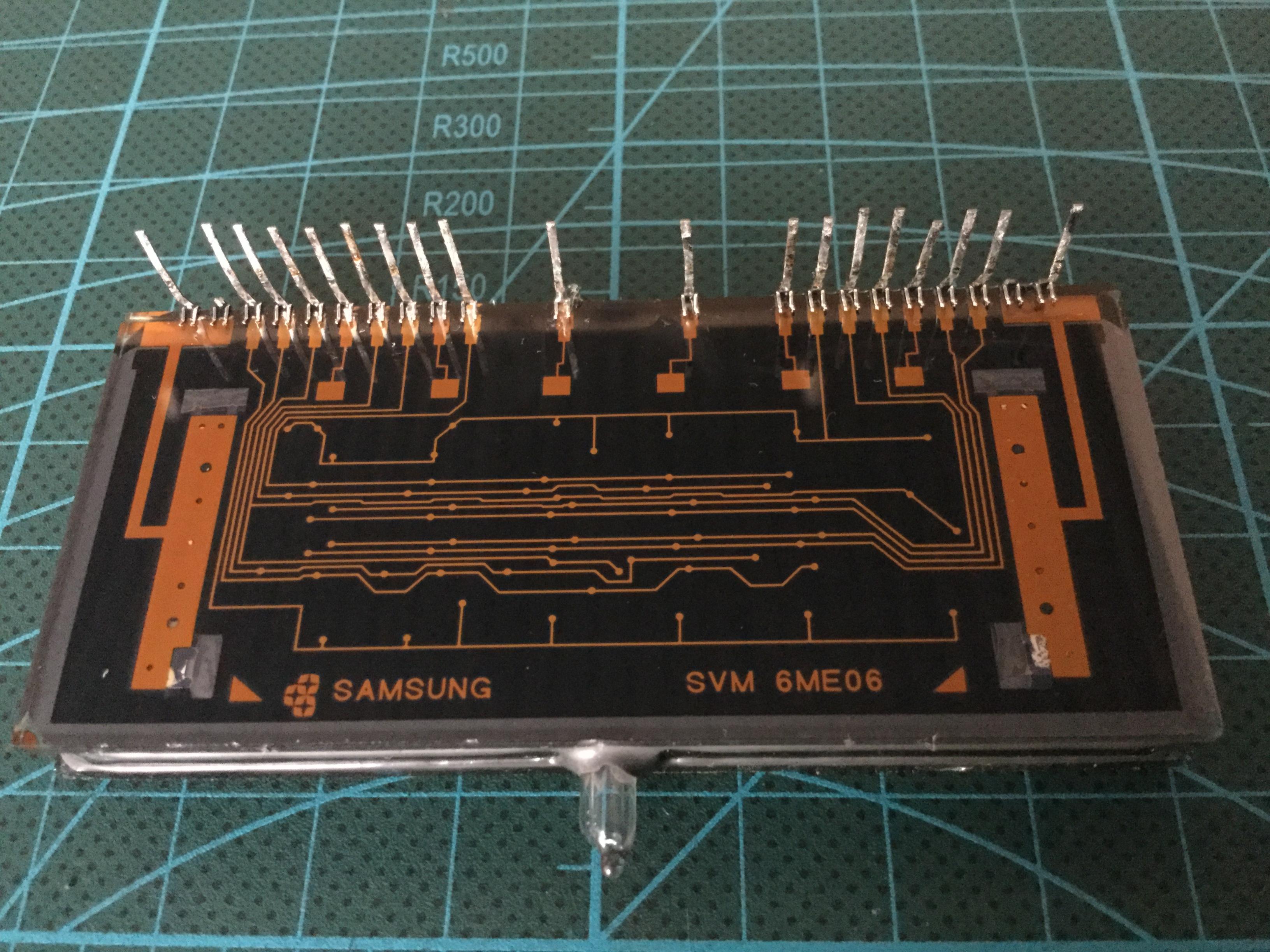

I remove the VFD out of the board, made by SamSung with printed diagram at the back of the display, will play with it when I am able to clean up my bench.

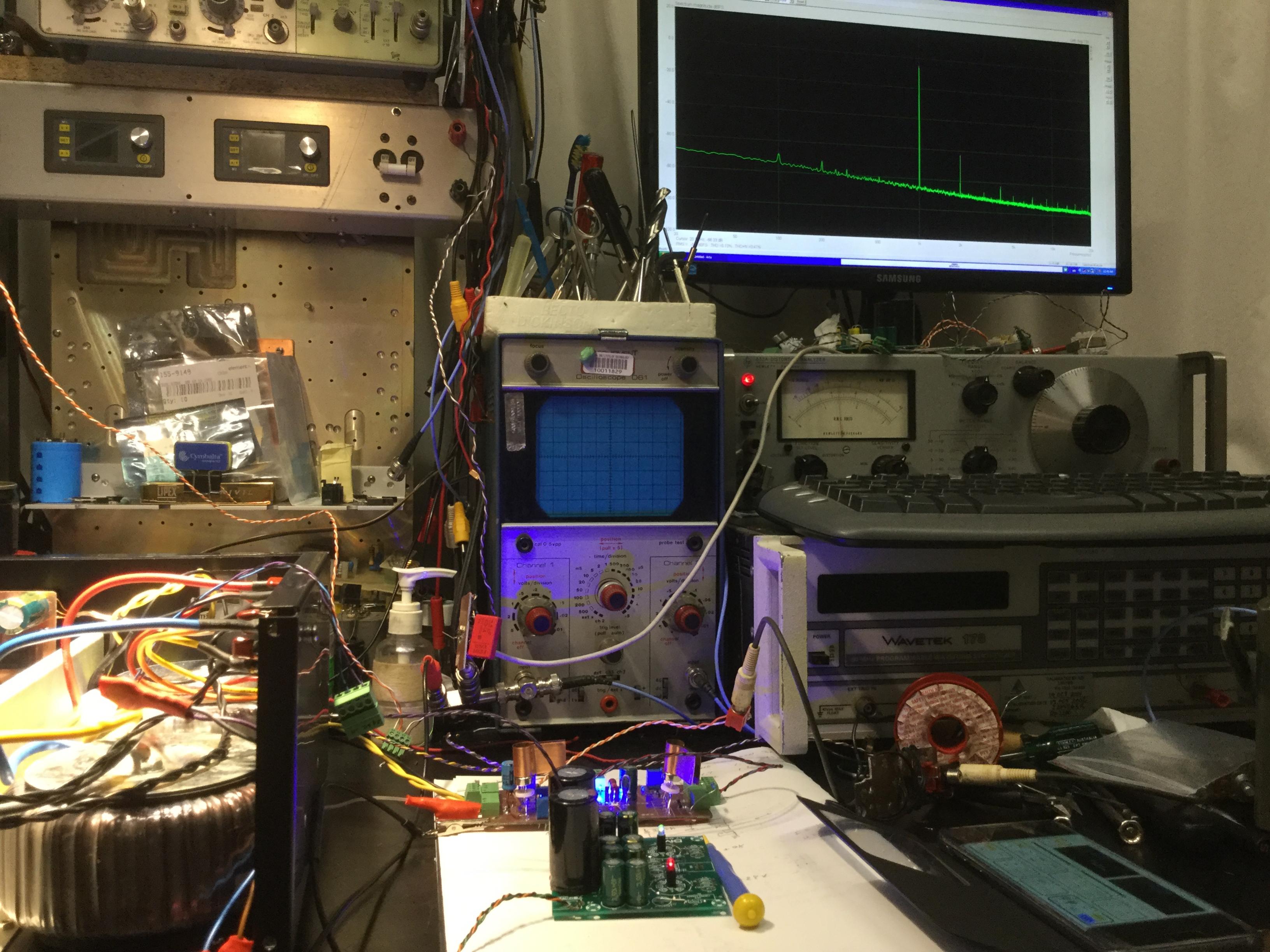

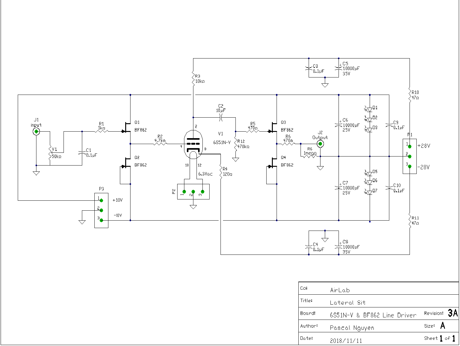

So far one channel of the line driver BF862 with 6C51H-B nuvistor has been done, I use two trimmer, one for plate current and one for grid biasing by varying cathode resistor, a non educated approach to tube design.
The result is very pleasing with a nice second harmonic on FFT SA.
Cheers

I remove the VFD out of the board, made by SamSung with printed diagram at the back...
Please correct to “ made by SamSung with printed circuit at the back”
Will try it as a Poor Man Korg Triode, at least only on fluorescent effect.

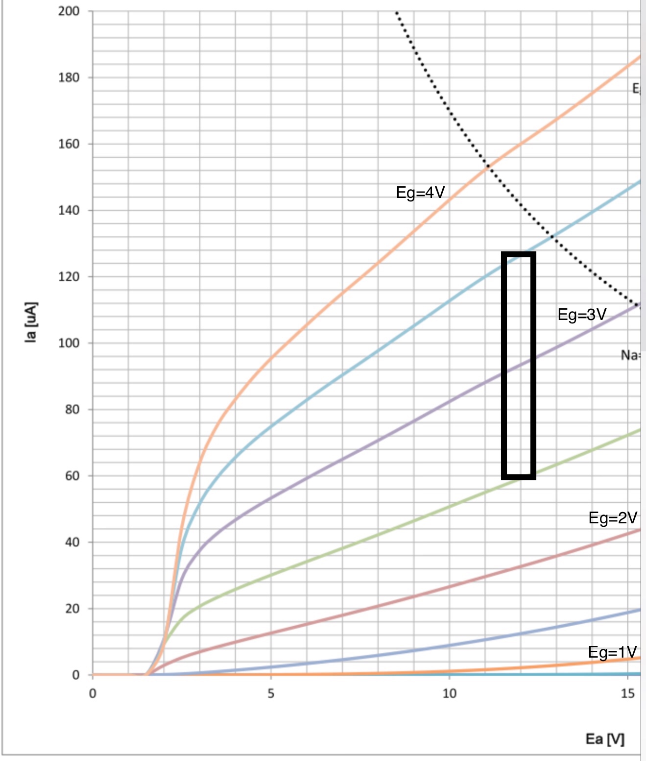

I am very interested in the Korg tube, not on the trendy of brand name and price tag, but on the positive voltage bias for the grid, I think this technique will open a door for me to play with starving tube (low anode voltage).

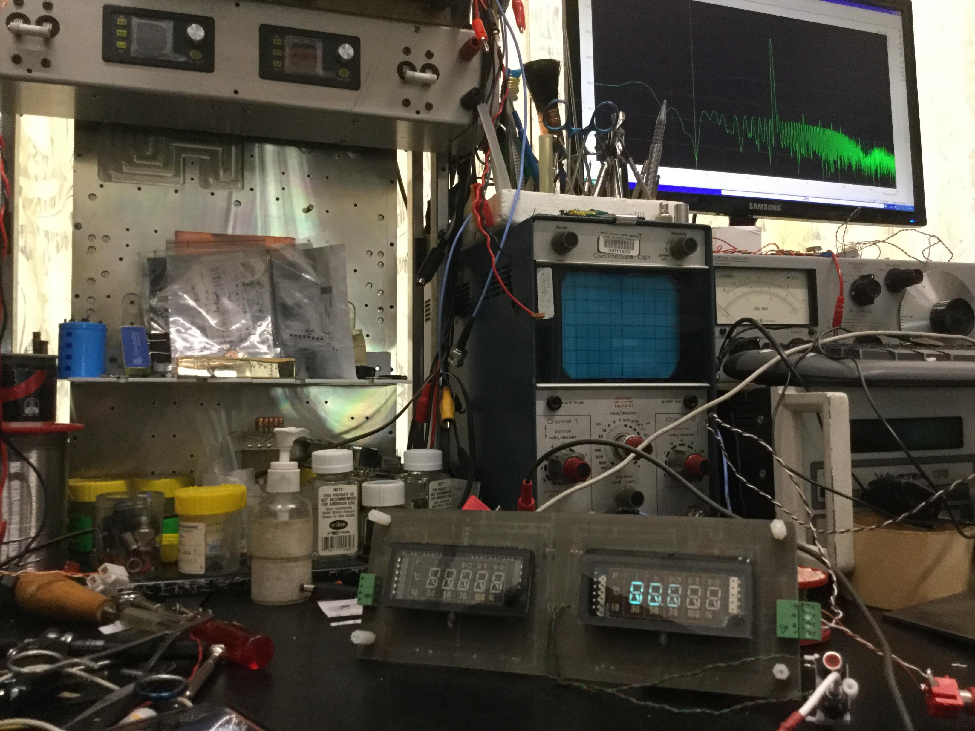

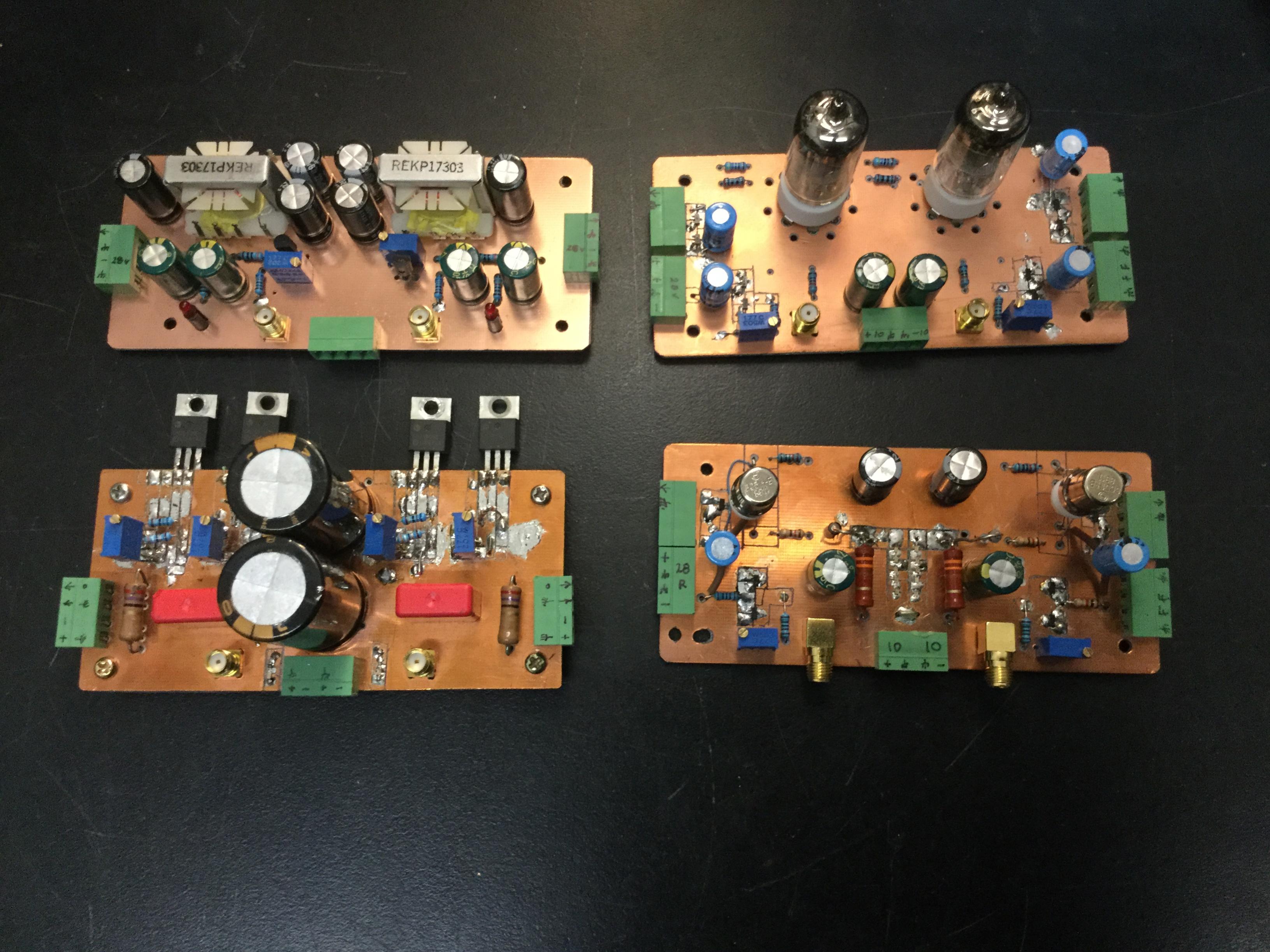

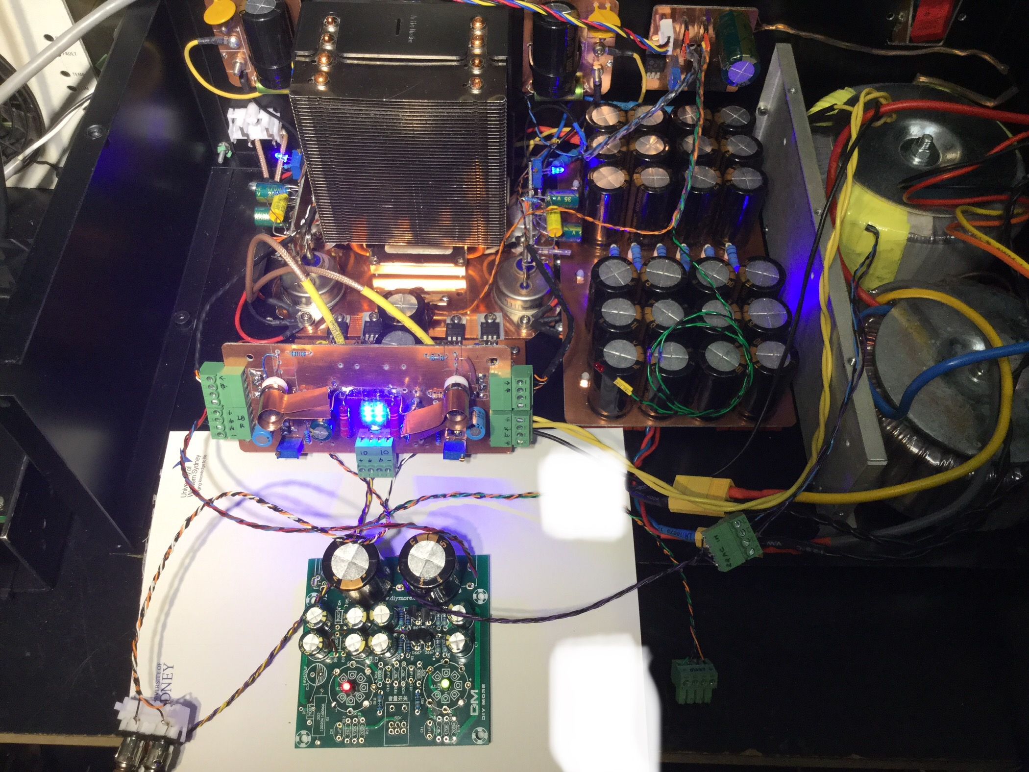

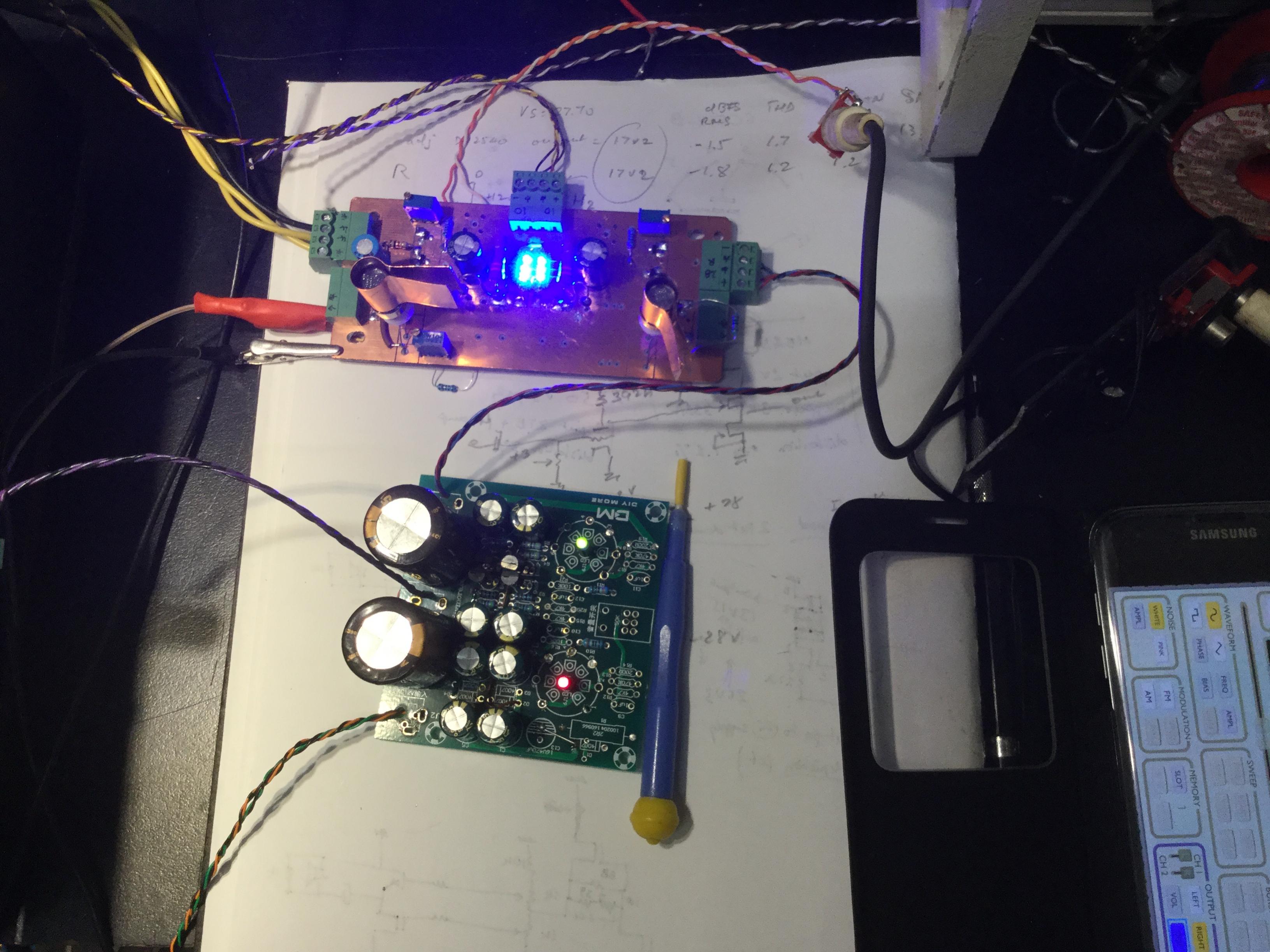

I finished my “poor man B1-Korg” preamp, with two VFD scored from a certain hamfest.
very poor result at first attempt, the spectrum showed a very high noise floor and 50Hz.
I tried to reduce the exposure to 50Hz by keeping only one grid actif, it yields much better result but still mediocre.
More works need to be done to optimise for best grid voltage and anode current.

I finished my “poor man B1-Korg” preamp, with two VFD scored from a certain hamfest....More works need to be done to optimise for best grid voltage and anode current.
B1 Triode was powered by smps but have external rcrcrc filtering in Papa psu circuit = very low noise floor.
Probably Nutube construction materials was optimised by Korg for audio if compare to regular VFD ?

Power supply filter from original B1Triode schematic is efficient against the smps noise
B1 with Korg Triode
Don't expect very low distorion numbers, was generaly recommended for amp's with 20dB of gain and H3 dominant character.

For a fine tuning without notch filter, one can use the Arta with an obsolete computer (don’t use your pc, sooner or later you will kill your soundcard).
Get to the minimum distortion, then back off to CW and CCW for your favourite H2 dosage, take notes of plate voltage (2 voltages, one for -H2 and one for +H2)
Inject some musics in and retune the bias to the plate voltage as noted, the nice sounding is the bias with Positive H2.

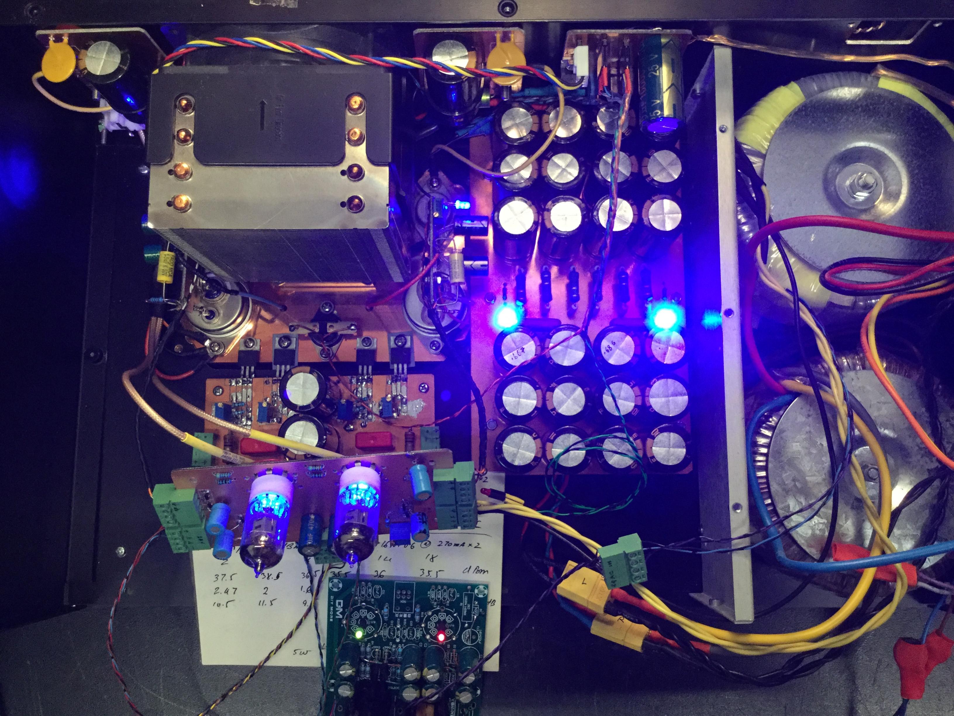

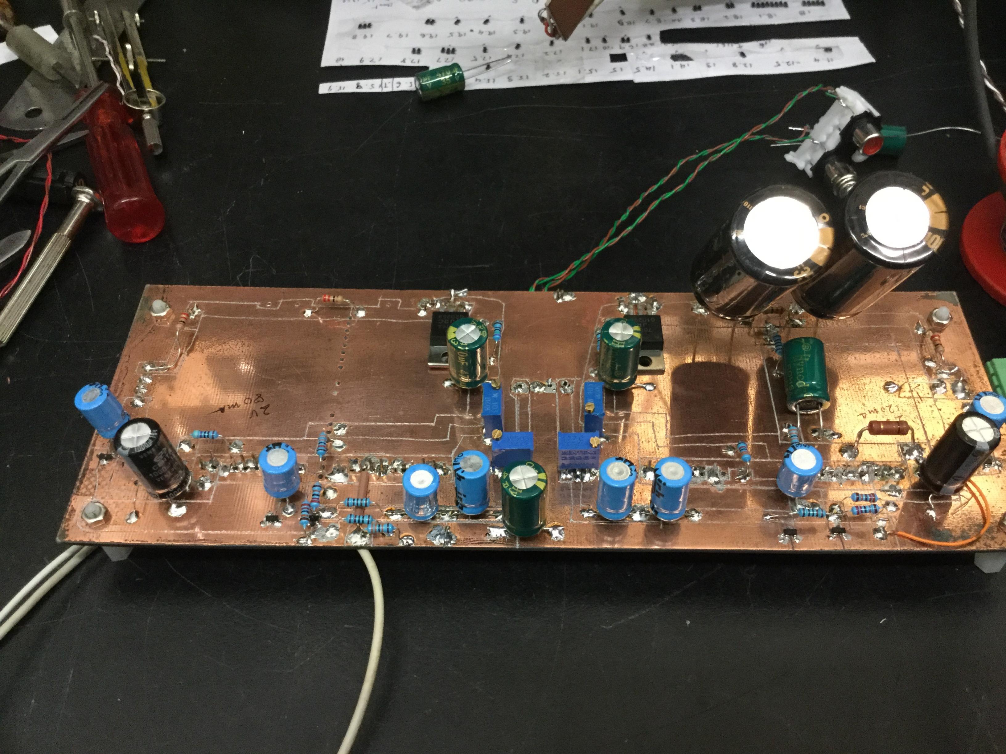

My project is nearly done, all four driver have been built and tested, the fifth VFD (sounds nice also) is waiting for some Russian Nixie tubes with very short filaments to replace the Samsung’s.
Cheers

Set both VFDs for same gain, one is brighter than the other!!!
Without any input, very close to speakers, I can hear the resonance, like some one strikes a gong few minutes ago.

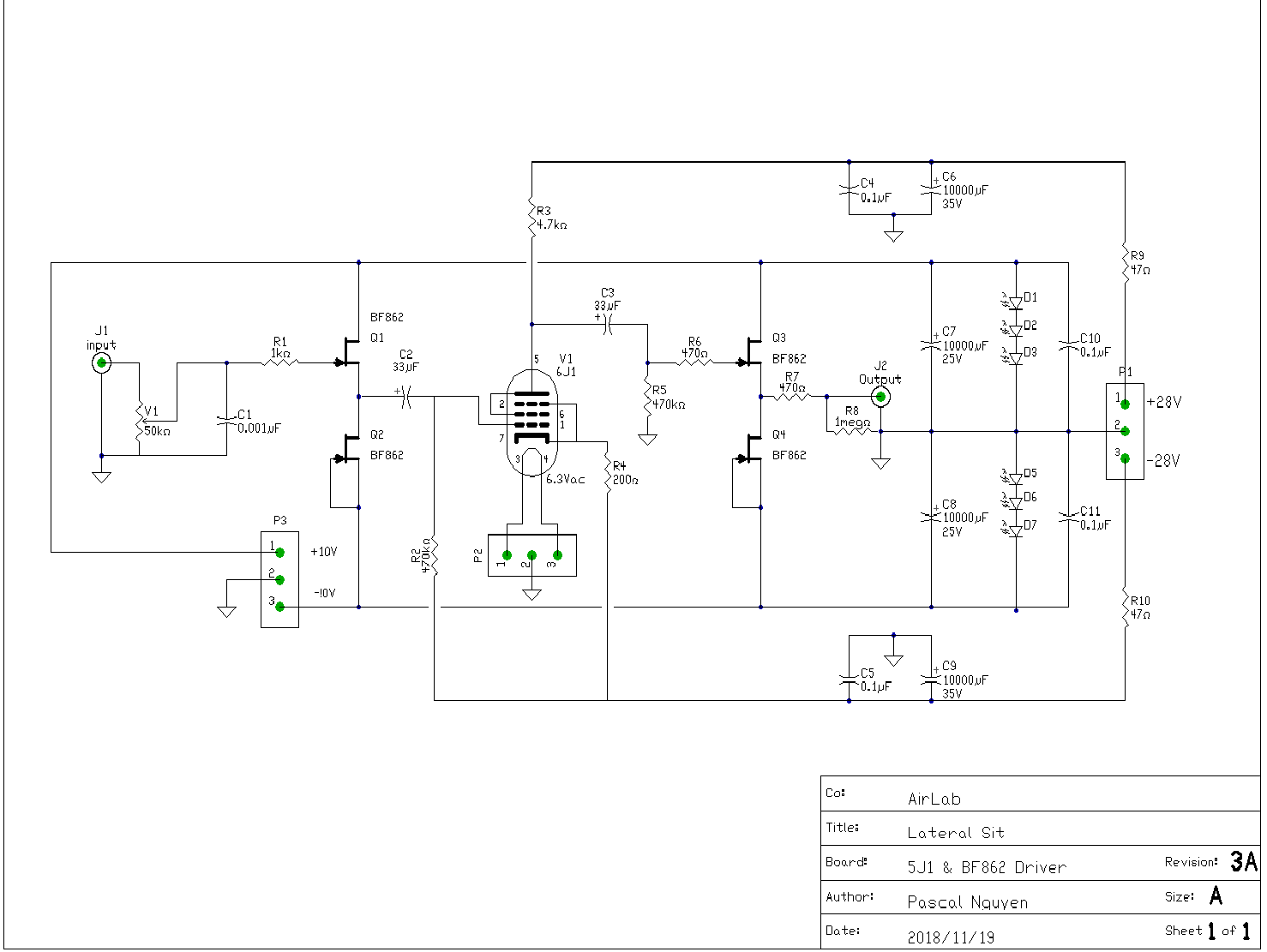

My 6J1 à la B1 is sounding really nice:
YouTube
Grid bias and plate current are exactly same from the eBay 6J1 preamp kit.
Only a minor modification at the power supply section had been performed by removing all steering diodes for voltage multiplication.

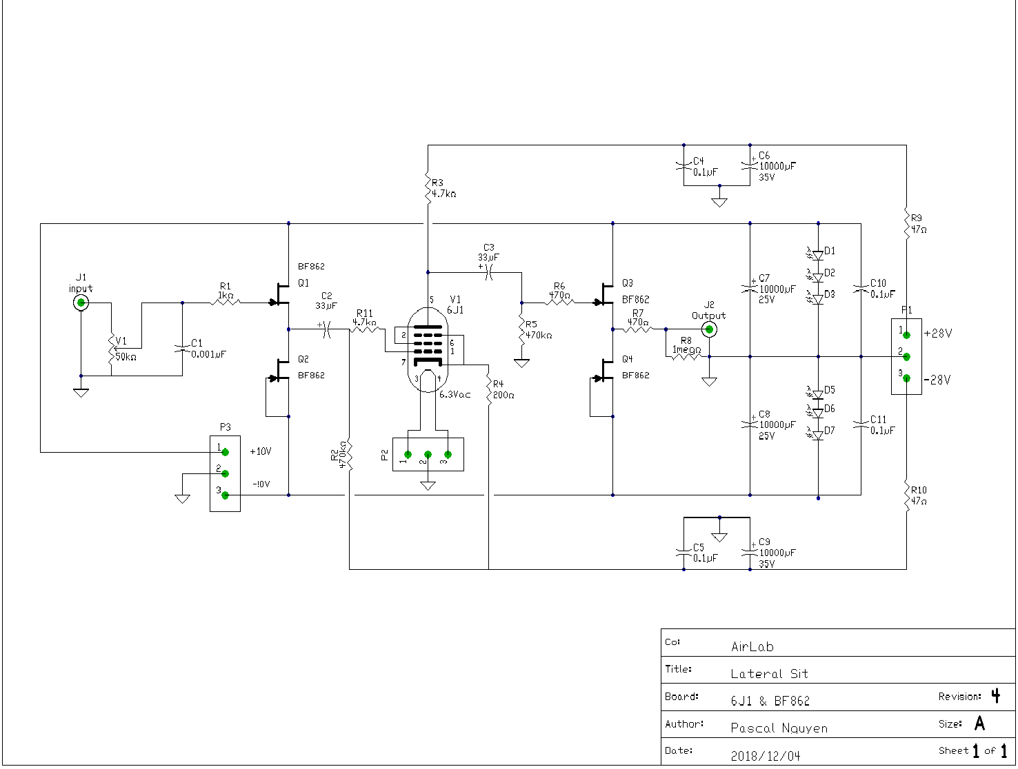

There is an error from my last schematic diagram of the 6j1 driver.
A grid resistor R11 has been amended.
Cheers
Hi, why the 33µF coupling cap? you can use one of fraction of this value without low pass effect 1µF is fine or 0.5µF. And this could be non polarized.
Also you can avoid the use of the first buffer. The amplification amount is <1, it has input high impedance, near the same of the valve.
Try to use a cascade buffer without cap between the stages.
Best Regards
Simply due to my availability of having many 33µF capacitors at the time of breadboarding.
Fc (33µF — 4.7kOhm) = 1 Hz
That value was noted and used in my drawing.
Having only low impedance sources (Android phone), I do need a buffer interface to avoid impedance mismatch.
Will do some more reading to build a direct coupling between stages without capacitor.
My appreciation for your comments
Kind regards

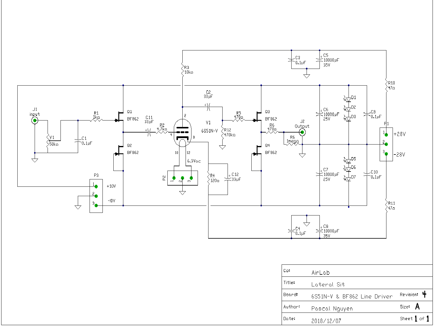

With Love From Russia, Nuvistor 6S51N-V
From our forum, a mixed bag about 6S51N-V performances hit my search.
Stubbornly I placed an order of 20 nuvistors from Russia, to play with my LateSit.
Quite nice sounding
YouTube
A coupling capacitor C11 is missing from my last drawing, another one C12 is amended to cathode resistor for AC bypassing.
Please change C1 value to 0.01uF or omitting this cap, I need it for avoid RF breaking in due to a kW transmitter is in proximity.
Cheers
