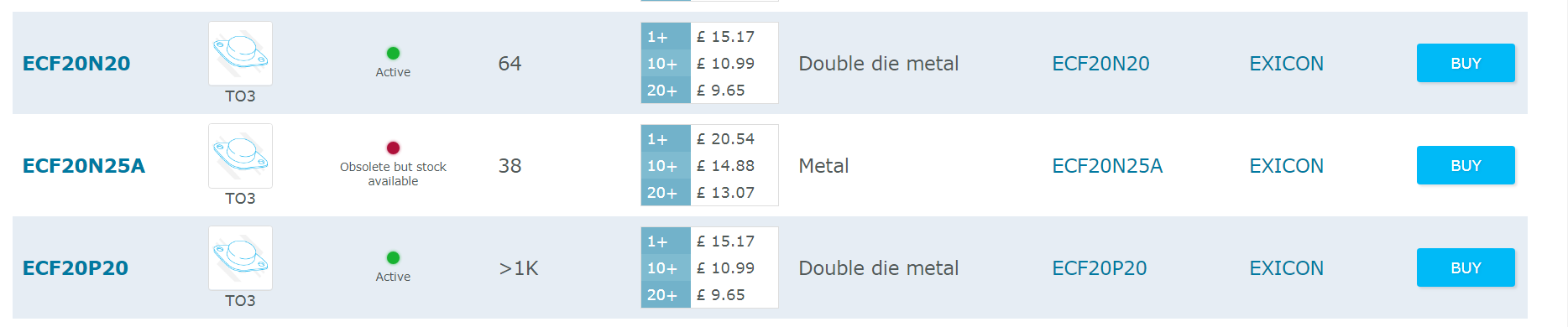

As I understand, the OP wants to use TO3 parts because the chassis already has provision for mounting them. That makes sense, rather than hacking the heatsink about, unless absolutely necessary.
The problem is that whilst Lateral mosfets are a sure-fire and simply applied device, the metal can varieties are close to un-obtanium presently. There was yet another thread here only week or so ago, moaning about general scarcity of lateral mosfets - check the recent threads if interested in the suggestions but I don't think you'll find much stock of genuine TO3 parts presently, let alone the double-die varieties.

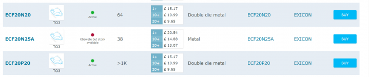

From the current Profusion site. Ordering shortly!

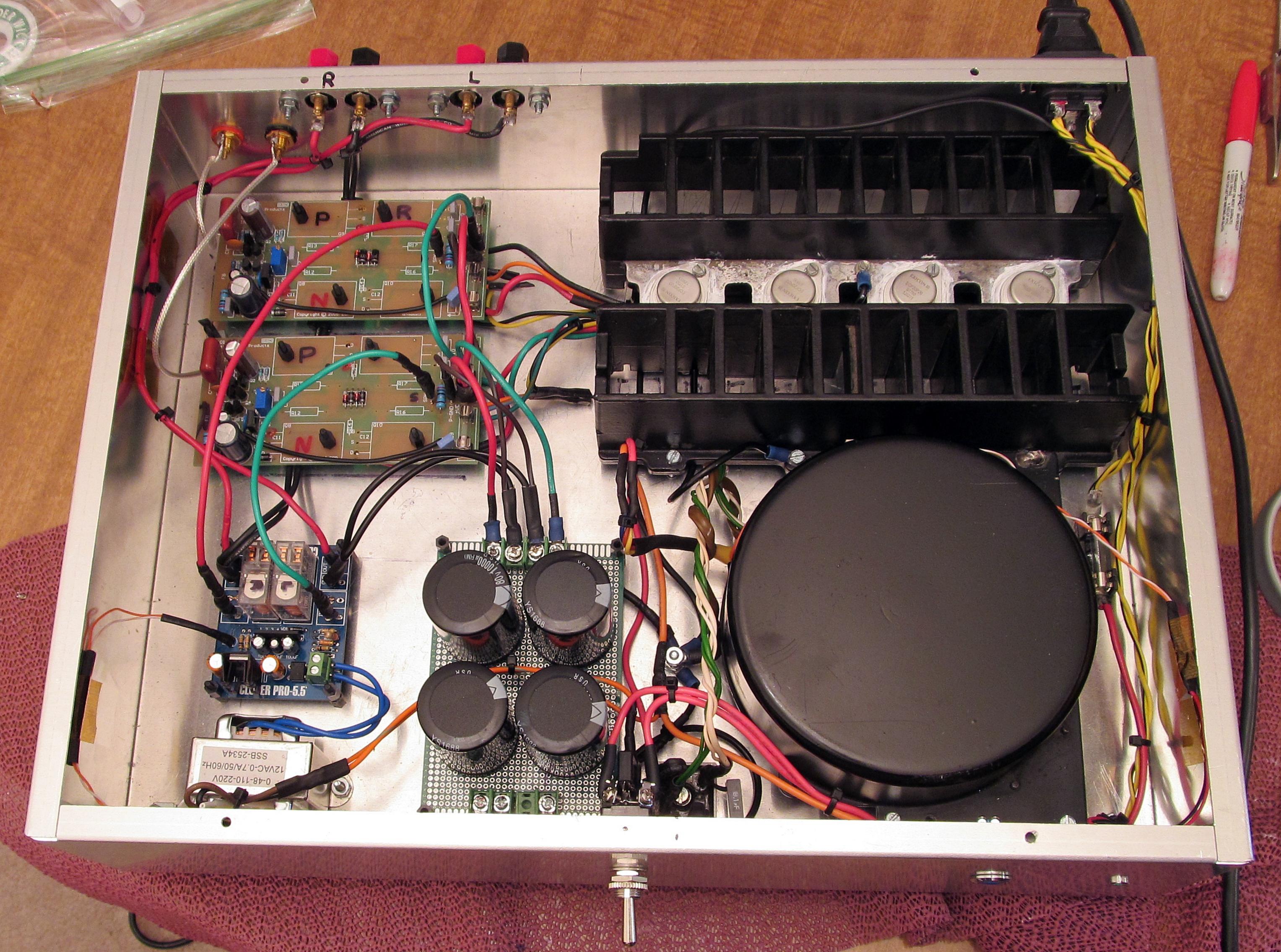

Tandberg P101 Progress

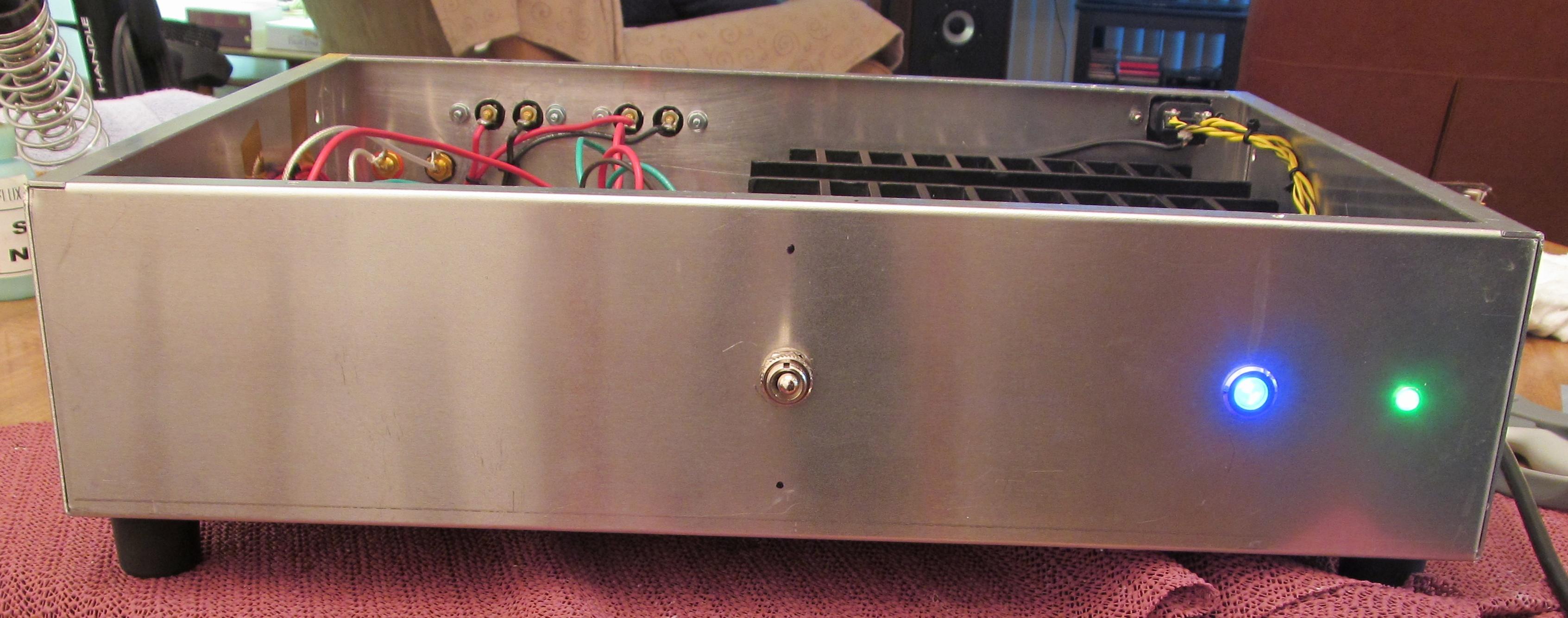

ESP P101 amp built from Tandberg 3012 transformer and heat sink assembly.
Barely Luke warm with 30mA bias. Sound is exceptionally clean.
Power light with standby and on condition. Light for speaker relay status.
Need to clean up the wiring a bit. More to come.

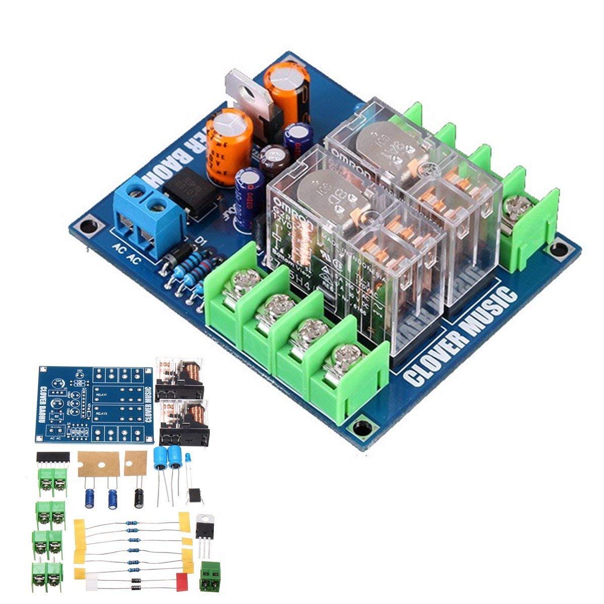

P101 Build Relay Contact Issue
So I purchased and installed the pictured Ebay (Chinese) speaker Relay assembly with Omron G2R-2 relays. Dual relay contacts ea. rated at 5A or 10A per channel. The problem did not shown up due to high output failure but low level test tone level tests especially in the 80-100 Hz range. The sound became raspy and distorted like a dirty preamp monitor switch (both channels). If I turned up the volume, the symptoms cleared up. I verified that it was the relay contacts when I bypassed the relays with clip leads. Clean output.
Not sure if this is common issue with relays and low levels or if they are just faulty. Looking into other boards or options. Replace the current Omron relays or go with a different relay board with beefier relays?

Relay contacts certainly give problems with low level audio but that's after many years, due to contamination from accumulated arcing debris, airborne dust, sulphation from automotive and industrial pollution etc. For new relays to have this problem, it says fake or bad quality control to me. G2R relays have been very popular for decades but they've been assembled in China and elsewhere in SE Asia for many years now and many design details have changed significantly. What you get now isn't the same as the original type used in so many high quality Japanese amplifiers up to 20 or so years ago.
The relays need to have a a high DC contact rating, at least 30V, to reduce the chance of the contacts welding together or suffering arcing damage when they try to open under a fault condition. Many cheap relays I've seen in recent times are obviously not suitable because the clearance and spring force isn't sufficient but we buy on price and low-res pics from Ebay stores which isn't a good way to buy anything that needs to perform reliably for safety, just sayin'.

I did the contact cleaning procedure with glossy print paper and Caig Deoxit and has seemed to work. I still plan on ordering some Omron relays from Digikey or Mouser as backups.

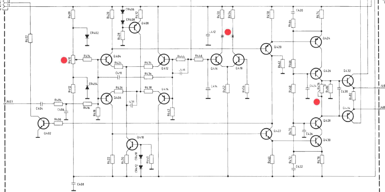

Just a curious note about complexity vs simple design. Here is the original drive circuit for the Tandberg 3012A driving a pair of mosfets per ch. (57V Rails, 2sK175 and2sJ55).

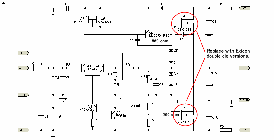

The second pic is obviously The P101 schematic.
I’ve resorted to double dies due to high rail V+/- and Tandberg thought 8A 100V devices could be adequate. The Tandberg power amp. section never failed in the 20+ years I used it. Switches and preamp section were its demise.
Final Notes on The P101

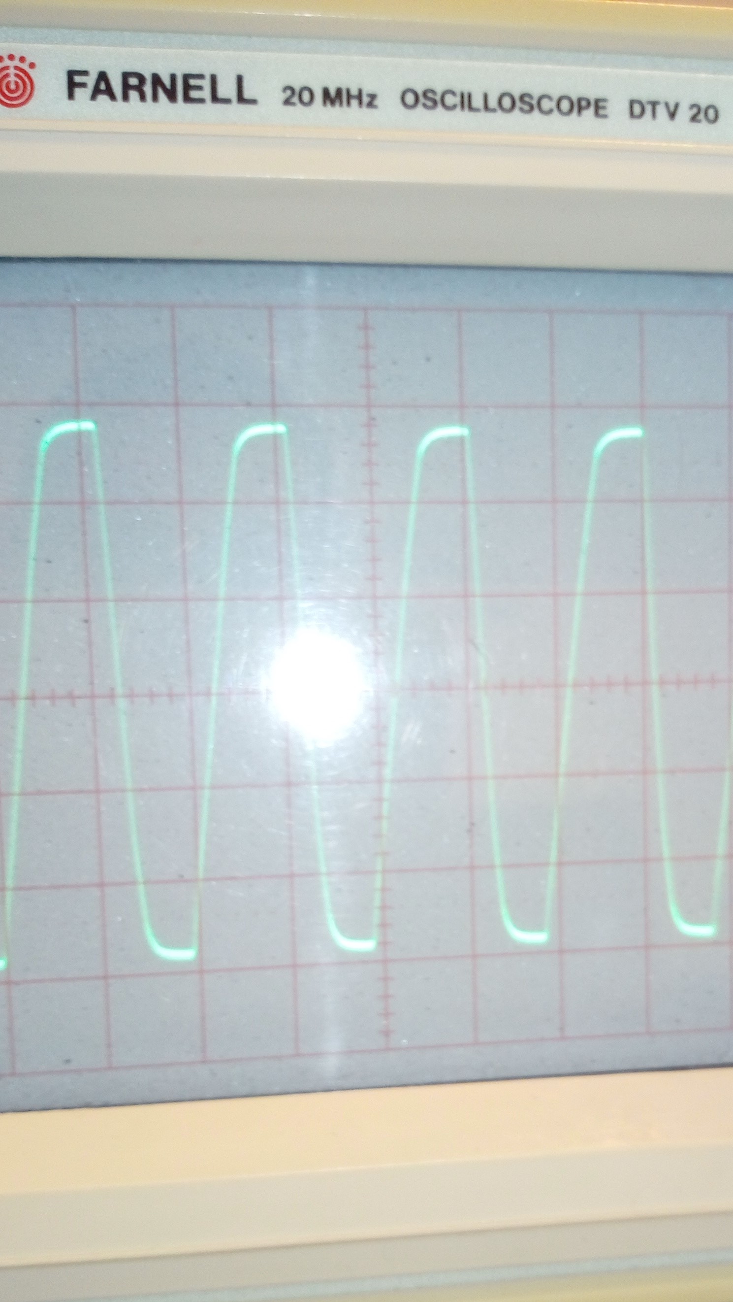

Reset the bias to 50 mA. No detectable difference in sound or temp rise to heatsinks at idle. DC balance below 5 mV either channel. Looking at the output on the scope (loaded 8 Ohm and unloaded) it looks good all the way up to 20KHz. No oscillations. I was a little concerned due the fact that the outputs are hard wired off the PCB.
I just upgraded my speakers to the Bryston Mini T's. This amp. drives them cleanly and with authority. Subjectively... no perceptive difference between the P101 and my retired Bryston 3bst. Very satisfied!

Also 560 ohms gate resistors with double die is an unusual high value.
