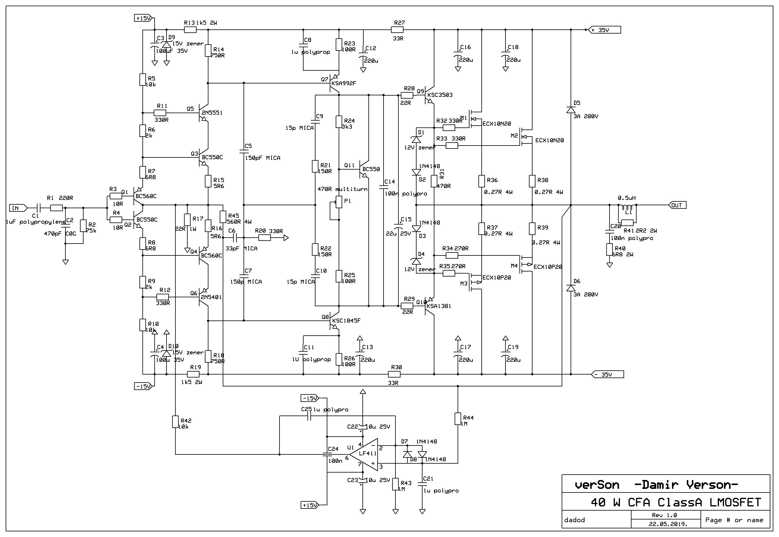

According to the BOM from post#1, shouldn't R45 =550R(560)/8W be made of 4 resistors with 560R/2W . The layout shows two parallel resistors in series and the BOM says this should be done by 4x1,1k /2W resistors.
Günni
Yes, you are correct. For ClassB there should be four 560R 2W resistors and for ClassA two of 1k1 2W resistors are enough, but if you want to combine ClassA and ClassB in the same amp (like active speakers) then use four 560R resistor even for ClassA.
I will edit BOM accordingly and will put correction note in first post.

1. How much phase shift at 20 kHz, at 1 watt.
2. Can you make a THD+N graph like this? Rotel A11.

1. Less then 1 degree and it depends of input LP filter.
2. No
Only one degree is a very good value!
I already assumed it, but I had to ask. For the graph you have to build the amplifier and, depending on its construction, PSU, components and ability, it will change.
Thank you.
Thank you.

Hello Damir,
what transformer do you recommend for a class A 40W mono block? 2x24V AC with xxxVA?
BR
Günni
