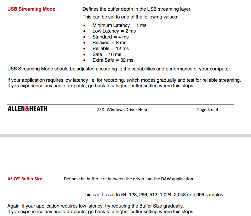

I'm just guessing too, but if you are hearing obvious latency it might be a USB Streaming mode issue:I suspect it's like in everything else: most people don't use Linux at home, it would be alien and disorienting for them. But some - like myself - do it exclusively their whole life, and there is nothing more natural.
Both of my kids manage their rather extensive gaming setups in Linux, and I imagine that DAW stuff is not much more complicated, nor the musicians less capable, at least some of them.
But I really don't know, just guessing.
Safe = 16 ms
Extra Safe = 32 ms
That's getting near slapback echo territory, 31ms is a 1/64th note at 120 BPM.
http://www.allen-heath.com/media/ZEDi-USB-Windows-Driver-Help-Manual-1.pdf
Hope the problem fix is that simple!
Hope it is too! With any luck, the linux driver for the desk has the same settings / options.Hope the problem fix is that simple!

I did, last weekend but did not have enough time to really get an idea. I found the setting for the bufer size, and I think the smaller buffer size made it sound near-perfect but I got distracted by something else, will have to do a better test in the next few days.Have you played with buffer size since then?
I did more experimentation with the Ardour 6 running within the Ubuntu Studio Linux install, and the buffer size 128 is the lowest I was able to get to work well. The latency is either not there or small enough to not bother me so far. Interestingly, stepping another factor of two down to buffer size 64 turns the sound into a completely distorted garble. I wonder if I could upgrade the driver or something to push it further, or this is a hard limit for my setup.
