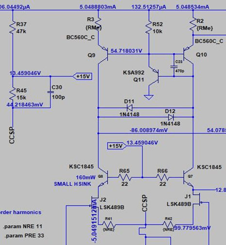

TEST:
In my prototype, the base of the positive follower Q19 was connected to the sources of the NJfets and the base of the negative follower Q20 was connected to the sources of the PJfets…. While this method works, there is always a small current diverted from the Jfet sources to the follower’s bases and due to NPN PNP differences, it is very difficult to stabilize the Vds on both NJfets and PJfets.
I hope this new method gathers enough interest to produce a fruitful discussion on how to best “drive” both cascodes simultaneously.
