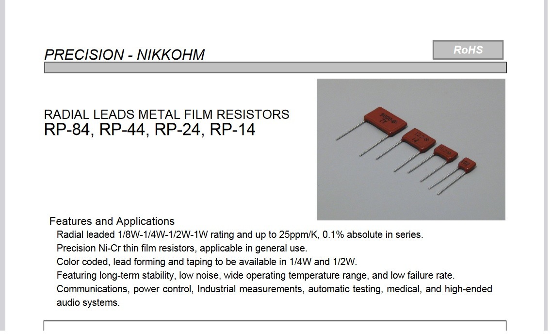

S soundslave Member Joined 2010 2024-03-14 8:02 am #1 2024-03-14 8:02 am #1 I found these in a B2 amp that I’m playing with can anyone ID them? Not your average package for sure. Attachments IMG_2216.jpeg 402.8 KB · Views: 127 pinholer Member Joined 2010 Paid Member 2024-03-14 3:49 pm #2 2024-03-14 3:49 pm #2 Nikkohm makes resistors that are shaped like that. Not sure if those are Nikkohms, though. Elvee Member Joined 2006 2024-03-14 5:02 pm #3 2024-03-14 5:02 pm #3 They are run-of-the-mill carbon film Reactions: rayma S soundslave Member Joined 2010 2024-03-14 5:26 pm #4 2024-03-14 5:26 pm #4 The 680 ohm and the 3.3k ohm radials are the ones in question Elvee Member Joined 2006 2024-03-14 8:06 pm #5 2024-03-14 8:06 pm #5 I mistook them for capacitors; they are either thick or thin film devices; probably thin film or plain metal foil since they have standardized values Reactions: AllenB pinholer Member Joined 2010 Paid Member 2024-03-14 8:38 pm #6 2024-03-14 8:38 pm #6 Nikkohm makes these thin film resistors. Attachments Nikkohm.jpg 117.2 KB · Views: 53 You must log in or register to reply here. Share: Facebook X (Twitter) LinkedIn Reddit Pinterest Tumblr WhatsApp Email Link
