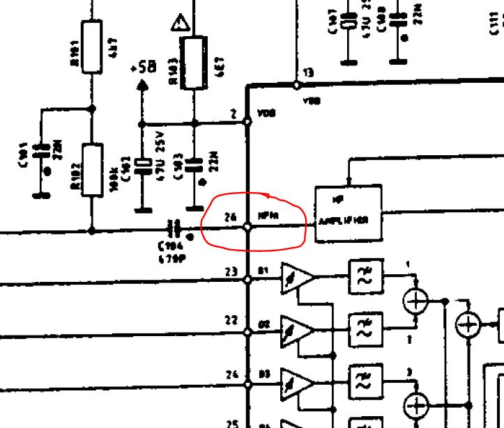

Unfortunately and without detailed tests its impossible to say what might be occurring. You need to look at the recovered RF signal from the pickup RF amplifier as a first step and see whether its clean and of the correct amplitude and also that it is free from jitter and 'bounce'.
That is exactly the info I would find in the service manual..but that info is lacking in the ones I found online. Any idea how to check this without the service manual?
You would have to scope around the RF signal stages. The manual I saw is very poor as well but it looks as though it is pin 24 (is it, or is it 26) of U101
I'm not so sure I would condemn the laser yet.
Did you replace all the electrolytics under the laser (on the servo board) ? In post #1 you mention the problem seemed worse after recapping. It might be worth checking your work/values/polarity of the replacements.
