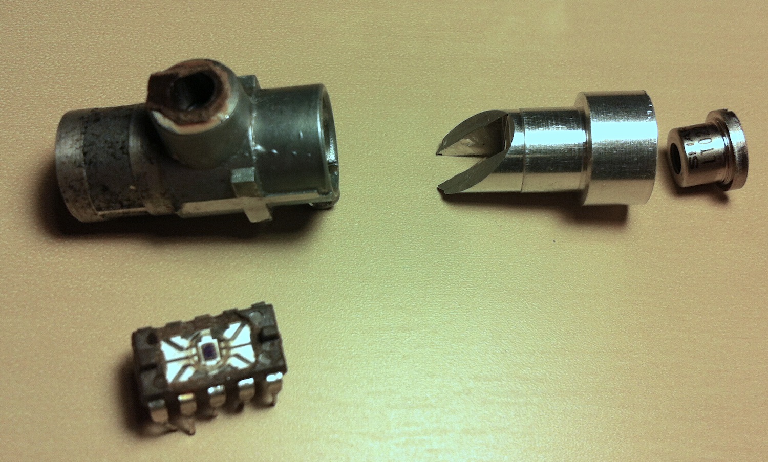

First of all, the diode used is a Sharp LT022MC, same diode as being used
in early Sony mechs.

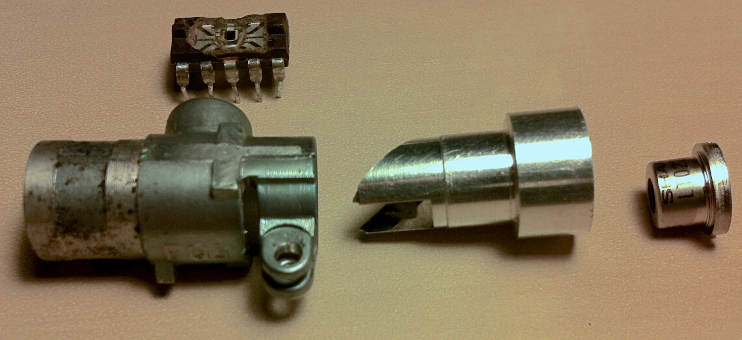

A friend sent me a disassembled laser tube.
I will measure it and put the data into my CAD program.
As he stated, it was not easy to remove the diode. It seems to sit stiff
in the housing and he had to remove (and accidentally destroy) the
prism above the laser and the diode´s window. Also Looks like the quarter photodiode receiver can´t be removed without breaking it.
What strikes me is the fact that the laser diode sits in the tube without play.
It is said that not two diodes (i.e. the placement of the emitting silicon in the housing) are the same. Angle in a clockwise manner might play a role because
of astigmatism. Nevertheless, if a diode is worn out, replacement might be easier than with Sony players which have a diffraction grating.See also this thread:

Here are images of the CDM-1 laser pins. Check also this link in German:

Hello. I don't have any experience on these Philips players. But, seeing the pictures, is a thing very clear: Don't remove the photodiode array from the aluminium piece.
Hi Mike P. Can you publish any picture or the laser diode placed?
