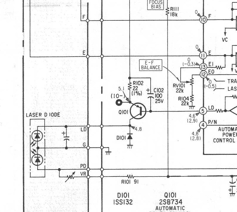

laser diode in KSS190a
I have a Sony CDP 337 ESD and need information about the KSS190a l aser-pickup.
What laser diode has the KSS190a? (see attachment KSS190 schematic)
It is the same diode like the KSS151 of the Sony CDP508?
Have anybody a schematic of the CDP 508 so I can compare the pickup schematic.

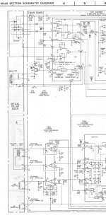

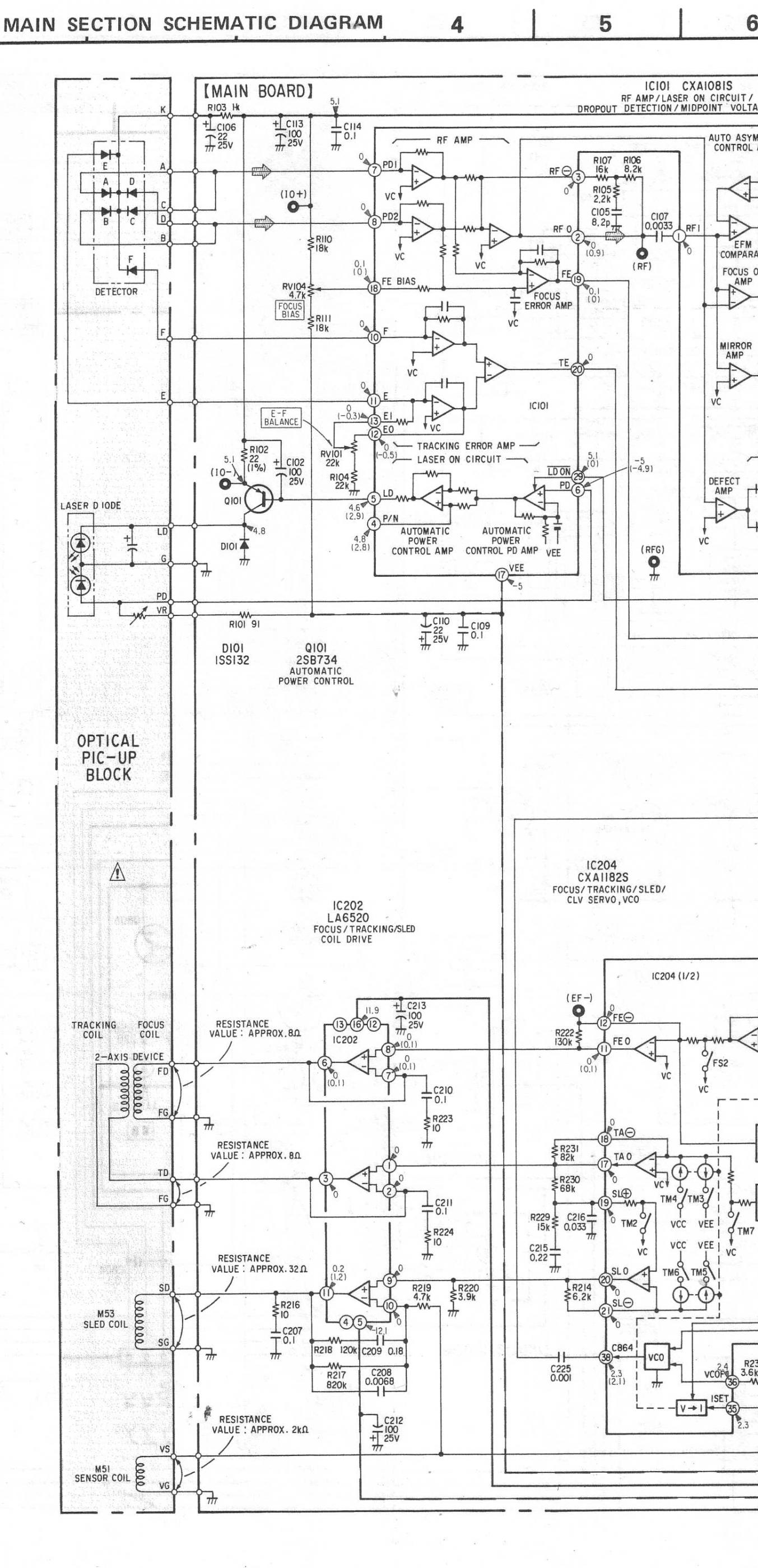

better schematic of the laser diode in KSS190a
have anybody a schematic of the KSS150A and or KSS210A and or KSS213C

The Schematic of the diode from KSS150A is according the datasheet from first link by post #1. This means, this diode isn't suited for the KSS-190A.
