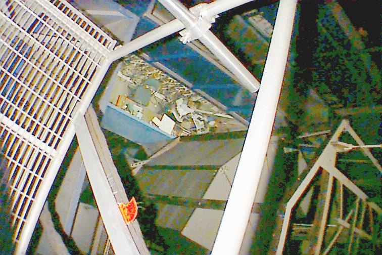

In the 1990s I worked as an engineer and occasionally field engineer for Sony Broadcast & Professional. I was fortunate to be assigned to the team refurbishing the 4-screen Jumbotron at Reunion Arena, home of the Dallas Stars*.
That thing was big enough to park 4 small cars inside and had a floor around the backside of the panels which included the video displays and large scoreboards. In the center was a hole. The main PA speakers hung from the ceiling by a winch system and were stowed inside the thing. They were lowered well below the display during games.
The speakers, 8 of them, covering 360 degrees. They were easily 6 FT wide and 12 FT tall. This was not a bunch of PA horns but huge boxes with cone drivers suplemented by multicellular horns. IIRC the power was 4 or 6 KW. I never saw the amplifiers, just the speakers.

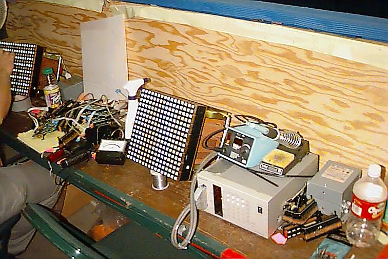

* At the time, that display was quite old and the little CRTs used as pixels were no longer made, and in short supply. For one last season the team wanted it repaired and the best screen facing the reporters' (and rich folks') boxes. We tested, repaired, and calibrated all of those things, and consuming the remaining global supply of NOS and good used pixel CRTs, fixed the display. It took several months. Each display was 12x16 FT and made of 192 modules 1x1 FT, each having 16 approx. 1x3", 3-color CRTs composing 3 or 4 pixels. Strange and very cool little tubes, ran on only 900V, a few are still around.
Very bad images of this are here:

The camera was a Kodak DC40, just about the first ever consumer digital camera. It stored 48 756x504 images and used a CCD. So don't be too harsh..
