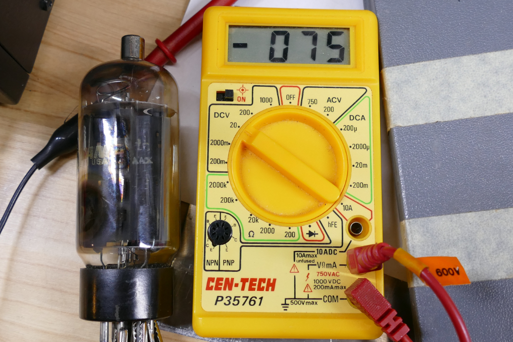

Here is a simple test. I took a good 26LW6 tube from my UNSET amp, connected the heater to a power supply set at 26 volts.
I connected a $4 meter from cathode to G1. The meter reads about 1.5 volts.
I swap the tube for a well worn and slightly gassy tube, and the meter reads 750 mV.

Interesting post George
