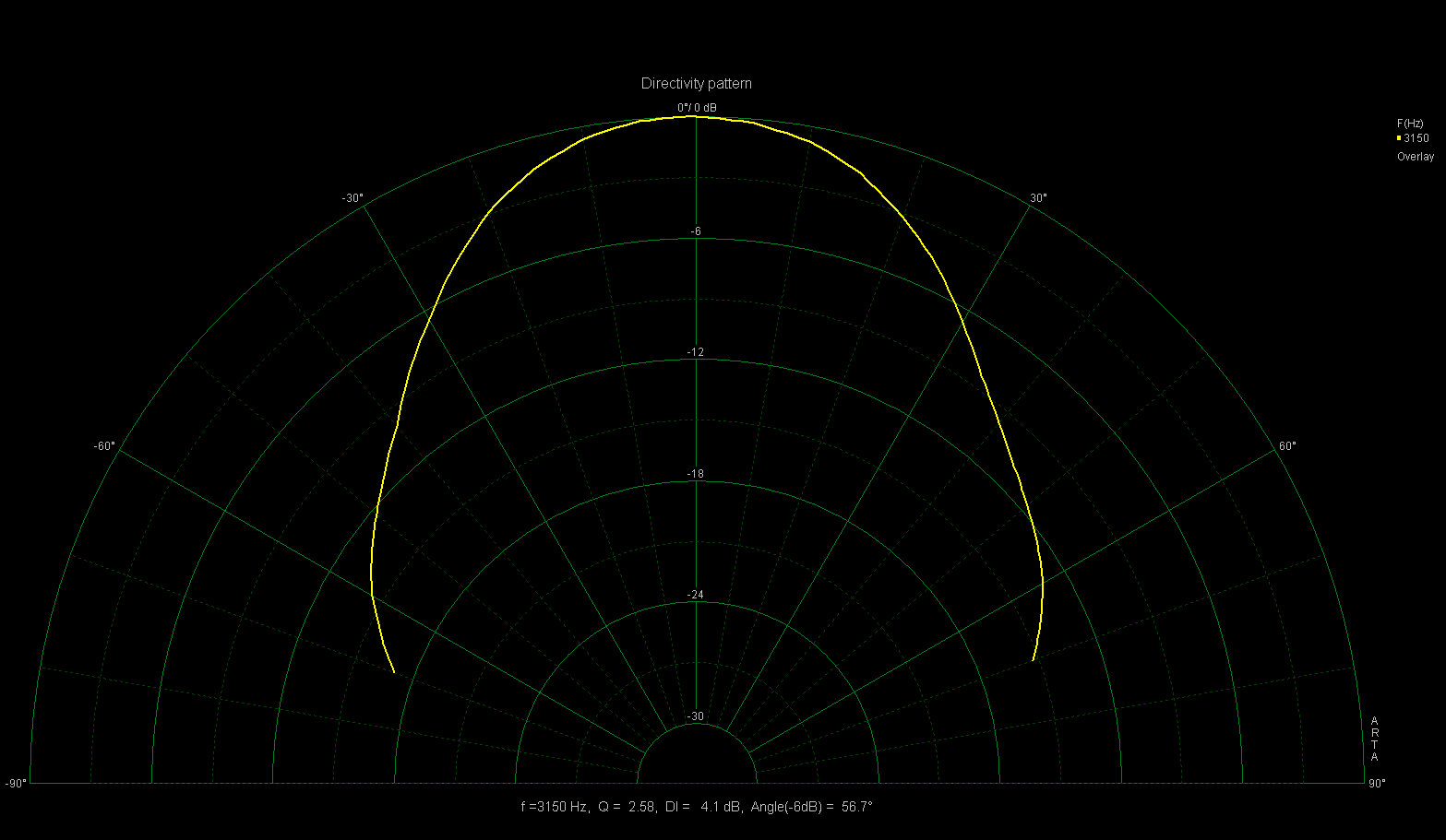

I took some actual polar measurements of one of my 8" full range drivers for another thread recently, which I've attached below, for 1Khz, 2Khz, and 3.1Khz. How do these individual measurements compare with everyone's preconceived notions of how directional an 8" driver is ? Perhaps not quite as narrow as people expected ?
Depending on how much you're willing to let the pattern narrow you could easily cross it over at 2Khz, or even 3Khz at a pinch. What you cross it over to affects how high you can cross it as well, as mentioned already in the thread.
If you were crossing it over to a really wide dispersion dome, you probably wouldn't want to cross it any higher than 2Khz, (although 2Khz disqualifies it as covering "midrange" for me) or 3Khz at a stretch, but if you cross it over to a wave-guide controlled driver such as a small horn or ribbon, the directivity discontinuity becomes far less, and you can go a bit higher.

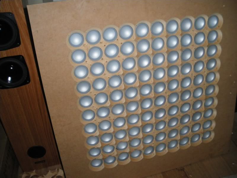

and here is midrange driver that - quite against laws of physics 😉 - has advantages of small and large, in fact extremely large - effortless dynamics and power handling, low non-linear distortions, low energy storage
Mms around 2g or so and Sd around 2000 or so 😀
extremely high directivity though - so for fans of total direct sound only 😀 OTOH we are told by experts that it is objectively wise to take the room out of the sound equation, so no problem really
^ I think too much directivity is not good. You have spot in your seat or sound changes too much ---> not natural to listen to. Studio recordings that have very little their own ambience benefits of some room interaction.
Do you think your Mms is 2 grams (that makes 2000 cm^2 of SD)?
well, this is also my opinion exactly but some differ and prefer it this way and I think that such an array is best available solution for those people
actually typically it's Mms of about 1g and Sd of about 1300 cm2 for such a driver
2g times 100 drivers, ~13cm^2 times 100
200g and 1300cm^2...
sorry but not really - this is not math - this is physics
...You see, the cones are not glued together form one big heavy cone...
such an array is just... magic 😉
