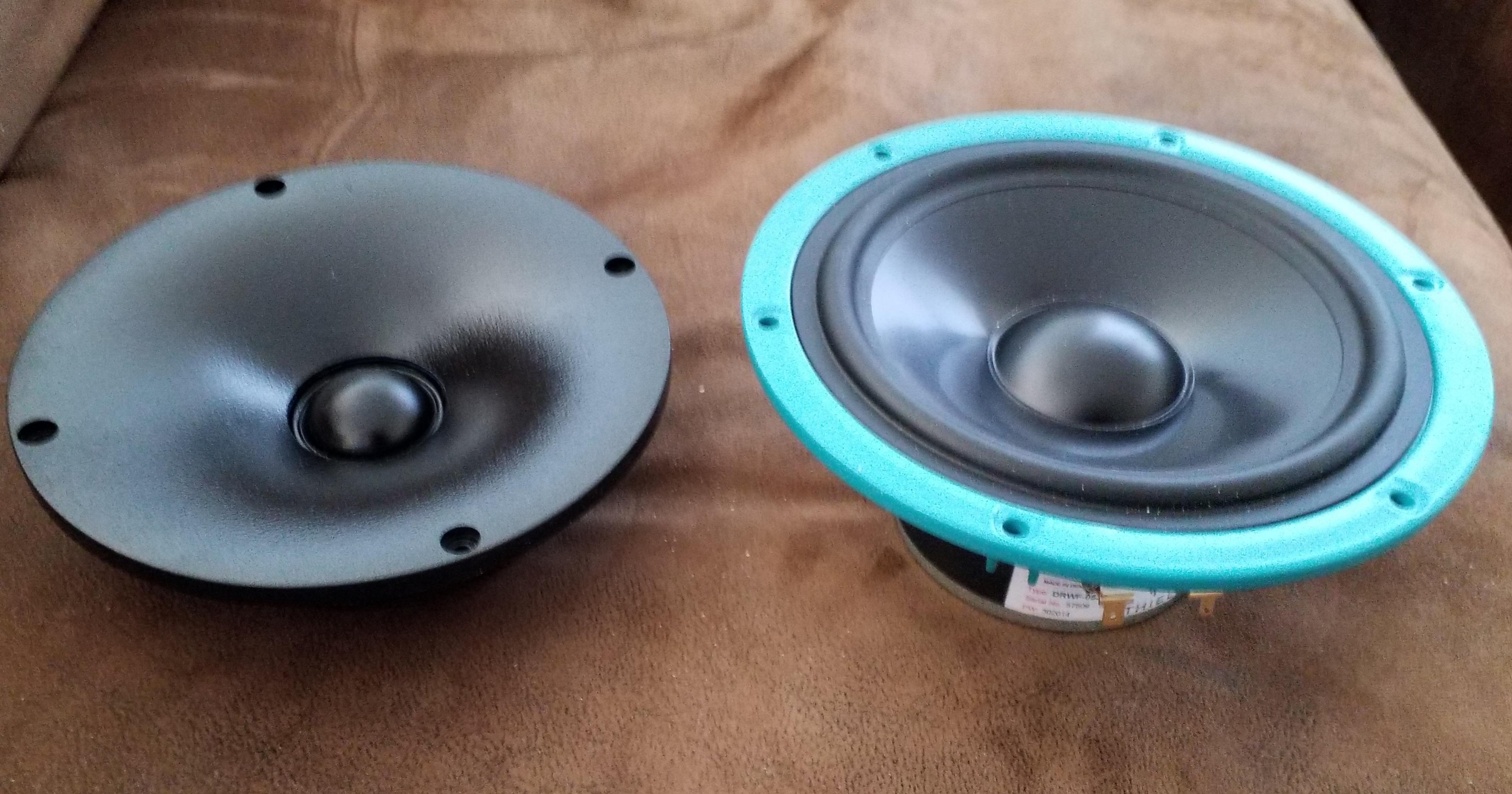

It makes more sense economically to plan on building the shaded, tapered array with MTM center since I already have the CAT378s, TW034s w/WGs and 18W-5537Gs.
Would it make sense to start design on separate MTMs to get driver spacing correct, provided I make all measurements at planned placement height of MTM section in the desired array height/size?

I like WMTMW until I think about moving it about. The W's should be as big and as far apart as you can handle. The inner MTM spacing sets the vertical beamwidth, which should be matched as you expand outward.
I would use VituixCAD to answer those questions. With Vituix, you simply measure each driver by itself, enter their placements on the baffle in the XO schematic and then Vituix will show you the overall response and let you find best placement/spacing, XO and filter slopes - in simulation rather than cut and try. Before you have drivers to measure, you can trace the data sheet FR and synthesize directivity files (measurements) with its diffraction tool. Then you can go directly to full prototype with good chance of success.

That all makes sense. The WMTMW a la Dunlavey has been given some thought, but I like to aim for as narrow a baffle as possible to help horizontal dispersion (and imaging), plus the 18W-5537s have good TS parameters suitable for a sealed enlclosure, which I prefer. I did hear these drivers in a small Thiel 2 way and fell in love with their overall character. They had low reaching, detailed LF and the mids still were smooth/warm with just enough punch to balance it all. Nice drivers overall, especially considering their high Qms and low Fs for the size, plus the VC is rather large for such modest Le.
It does look like this project is taking a slight diversion from mainly being an array. The plan was to originally LP each mirrored LF pair (BP for the MTM section?) progressively outwards, but perhaps running things through sim will sway my plans otherwise.
I have no issues with the potential passive filter complexity and cost, given the driver components are already at hand. It looks like the next step is taking individual measurements of 18W-5537Gs, TW034s and CAT378s on planned baffle width and plugging those into the sim. Fingers crossed...
