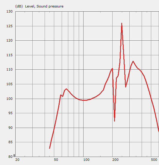

I have been trying to sim a unity horn in Akabak but I'm getting a large peak and dip in response at just over 200hz. I have been moving things around to try and get rid of it.
The dip is the same frequency as a peak in the radiation impedence and a dip in the electrical impedence
Could this be an issue with the model in Akabak? How would I get rid of it?
I am using four B&C 12NDL88 drivers in this sim.
