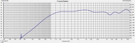

The Fane Studio 8M is crossed at 1,2khz ( where the Beyma starts ) The midrange horn above the Beyma ( with Coral M100 compression driver ) works parallel to the Beyma , crossed also at 1,2khz, first order, but strongly attenuated with LPad. The TPL-150 has not so good vertical dispersion, so that channel helps out a littlebit.
You can see the measurements of the other channels here:
http://www.audiovoice-acoustics.com/forum/showthread.php?t=405&page=2
Probably soon i will give a try, and replace the Fane Studio 8M with LineMagnetic 555 field coil compression driver ( i have become official distributor of LineMagnetic for Latin america :) )
Angelo
Regarding the vertical dispersion (Beyma). Why not just stack two beymas, problem solved:D
