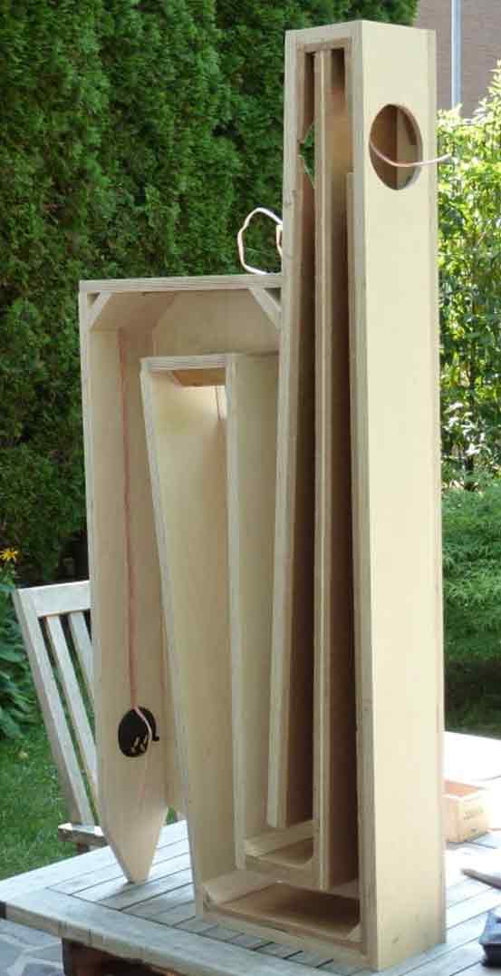

If your speaker placement can accommodate a rear mouthed design, it might be worth taking a look at Scott's Valiant for the FE126En - one of the better enclosures of quite of few in which I've heard this driver

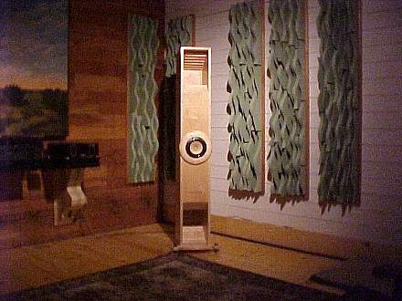

Then you could try dispersing them rather than damping. E.g.

If your speaker placement can accommodate a rear mouthed design, it might be worth taking a look at Scott's Valiant for the FE126En - one of the better enclosures of quite of few in which I've heard this driver ...
