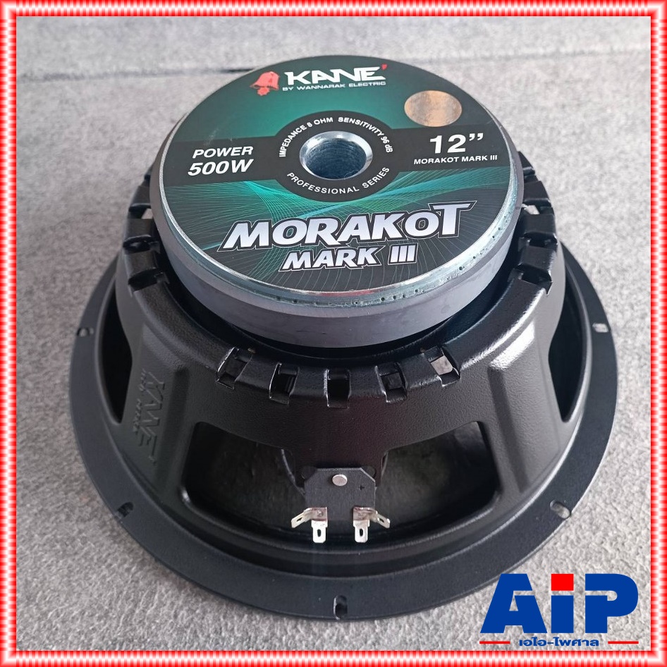

I found some really cheap locally produced 12" drivers that have a stellar reputation, vented spider and high BL vs MMS. The frames are stamped steel but extremely heavy duty. The qts is quite low and fs highish.
What kind of response should I expect from this driver in Ripole? Xmax is only 4.1mm but I plan to use 4 pairs per speaker. I am hoping mid to low 30's
Sensitivity (1W/1m) 96 dB
FS Hz 48 Hz
Vas 92.5 lt
Qms 9.0
Qes 0.36
Qts 0.34
BL T/m 14.7 T/m
MMS (gms) 47.8 grams
Xmax (mm) 4.1 mm
Efficiency% 2.75%
I was wrong about it having a vented spider. But since it isn't exactly long throw that may not really matter that much.
The most important thing with a Ripole design is the crossover. It has to eliminate the peak that comes from the principle.
If you ignore the design rules of the Ripole, you end up with something very different. You can not ignore the front and back chamber and expect it to work as supposed. Volumes are important too.
In the end, when you got the hardware (including crossover!) right, it is all about placement in the room. It is in no way as tollerant as a closed or vented construction.
PS I would not use such drivers as the 12" you showed. If you insist, maybe buy one and measure TSP. Usually these dont match.
