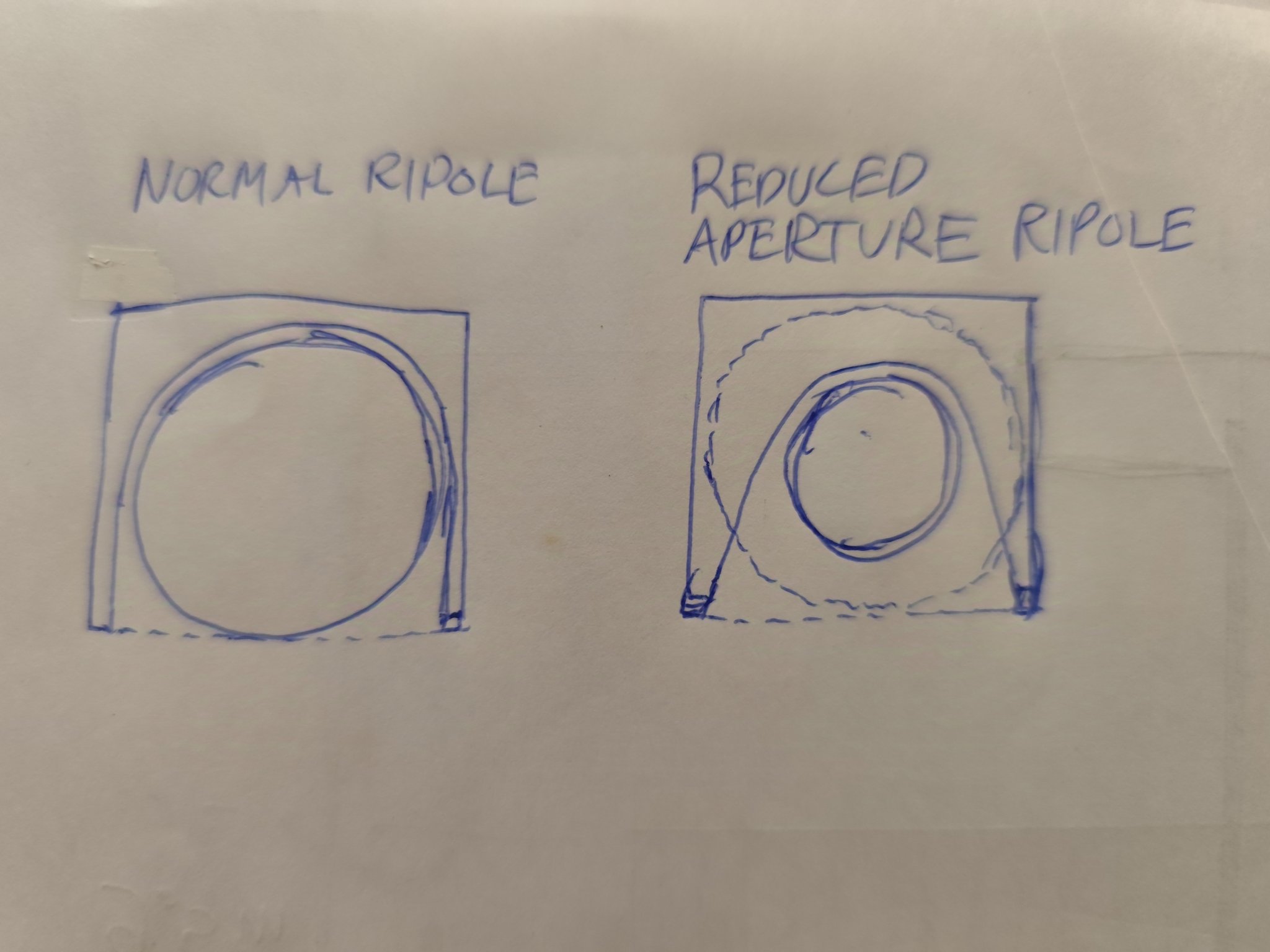

I am trying to decide between OB and Ripole sub bass for a high SPL 4 way OB.
Crossover will be either around 80hz to two 15" woofers or a little higher, 120-140 to a single 15" woofer.
I am looking at 18" drivers and the main problem with ripoles is cavity resonances at ¼ wavelength. For 18" that would be around 180hz.
What if I mounted the 18" drivers on baffles with 12" holes. That would reduce the chamber depth by 3". The chamber itself could flare out from 12" at 9" depth to 18" at the mouth creating a short horn of sorts.
1. Would it work?
2. Has this been done?
3. Can it be modeled?
This would be the ultimate OB bass foundation.... 4x18" in Ripole configuration up to 80Hz and 2x15" in concrete baffles up to 400hz.
For a stereo pair that would be 8x18" which would equal 2 ½ x the Fostex 31.5" woofer.
Here is a sketch in case my earlier description is confusing.
The reduced depth of the chamber should push the resonance from 180 to 225 and the horn shape should also reduce/spread the resonance peak I guess.

If you cross with a 4th order filter at 80Hz, then you don't need to care about a lambda/4 resonance at 180Hz. Your resonance will be < -30dB down. Make a ripole then, hands down, if

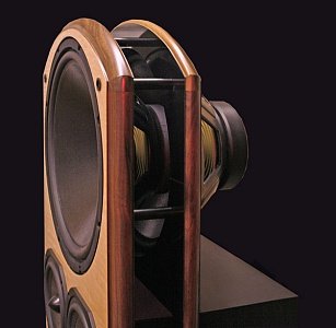

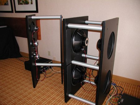

Not sure if I get what you mean. Do you have a picture?
I like the Ripole because of the force cancellation. Without force cancellation you would need very thick and heavy baffles for high excursion 18" drivers!
Like Emerald Physics...just one example.

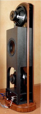

Or like Legacy Audio speaker 'Whisper'.

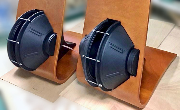

Yes putting a simple hole IS working for Ripole. it needs to ne the same area of what should be put in normal Ripole.
There was an old thread (maybe in a french forum) that was talking about that. I can't find it.
But I recently saw that ABX guys tooked the same principal (here without the back Chamber). They did not a hole but a "circle" of same area. To reduce even more the volume they put a plastic cone that have more or less thé shape of thé speaker cône.
