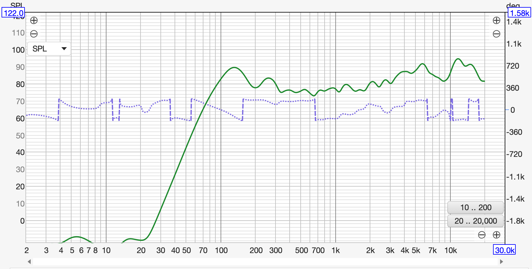

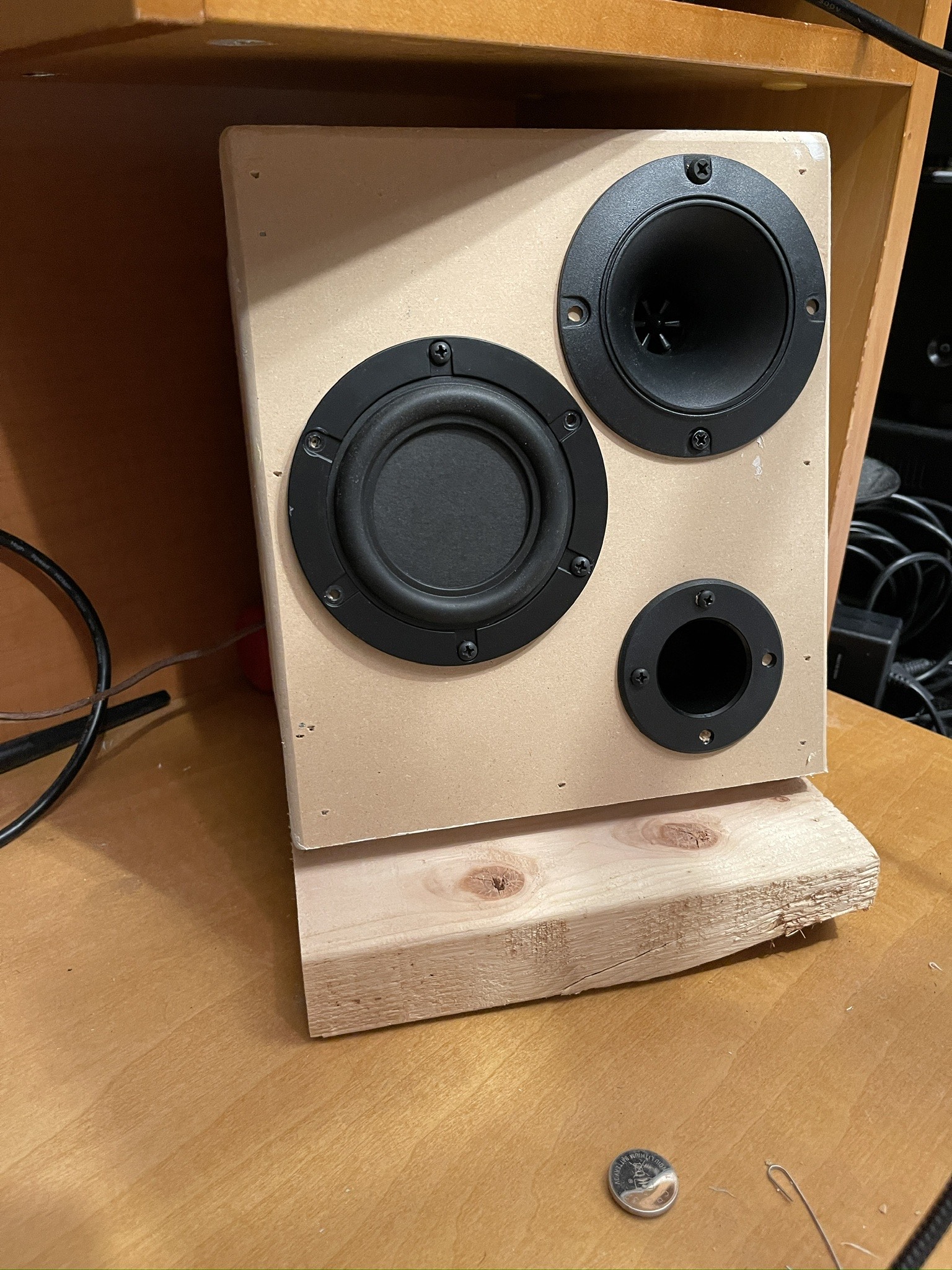

I had a soundbar for my computer audio and I finally got fed up with it. Half a need for better sound and half to acquire more speaker design knowledge, I made these. I used basic math only to calculate it's size and shape, its roughly .18 cubic feet with a 3 1/2 inch full range and a 90w piezo tweeter. I went with the Piezo because I wanted to make the design without a crossover. The piezo's work nicely, but they definitely introduce listener fatigue fairly quickly
I'm still breaking in the BMR's so I can fully comment on the sound, but so far I'm impressed. Please ignore the block of wood adding the tilt, it's temporary. This was made out of convince, that is the parts were all part of past projects. I would love to hear design critiques, no matter how harsh they may be.... I'm here to learn.
These measurements are for a general idea of the speakers capabilities, I used REW but with an uncalibrated mic

Nice! You might want to reduce the tweeter level with a (rather high value, because of piezo tweeter, maybe 10-20 ohms) resistor.
And the woofer is not suited for a vented enclosure because of high qts. Is that a port in your picture?
You could stuff the port and add a series cap to the woofer for better low extension and linearity. Something between 270 and 560 uF (non polarized) maybe. If you have a simulation tool try to find a good value.
It may also be possible to use the vented box with a high pass cap, but that would definitely need simulation.

Could you post a view of the frequency response where the vertical (dB scale) is approximately 50dB from bottom to top?
The "fatigue" could be from the 10dB boost at 6kHz, or the >12dB boost >10kHz. The piezo definitely needs attenuating.

The frequency response looks fairly good for a piezo.

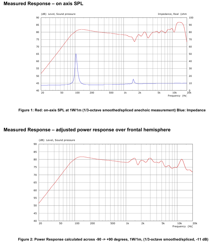

Your BMR looks like it has a rising response tendency on-axis in the upper frequency range also. Ultimately a simple crossover (single inductor on your BMR, and a circuit to attenuate the piezo) might help your speaker perform more consistently.
https://www.parts-express.com/pedocs/specs/297-2156--tectonic-tebm65c20f-8-spec-sheet.pdf

Sorry I'm fairly new to rew. How do I do what you are requesting?Could you post a view of the frequency response where the vertical (dB scale) is approximately 50dB from bottom to top?

The sensitivity of your BMR driver is quite low (81 dB at 1 watt). That's more likely to be the source of the volume issue.

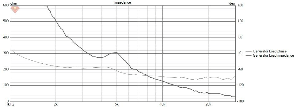

The piezo's wattage rating is just an indication of how much 8-ohm rated power is safe for it; it's not an indication of what it will actually draw. The impedance of it will be very high at lower frequencies, so the actual power draw will be minimal.
Example piezo impedance plot from here:
https://www.diyaudio.com/community/...super-tweeter-piezo-tweeter-revisited.399363/
