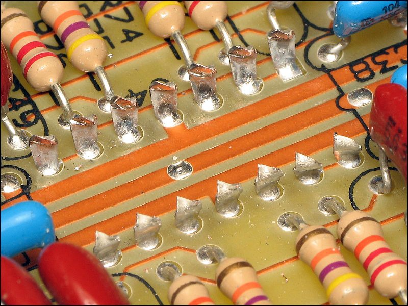

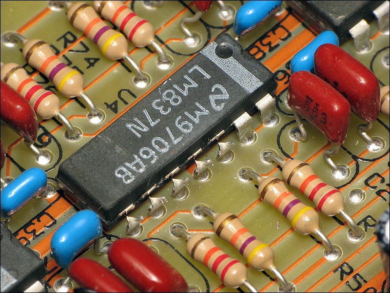

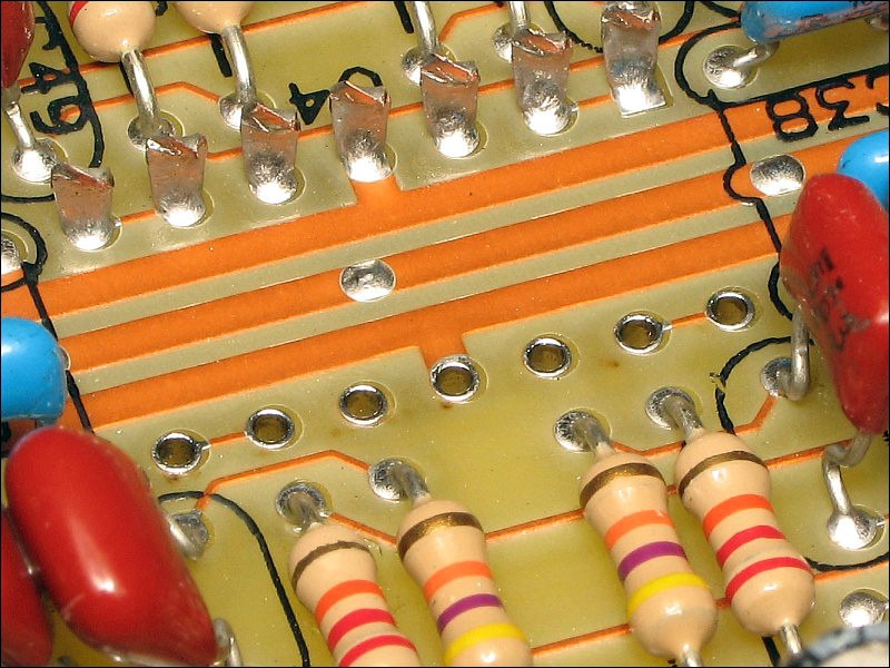

If you attempt to remove the IC, clip the leads at the body of the IC, remove the body and then desolder the legs without touching the board with the tip of the iron (heating the leg from the IC only). Add new solder if the leads don't come out easily. These boards are EXTREMELY easy to damage. Avoid touching the pads on the board if at all possible.
