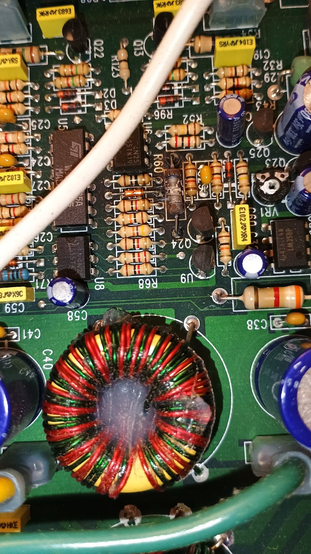

If the resistors are the ones that lead from the output of the driver IC, they're not critical. The diagram attached shows them as 22 ohms driving 4 FETs. That value should be fine for the 150. If it has emitter-follower pairs as buffers, you can go a bit higher. 47 ohms were common in larger amps.
Install them raised slightly off of the board so they don't do damage if the amp fails again.
I have photos of a 150 if you have different resistors burned.

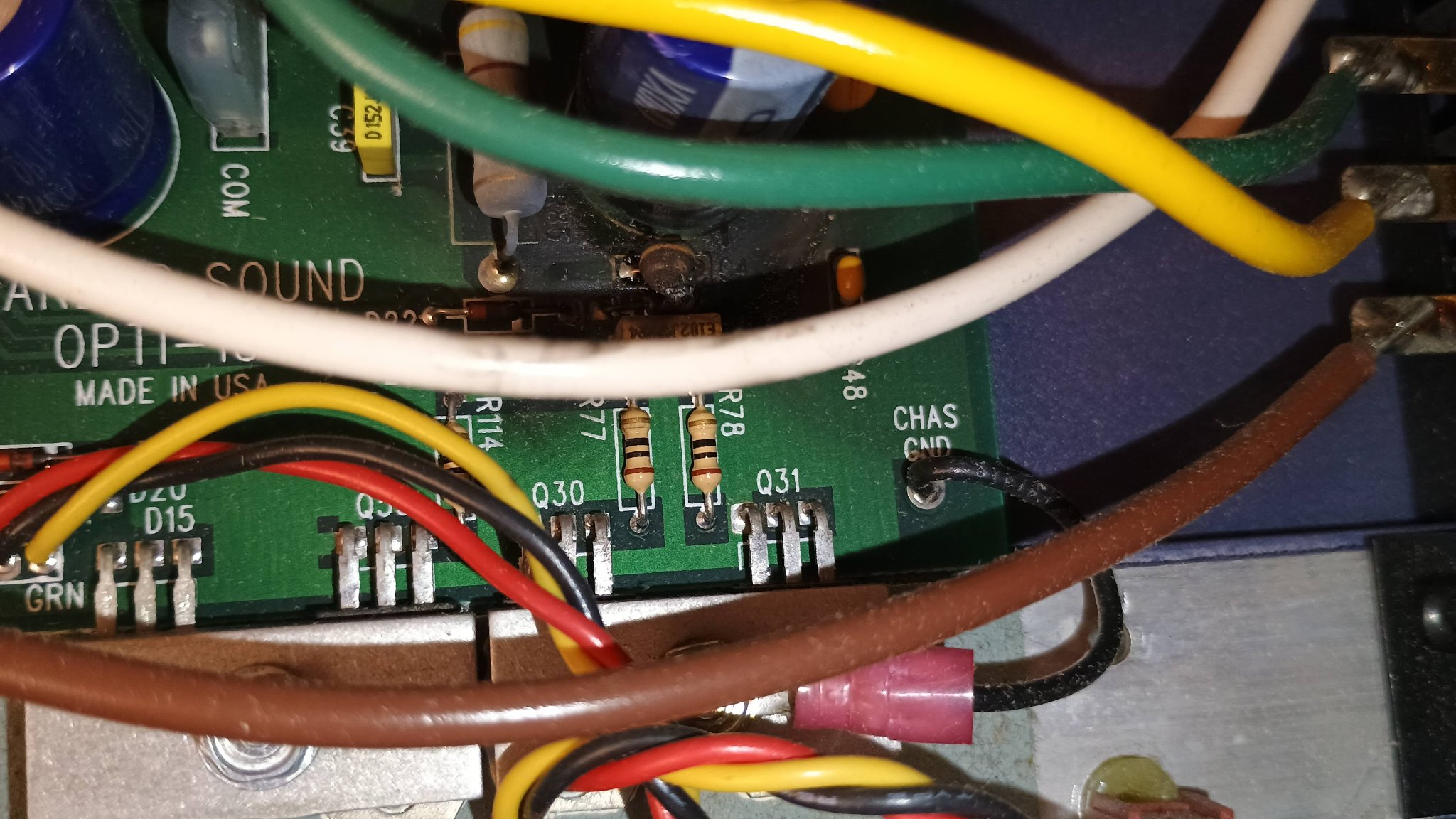

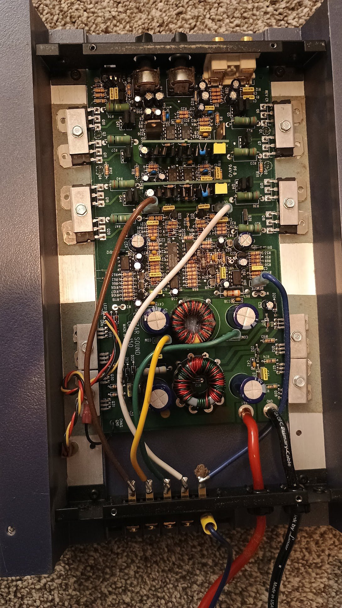

Thanks Perry. I haven't dug into it yet. Overall it looks pretty clean, other than this burned resistor in the middle, and this burned...ceramic cap(?)...near the power supply
