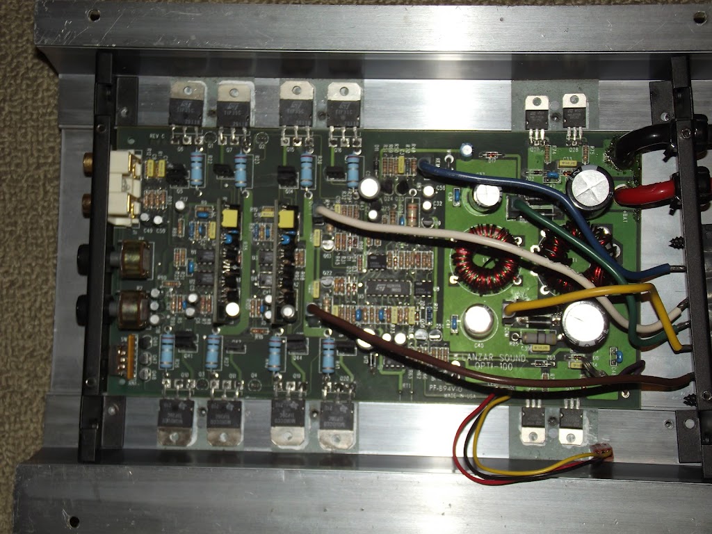

U1, U2, U3, U4 are the op-amps located in front of each vertical board. I can't see the number on them but two of the pins carry the rails. Just want to make sure they are working properly. Pin 4 and pin 8 should have the rails on them unless its a single op-amp and then pin 4 and pin 7 will the rail pins.
Can't really see in the picture but Q13 and Q22 look like the lower rail supply regulators, and they are very close to one of the opto's in the power supply circuitry. The wires in the picture block my view to be sure...

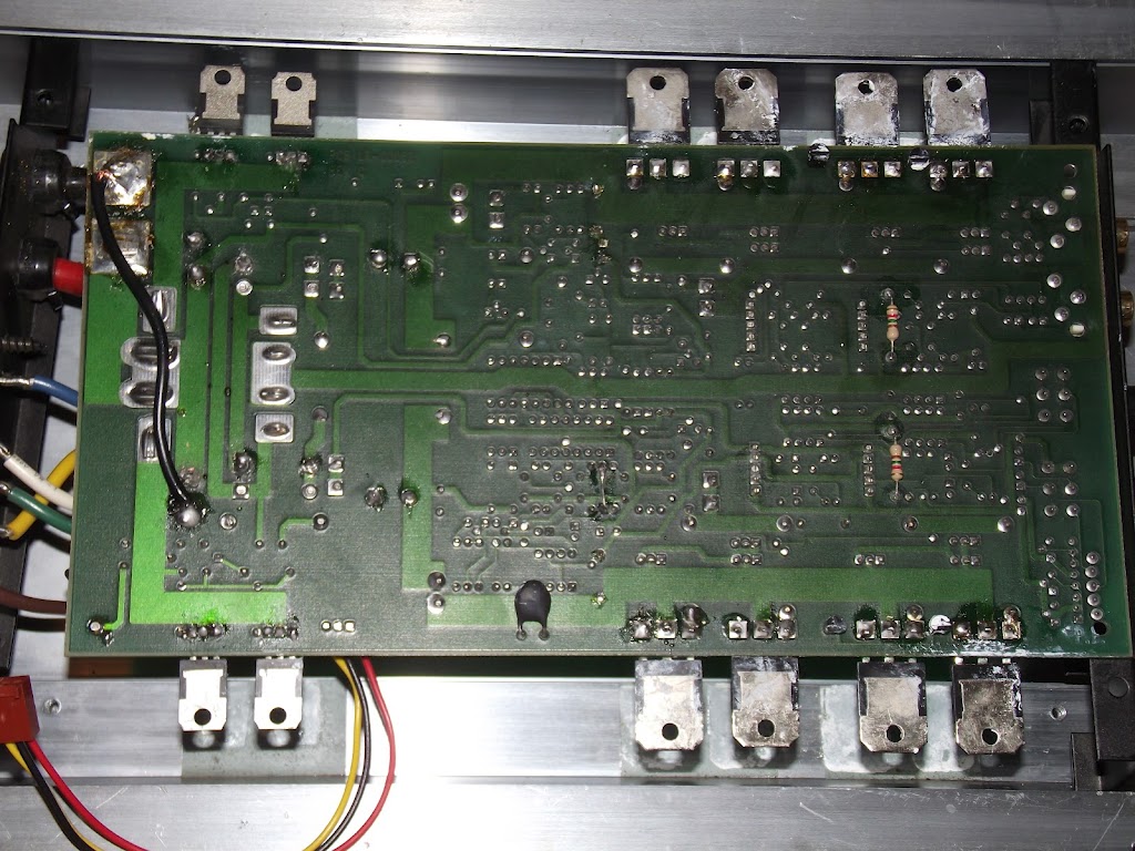

I also noted a resistor on the board that looked like it had flash marks underneath it. R70 near the blue wire looks like it has seen high heat and is discolored in the last pics you posted. Please check it to verify if its in spec to its color bands. You can Google search resistor codes to find how to read the bands and it should read very near what its bands denote its value should be. I would myself but on blow up the picture blurs too much for the detail I need to see its value.
