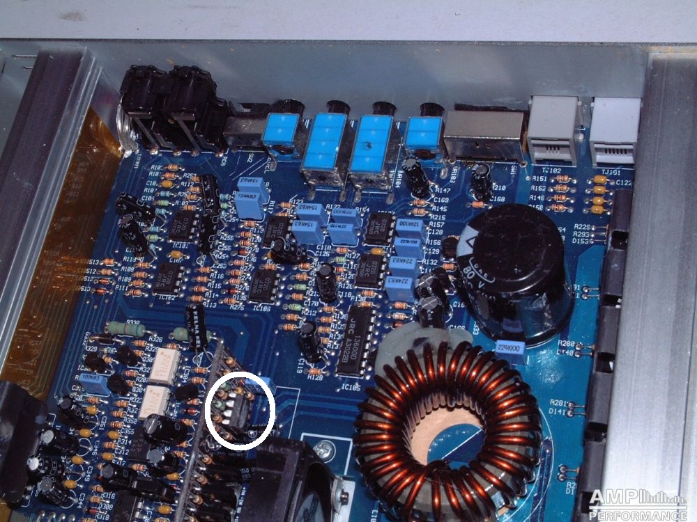

Long story in short.
Amp produces output and works just fine under 13volts of input B+.
Once I feed it over 13volts it goes into protect and stays there till I drop the input voltage under 13volts from my laboratory power supply.
I've removed the rectifiers to isolate the ps section from the amplifier one - power supply section works great, no protection, nothing even at 15volts, so it's not the PS.
So far I've changed the two LM293, the two optocouplers tlp521-2, the JRC 1300D OP AMP, and checked every other OP amp and their supply voltages on the main board - all fine.
The two voltage regulators 7915 and 7815 are giving their respective +-15volts.
The only thing I don't know is the chip on the Driver Board Module in DIP8 form factor in the picture.
I've already pulled out the Driver Board Module and checked every transistor and diode with a Multimeter in diode mode to confirm there is no shorted ones. I know these can get hot quite a lot. All reads fine.
Any ideas ?! 😕

I think the problem is somewhere on the main board, not in the driver module card. Amp goes into protect over 13volts even if the driver board is out (mosfets were still in place).

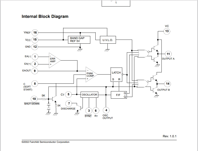

So I've measured every pin on the KA3525A and the only thing I noticed which was odd was pin 8 - which is for soft start function.
If input voltage is lower than 13volts of B+, pin 8 stays at around 4.7vrms. Once I up the voltage over 13v, it goes to 0v, like it's grounding but nothing heats up. Then if I lower the input voltage again but under 13volts, pin 8 slowly rises again to 4.7vrms and amp kicks in operation mode.
What I've noticed looking at the diagram of KA3525A that pins 1, 2, 9, 10 even that they are internally connected with pin 8, they does NOT change their values in terms of Vrms. They stay the same no matter of the b+ input voltage.
Everything else looks ok. VCC, GND, Ct, Vref, Outputs A & B, looks great...but once the voltage passes over 13v+, no more output at pins 11 and 14

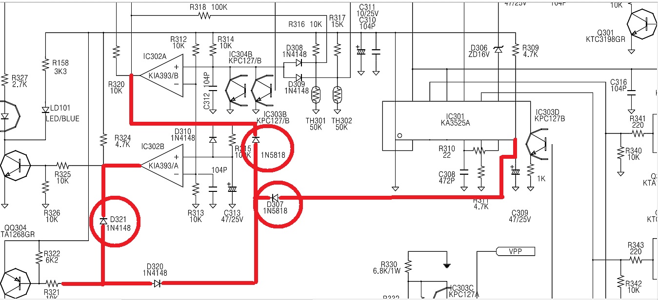

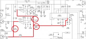

A little bit of investigating, pin 8 the soft start, gets its voltage from the output of one of the LM293P. Going over 13volts of b+, cuts out the voltage on pin 1 "1out" of the LM293P...
The only values that are in direct correlation with the b+ of LM293P are the IN+ inputs and the outputs. The IN- stays the same all time ~ 2,7vrms.
The supply voltage of the LM293P stays also the same all the ~ 5.07vrms.
But how does pin8 for the soft start even gets its voltage when there are diodes in the way in reverse orientation ?!
I'm not really good at reading schematics...🙁
And yeah, I know my paint skills are incredible 😀😀😀

Okay, that's what I thought too.
Found two 1n5819 diodes reading ~ 210 in diode mode one way, and nothing in the other...i'm going to get a new ones, but i don't think these ones are the bad guys....
And the schematics I posted earlier does not match exactly with the board in front of me...mine seems to be another revision. There are some differences...

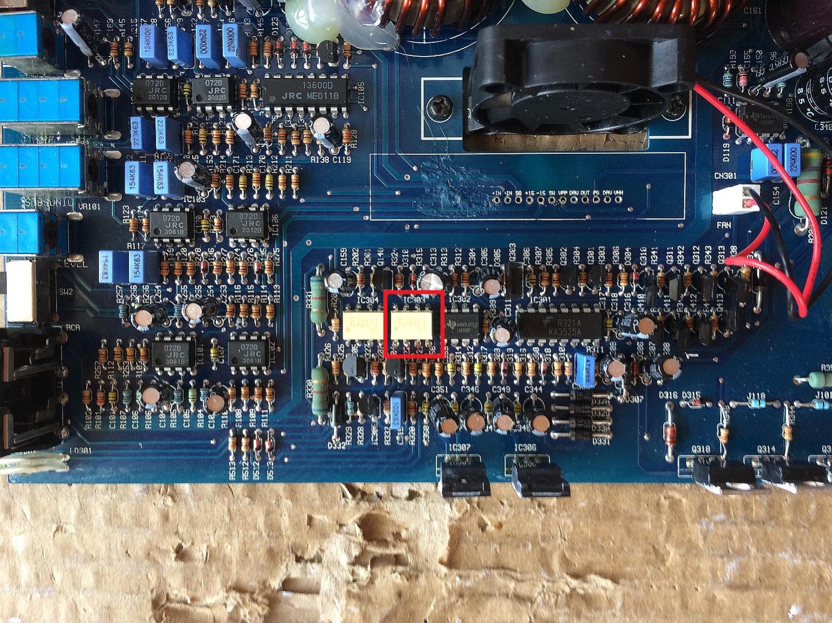

Pins 1 and 2 for the two optocouplers are the input to the protection circuit. Bridge them together (you can do so with a meter probe). Does bridging either allow the amp to remain on?
When it goes into protect, does pin 3 drop below the 2.7v on pin 2 lf the 393?
LM 293/393 - pin 3 drops to 0v when amp goes into protect. In working stage it stays at 5vrms.
"Pins 1 and 2 for the two optocouplers are the input to the protection circuit. Bridge them together (you can do so with a meter probe). Does bridging either allow the amp to remain on?"
Pins 1 and 2 - at the optocouples (there are 2 of them) or pins 1 and 2 at the KA3525A ?!
Thank You so much Perry ! :cheers:
Bridging one of the optocouplers actually makes the amp go out of protect and stays operational with a higher input voltage b+.
The one in the picture in red...so now I have to trace what's wrong with the protection circuit.
