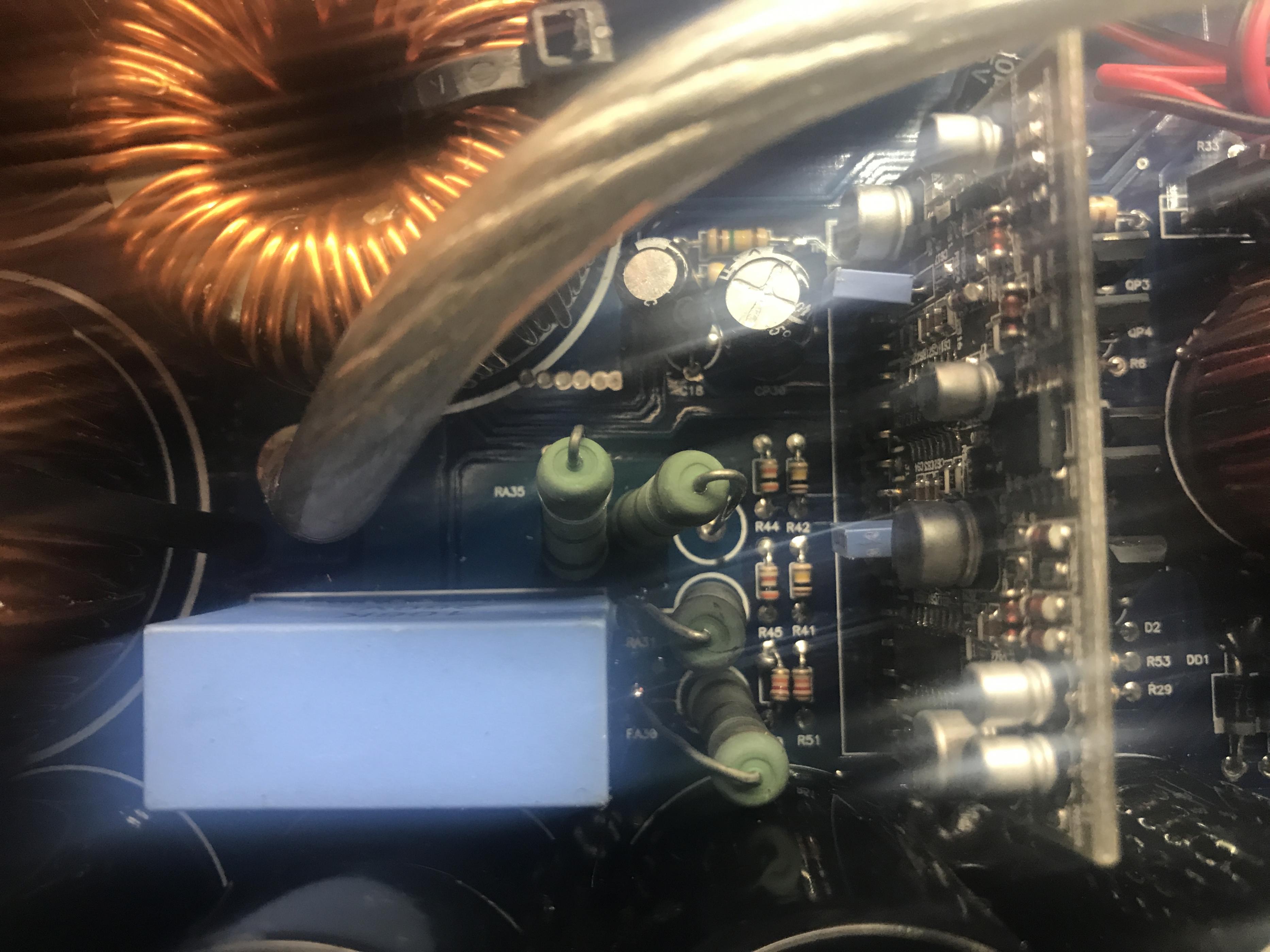

I'm working with this Lanza, it came to me with a broken output coil, but after I repaired the coil I tested the amp, I noticed that it is making a noice, and RA30, RA31, RA32 and RA35 are getting red hot when the volume is increased.
Eny idea?

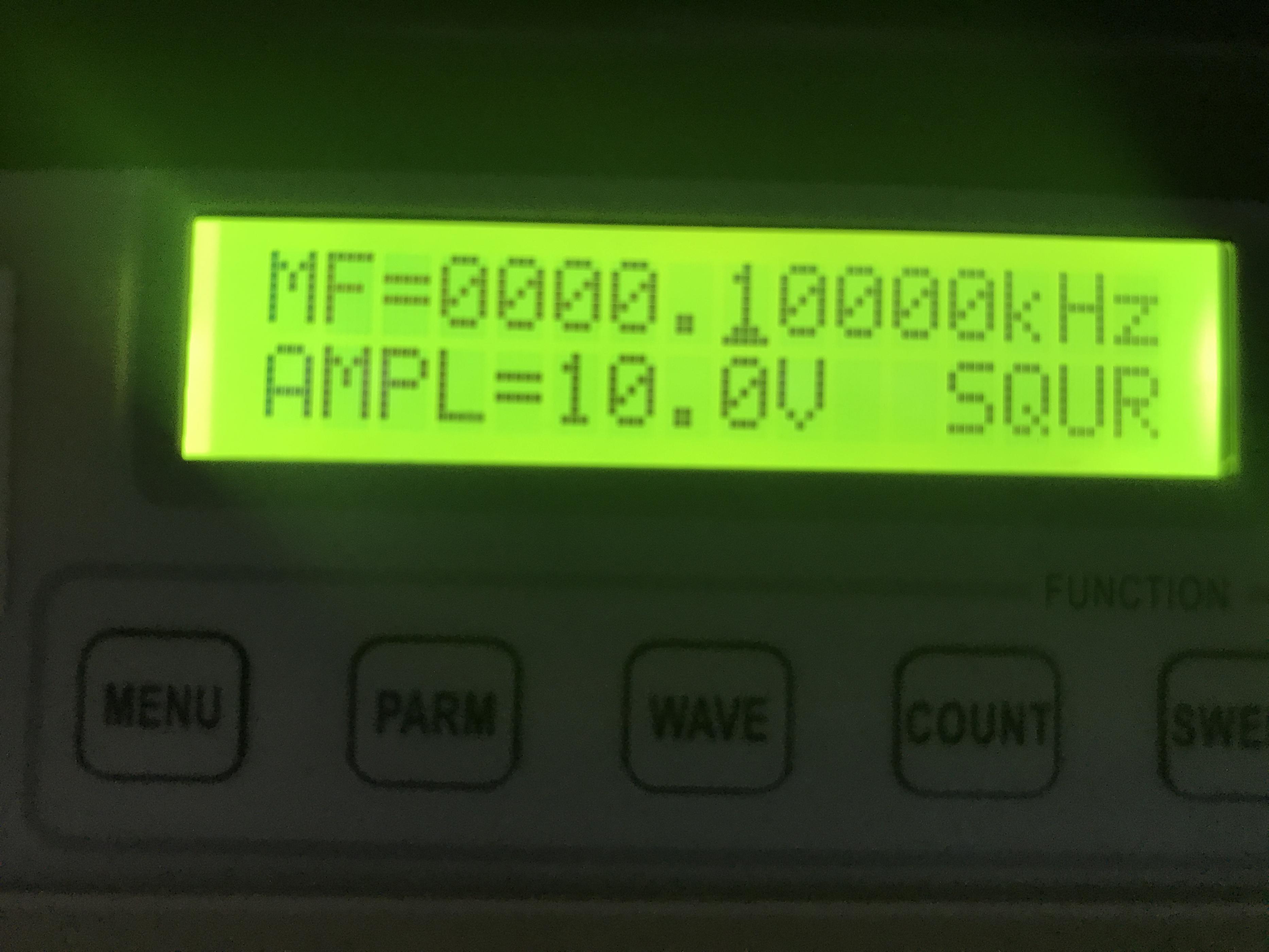

There are some class D amps that won't reliably oscillate unless driven with a signal. If you don't see a rail-rail square wave on the output FETs/filter inductors, try driving a signal into the amp. When checking the amplitude of the carrier, you won't need to have any input.

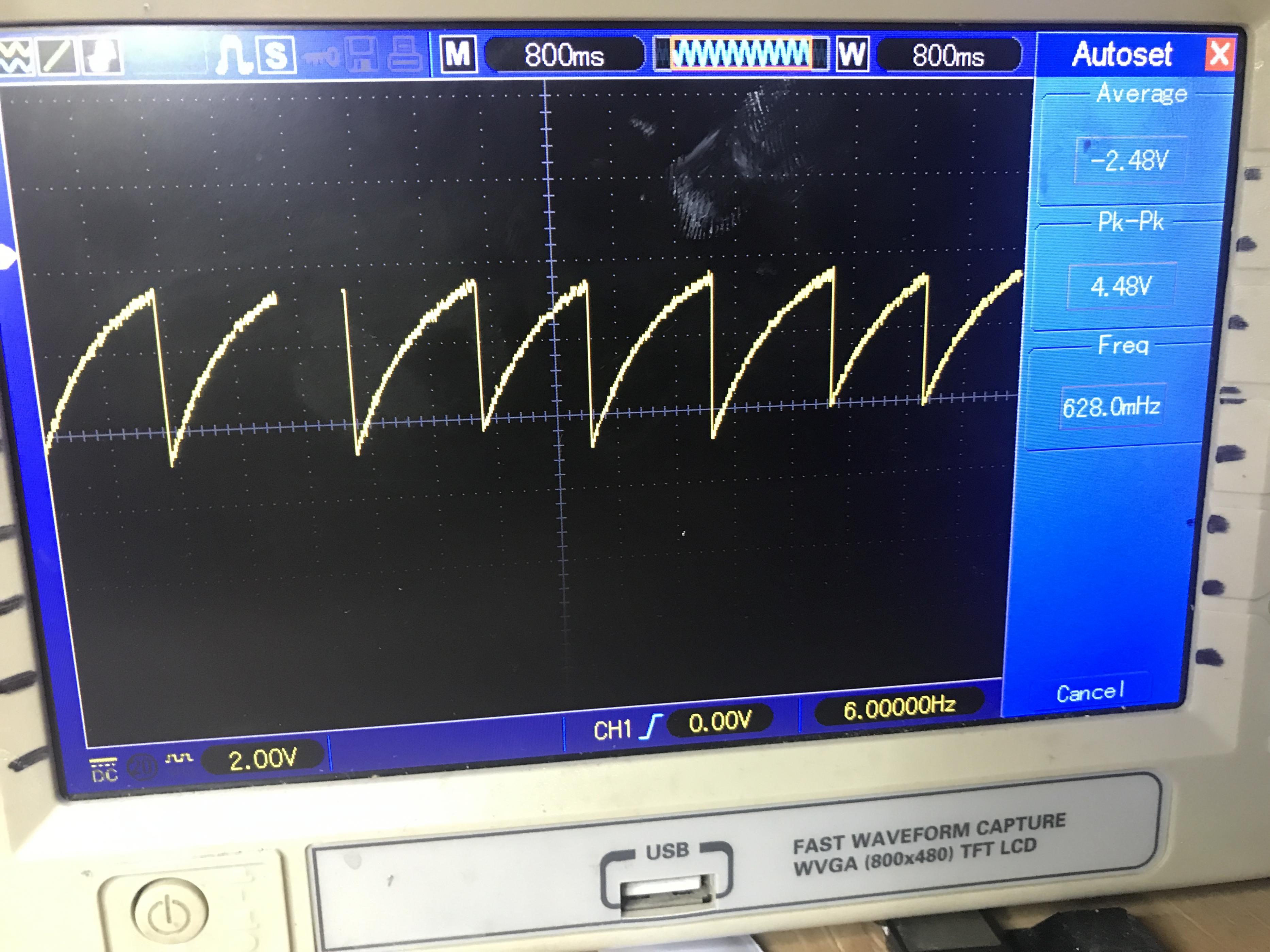

Using the scope AUTO SETUP There is no good readable wave at the output fets, with or without input signal.
Only if I setup my scope to 2 vpp and 800ms, then I get a sawtooth wave.
These 2 signals are between the LA3 and LA4 junction and between the LA4 and CA8 junction.
See pictures bellow.
