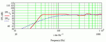

A simple MLTL should do the job fine. GM has done a couple, here's another option: 46in x 6in x 4.5in (HxWxD). Driver centre 14.75in down from top, vent 2in diameter x 2.125in long, as close to the bottom as possible. Stuff 0.48lbs ft^3 from the top 25in down (all dimensions internal).

Oh, it should work passably with the TBs for what it is, though the CSS units will be a no-go zone & to my way of thinking, it looks like it's making life harder than it actually needs to be.
