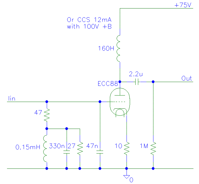

Quick question regards the circuit Richard posted. There is an option to use a CCS as a plate load. I have built a Tubelab SimpleSE that uses a IXYS 10M45 as a plate load in the driver stage (12AT7). Can I use a similar device in the I/V circuit?

Hi Chris,
I'm using the 10m45s, on little boards from DIYHifiSupply, as plate loads on my tube I/V stage. I've tried a few tubes and circuits, it's currently a simple 5687 anode follower. 6N6P was also good. DAC is a PCM63.

Sorry for the late reply The info you have given me has really helped construct my srpp.Thanks for the time answering what to you must seem very basic questions. Its built, but just like when I made my mark one, it takes me a few days to pluck up the courage to actually switch on lol...
No problems, glad to hear that it's up and running. Now you can start tweaking the parts quality 😀
