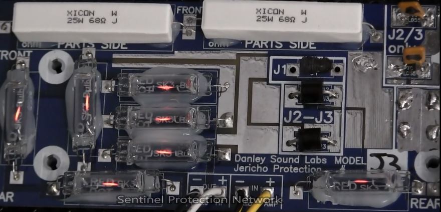

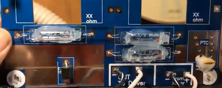

speaker passive protection circuit
Am sure you have seen these....... trial and error....good luck!Am I on the right track here?
Yup. The combination of "lamp protection" and PTC devices appears a lot. In the Bose AM10 Series II system for example, I think every one of the 5 channels had the lamp/PTC protection combo. It makes the system almost foolproof. Almost. There has been the occasional fool who has still managed to blow their Bose systems... 🙂
