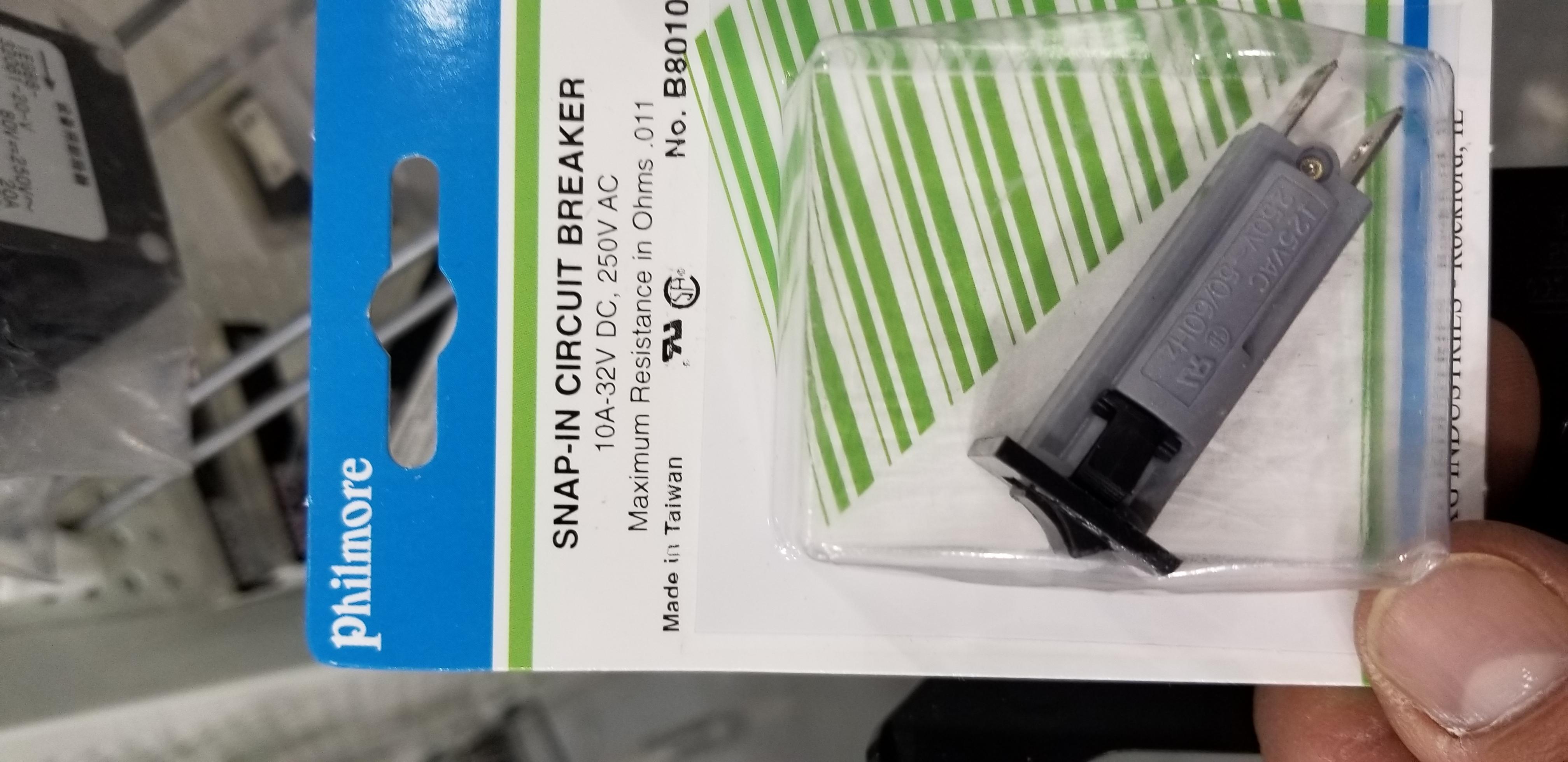

Here's something i found at the local Sayal store. Don't know if it's applicable but they come in different volt and amp ratings.

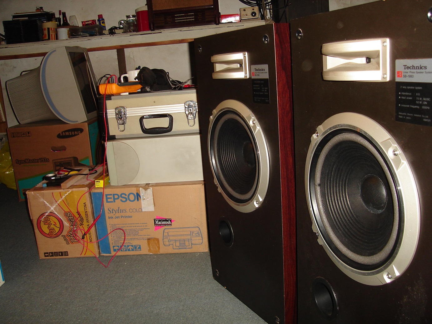

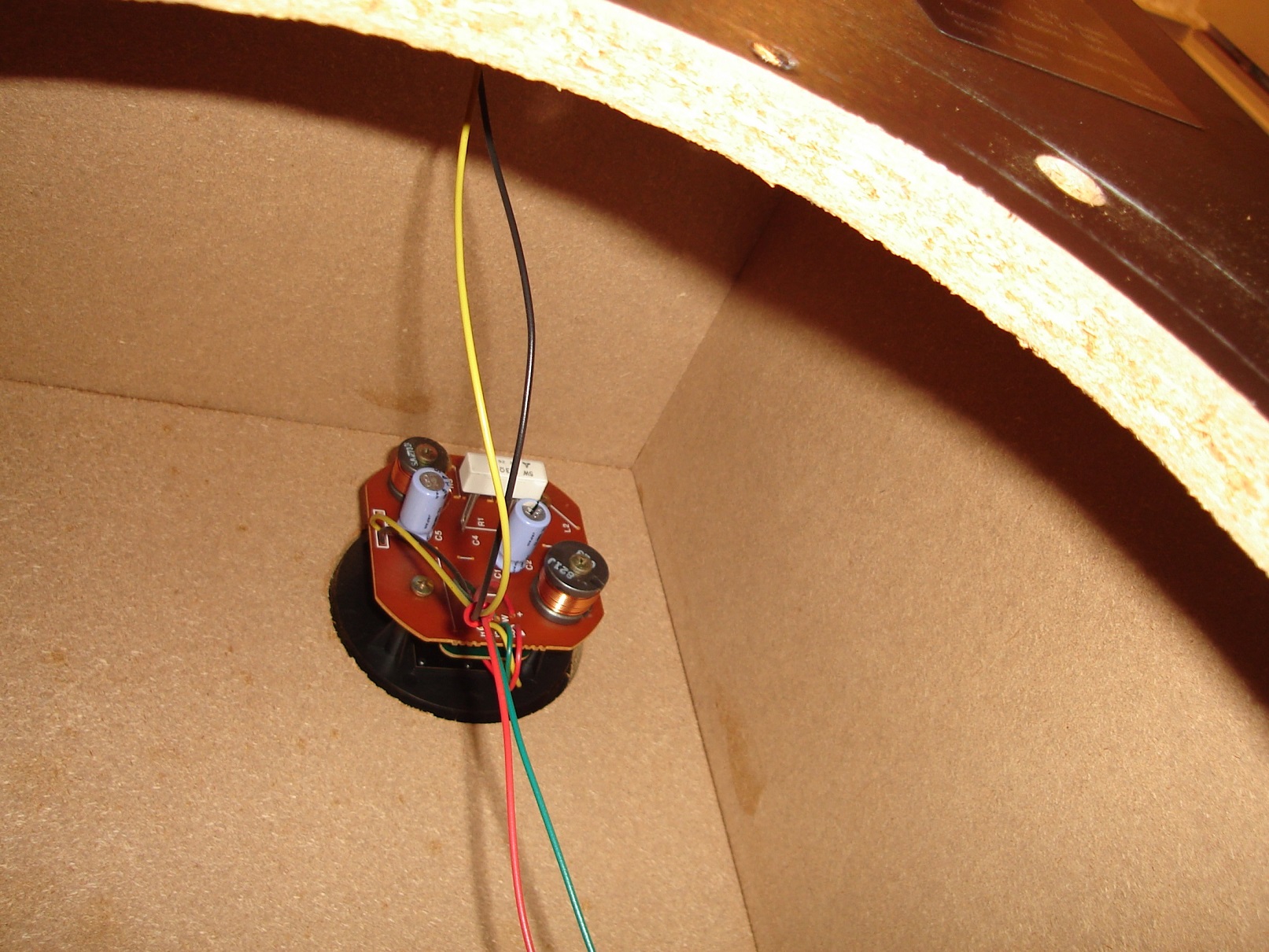

Loudspeaker protector SB 1950 Technics
This picture is taken when I repairing the twoofers, but I can not be sure if they protect the twoofer or the horn tweeter.
Sorry, can´t find any protector in the pictures.
In any case, if you mean some small bimetallic circuit breaker, it´s probably for the tweeter.
