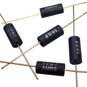

🙂 great you like the sound with the thick film resistor..
when you will have some times with the SIt try to change the 2 computer grade power Caps with Evox Rifa or any lower esr aluminium caps..
what values did you try/use/prefer ?

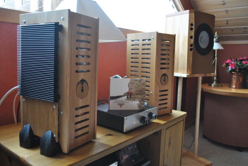

hi olav, i have now a 26 DHT preamp with output cap and now use a 4V cell battery as Bias with my sitamp ... but from the time i used a bypass cap and douce resistor i didn't notice any hardness in the sounds but i was using a 47000uf mundorf mlytics in this place..
anyway you have a fantastic looking wooden case for your sitamp !!!

Yes Juanitox - my boxès for the SIT was nearly as ordered(they were made for 3 liter wine-box), and I fixed and strightened them somewhat so they could stand the 400 watt trafo + some electronic and such! Ended up stuffed - and I don`t want to show the inside - even if it is fairly orderly and safe - it is STUFFED. Some Heat-sink also.....
