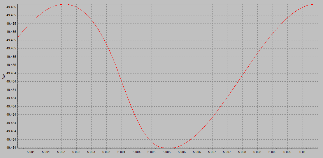

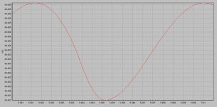

i have juste plug my pocketscope on the PSU i don't see ripple but have 0,35V B+ variation on C2 , is it good or not ?🙂
10 mR (milliohms)
1. 4mH coil
2. 20mH coil
1. 4mH coil
2. 20mH coil
I just measured around 14mV pk-pk with the CRC, so 4mV seems reasonable for the 4mH CLC.
@juanitox
.35V ist nicht so gut.
i'm not already german , and even less with our new president 😛 ( generg i love you! 😀)
.35V is voltage variation not ripple or i will ear it with the head on my horn. at 1V setting on my scope the Line is flat so i think there is not so big ripple. 🙂

here is the psuD of my CLC , hope i make it right..🙄
i have try to see the 30min Sit warming , but i have " Does not compute" message on screen 😀😀😀
simulate for 100,200,300,400mS after delay of 1s
simulating for first sec is informative , just to observe power-up conditions (overshoot,God forbid!)
