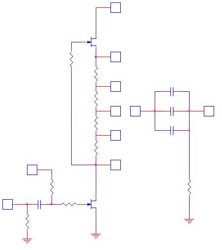

I wonder why I havent seen anyone trying a configuration like I show below? ...I also still wonder what makes a mu-follower, a mu-follower, and what makes an SRPP, an SRPP?...
Tapping the output from the bottom Source R creates a 1/2 u stage...
Hey, I'm 1/2 way to understanding 😀
So, I beleive the ouput tapped from the top of the Rs's makes it an SRPP cicuit
There is a mu here somewhere???

I have some lovoltech fets which would be ideal for a simple l'amp style build head amp rated at a couple watts output. I do not think cascoding ala zv9 will be absolutely necessary as long as pre or dac has low output impedance.
you need to cascode them not from input impedance reasons , but from needed swing reasons ; as Papa use them ( and there is no reason to doubt either Papa or Laws of Physic (they're equally funny 😉 ) , you need to maintain few volts across them , to keep them in linear/triode region .
