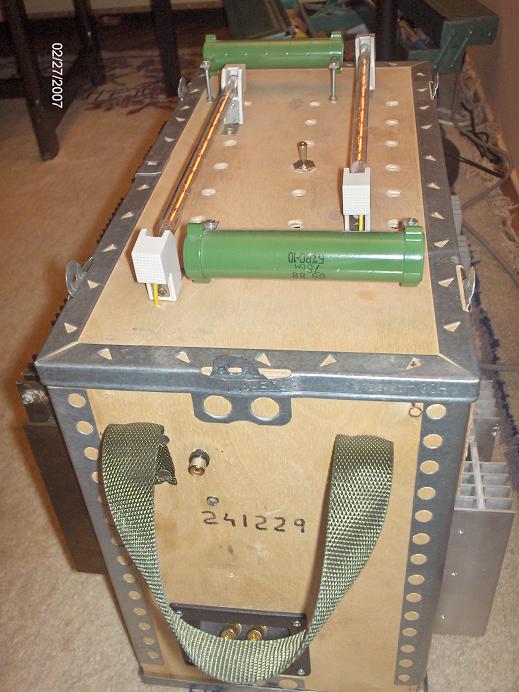

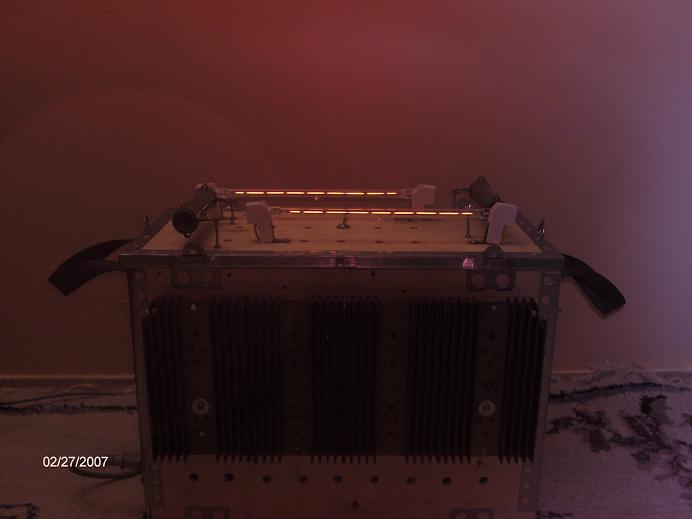

I'd like to see someone build L'amp with 1500w 220v halogen sticks, like I did on my F2, some years ago...beside sounding magical, it will look magical as well... 😉

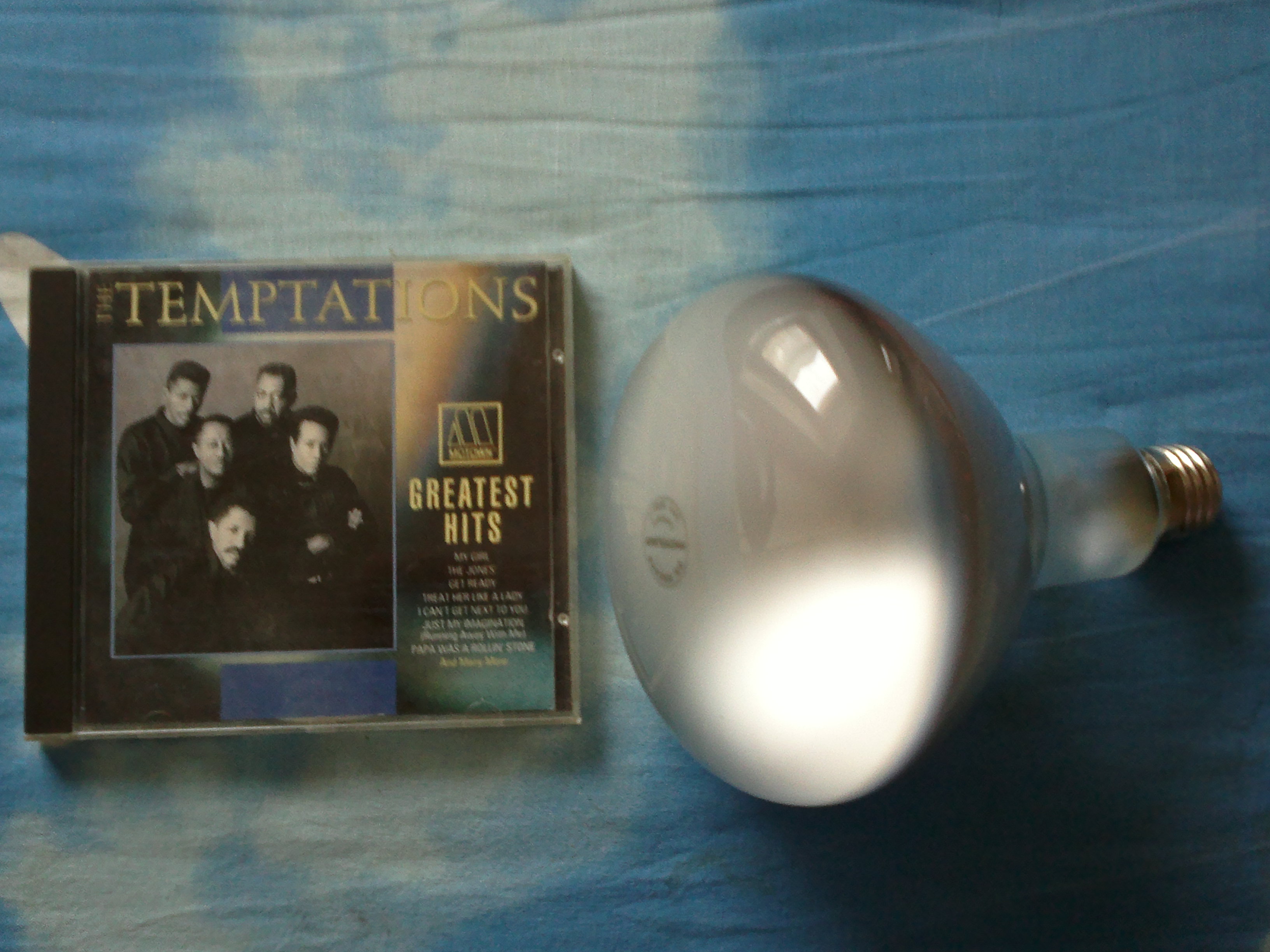

Hi Stefano!
As far as I remember, halogen sticks were some no-name ones, (the cheapest chinese ones I guess).
Stick sockets? Hehehe...I was scratching my head back then how to solve that one. In the end, I just bought a pair of cheapest reflector lamps (like the at the pic) scraped them and used the sockets 🙂
Also, there are some air-cooled power resistors of 75 ohms each, otherwise of no use, but I just used them in paralell with the sticks to provide a bit more current...
By the way, I was also considering using some infrared quartz heater elements instead of halogen sticks, but turned out I didn't need them... (not sure if they would work, maybe someone could try 🙂

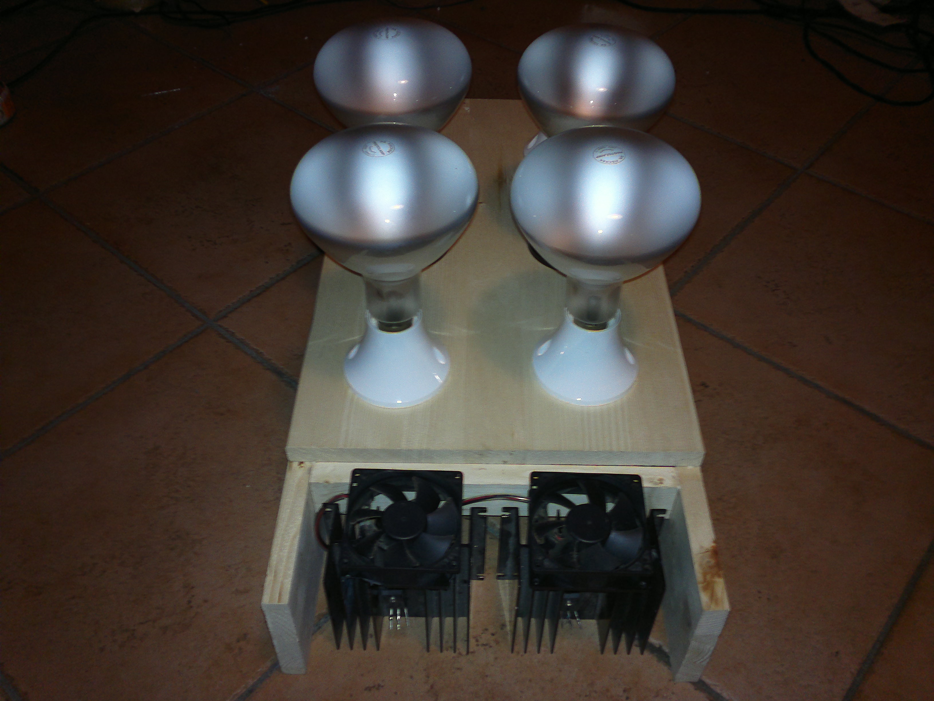

By the way below there is a picture with the photo lamp that I did find here in Italy . I will build into 2 of them ( 500 watt times 2 ) plus one of 200w par channel . Building the "case " right now .🙂
