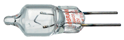

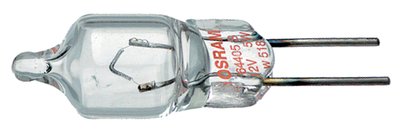

I wonder if this is a good solution: 2 of these in serie - Halogenlampa 24 V 100 W GY6.35, gives app 12 ohm - and take 1 or 2 resistor 40Watt/1 ohm also in serie. That way you can try both lamps and resistor.
And stay at app 14-15 ohm load! And the biulbs are 4000 hours livingtime. And the voltage over the lamps should be fairly ok. And the Heat Sink for resistors will stay somewhat smaller.
I include a pic of the lamp, and if anybody could leave a comment...

You are right - but with a couple of resistors i serie some of the voltage over the resistor will lower the voltage that stays over the bulbs - but you could also use 3 bulbs= 72 volt/15-16 volt and no resistors.
Could be more than 1 solution on this dilemma ; big heat sink with many resistors - or samller heat sink, w some resistors and 2 or 3 bulbs?

Ohm`s law: Volt x Volt / Watt= 24x24 divide on 100= app 5,7 ohm. but it depends somewhat on the current. so app 1,7 Ampere....
Gets you nearby I think

You really want to measure the bulbs at the voltages and currents you'll be using them. The resistance changes with filament temperature.
Thougt so...
Yes - it was my intention to get the powersupply together with 3 bulbs = approximately 15 Ohm - then 2 pieces 1 ohm resistor/50watt --- and then measure the ampere through the serie - and the voltage over each individual bulb/resistor. First measure cold, then measure them when they are hot!
That way I will know the load/heat/and resistance on each bulb(in cold/varm condition).
If they change too much when hot - I will build a resistance-chain like generg.
