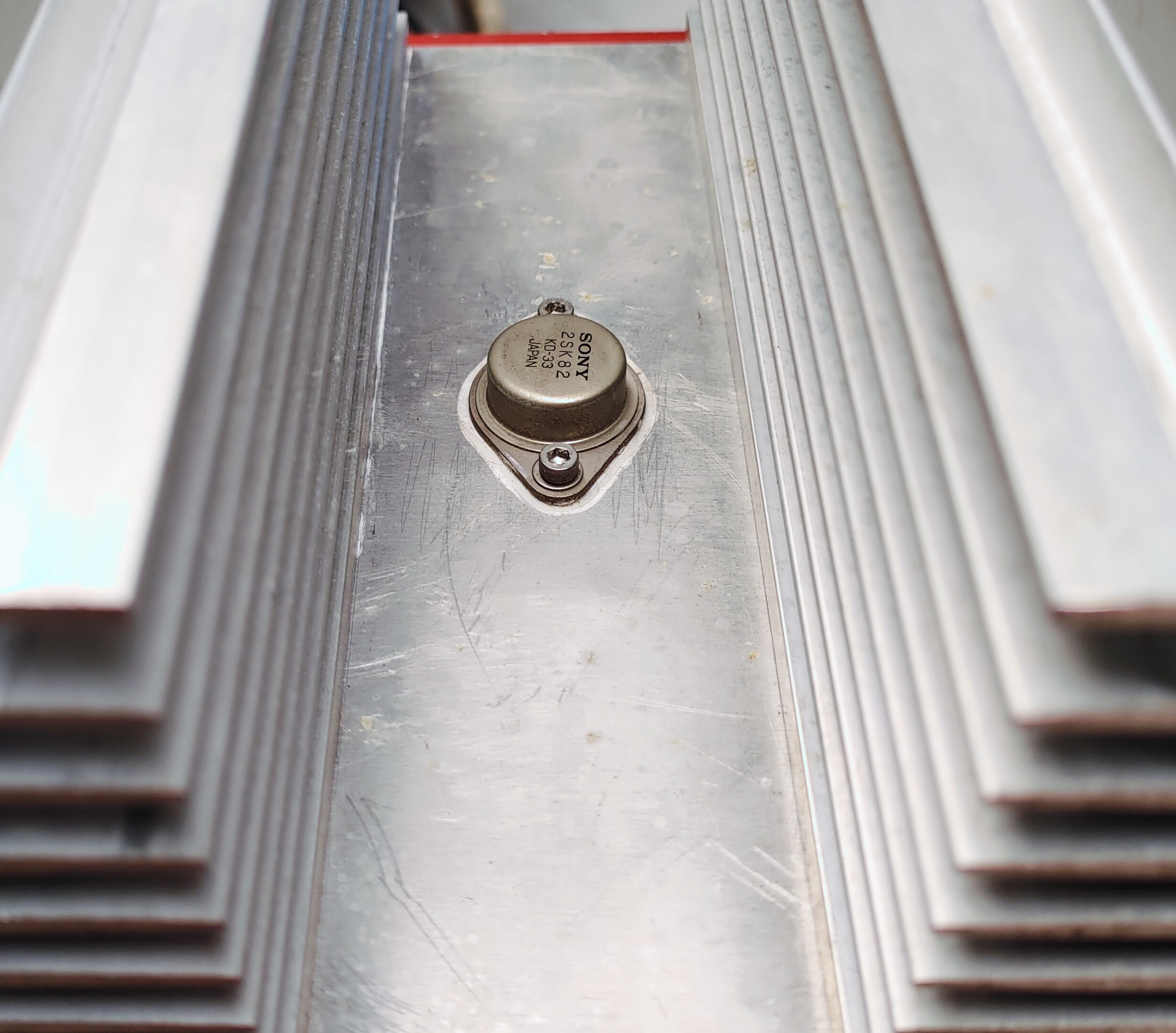

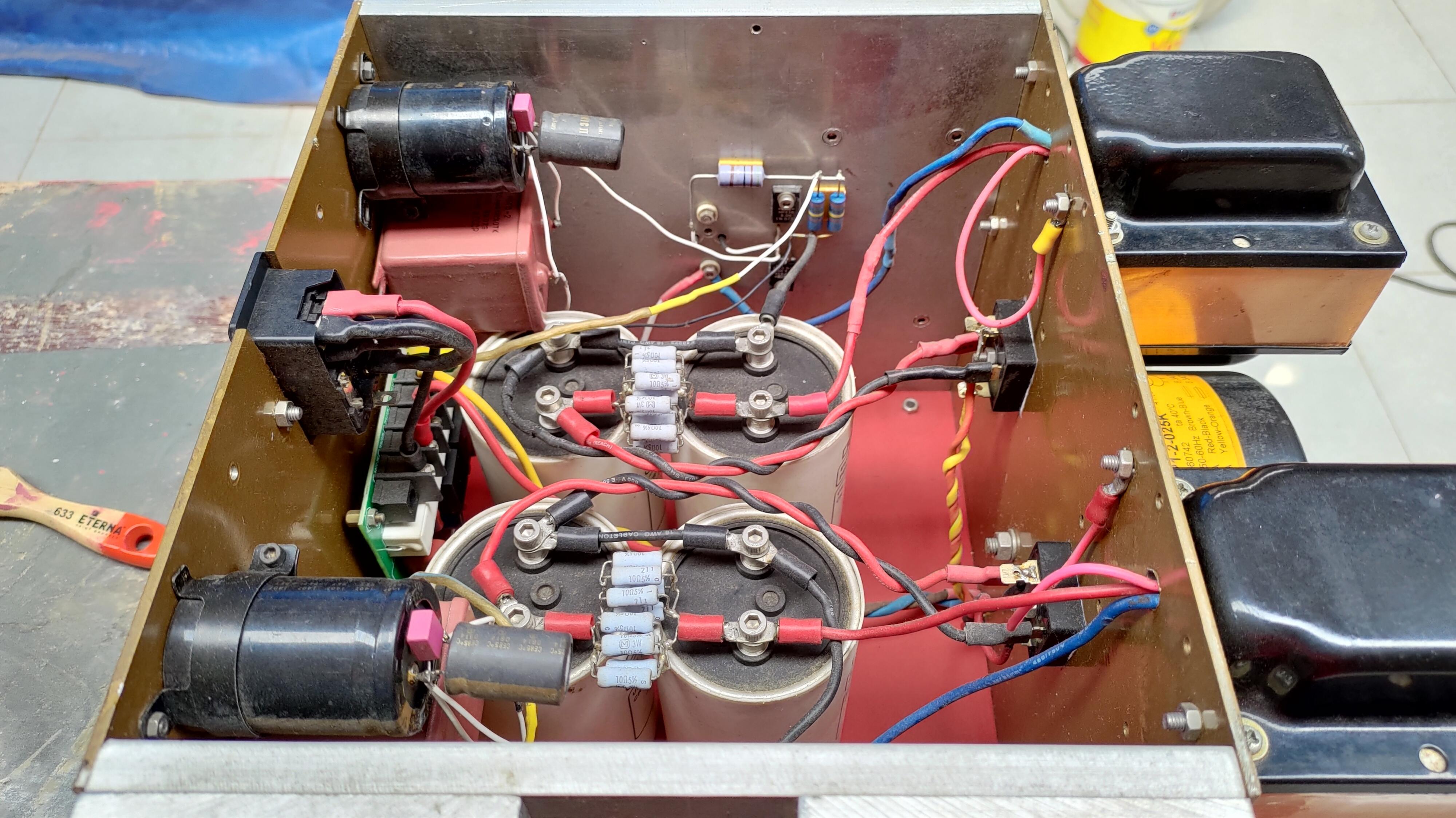

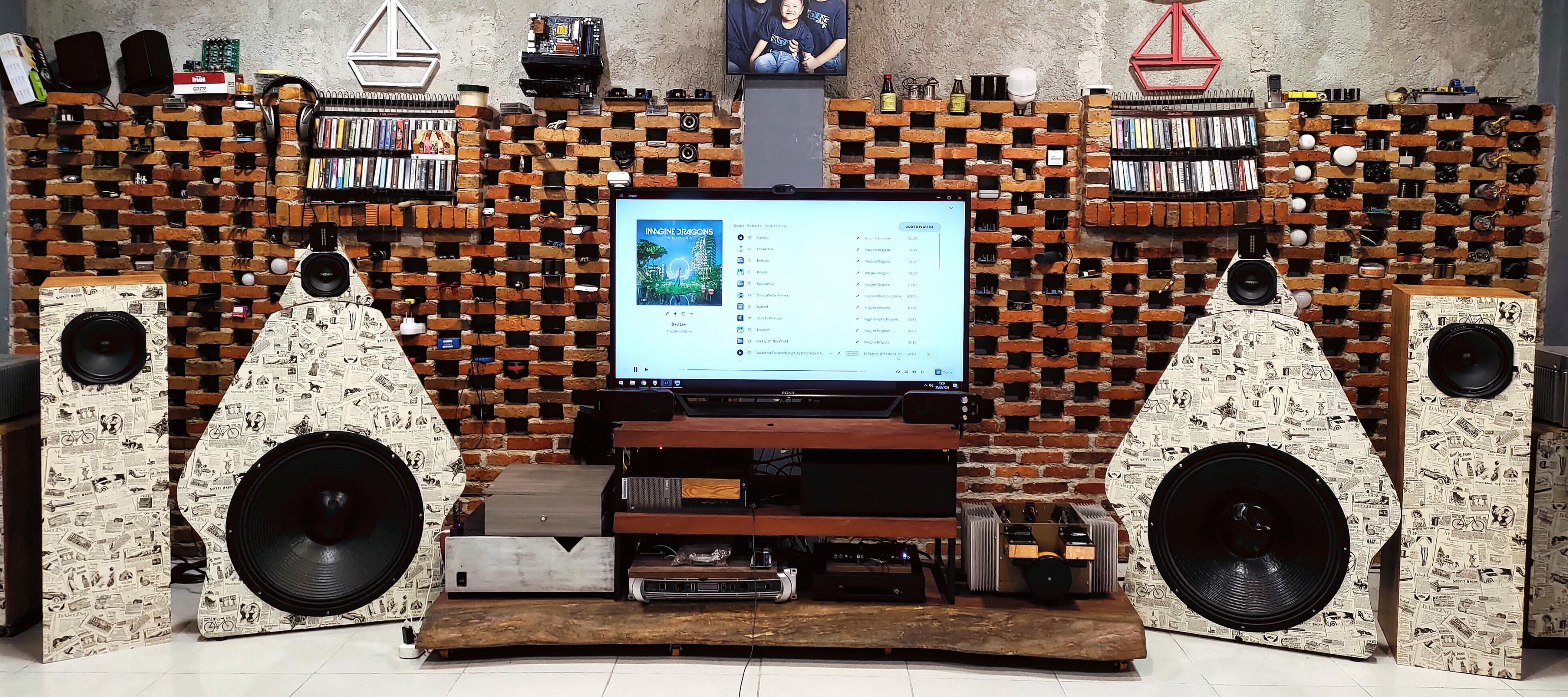

i have listened to my OB multiway for almost 2years using minidsp and class ab amplifier. but finally i decided to finish bass reflex enclosure for Audio Nirvana classic 8
because this SIT has no cover, it is already in dusty condition. air compressor can't clean it up which hardened by moist
Fullrange + SIT : great combination
but honestly this combination does not gove too much excuse on bad recording where it's still fine on OB + class ab. i have to skip on bad music recording this time
additional 8dB bass boost from 40-80Hz on windows and corner placement really help the bass alot. no need to turn on subwoofer for music
