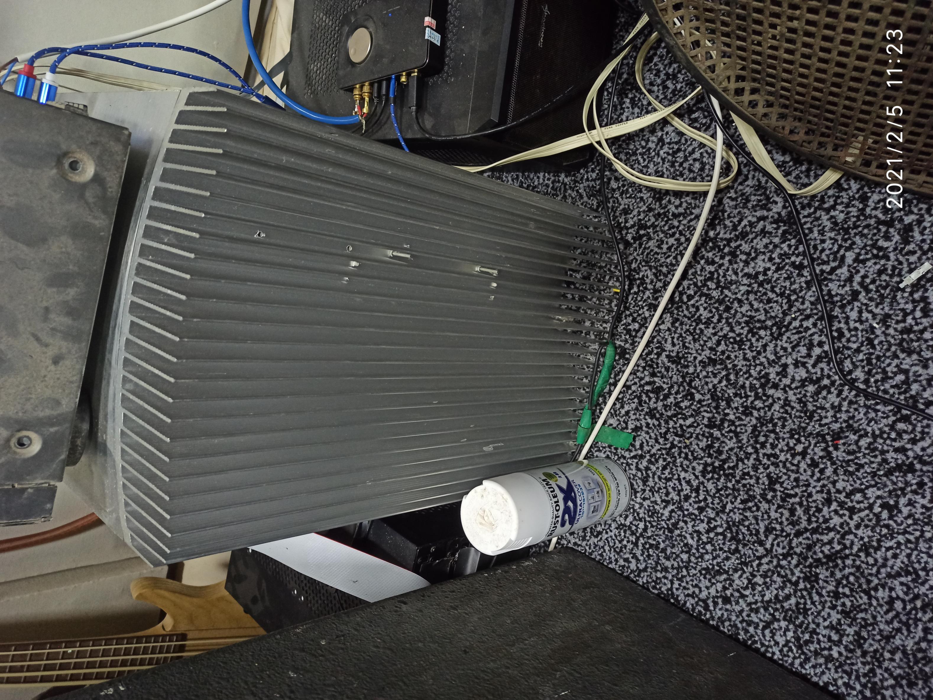

It looks like you have the current limit set to 1A on your lab supply (left side). The voltage on the left side is not maximum either. If you series the two channels of the supply I believe you need to set the slave (left side) to maximum and use the right side (master) controls to set your voltage and current.
Your heat sink is also small if you want to run high Iq.

According to your numbers your string of light bulbs' resistance is much higher than you thought - 30V/0.5A=60R.
Try less light bulbs - two instead of three (reset bias first).

Oh! I thought the three lightbulbs should be in parallel to be « equivalent » to a 300w lightbulb.
I haven't built a L'Amp with bulbs. That may be the reason for the high resistance. Parallel makes sense.

The bulbs should be in parallel. Are these 120V bulbs (i.e. North America)? 🙂
Measure the resistance of one of those bulbs with a hot filament by hooking it up to your power supply with say 30 volts across it. Read the current drawn for your power supply. R=E/I.

the bulbs connected in parallel, like in your videos.The bulbs should be in parallel. Are these 120V bulbs (i.e. North America)?
the bulbs are 220v, perhaps this is my mistake
for 30v on one bulb with hot filament i receive 0.17AMeasure the resistance of one of those bulbs with a hot filament by hooking it up to your power supply with say 30 volts across it. Read the current drawn for your power supply. R=E/I.
maybe i need put more in parallel.
Oh for 220V you need very high power. You need 10 Ohms resistance. For 220V that means you need 4KW bulbs, so I suggest you order 110V ones, you can also find them in Europe, mine I got from France. For this value you would get for 3A about 30V drop, which is about right, you need about half of voltage. OR you could use a nice 195T5 choke from hammond like me 🙂 (and of course reduce voltage)

Also remember that for 3A and say 35V on Drain you consume around 100W on your VFET, I think you need bigger sink than that ob your photo.

Your bulbs then are 176 ohms. 3 in parallel is 58 ohms. So, you're current limited (with a 60V supply) to <1A.
In the 2SK82 L'amp schematic you referred to there are two 300W (120V) bulbs in parallel for about 11-13 ohms.
