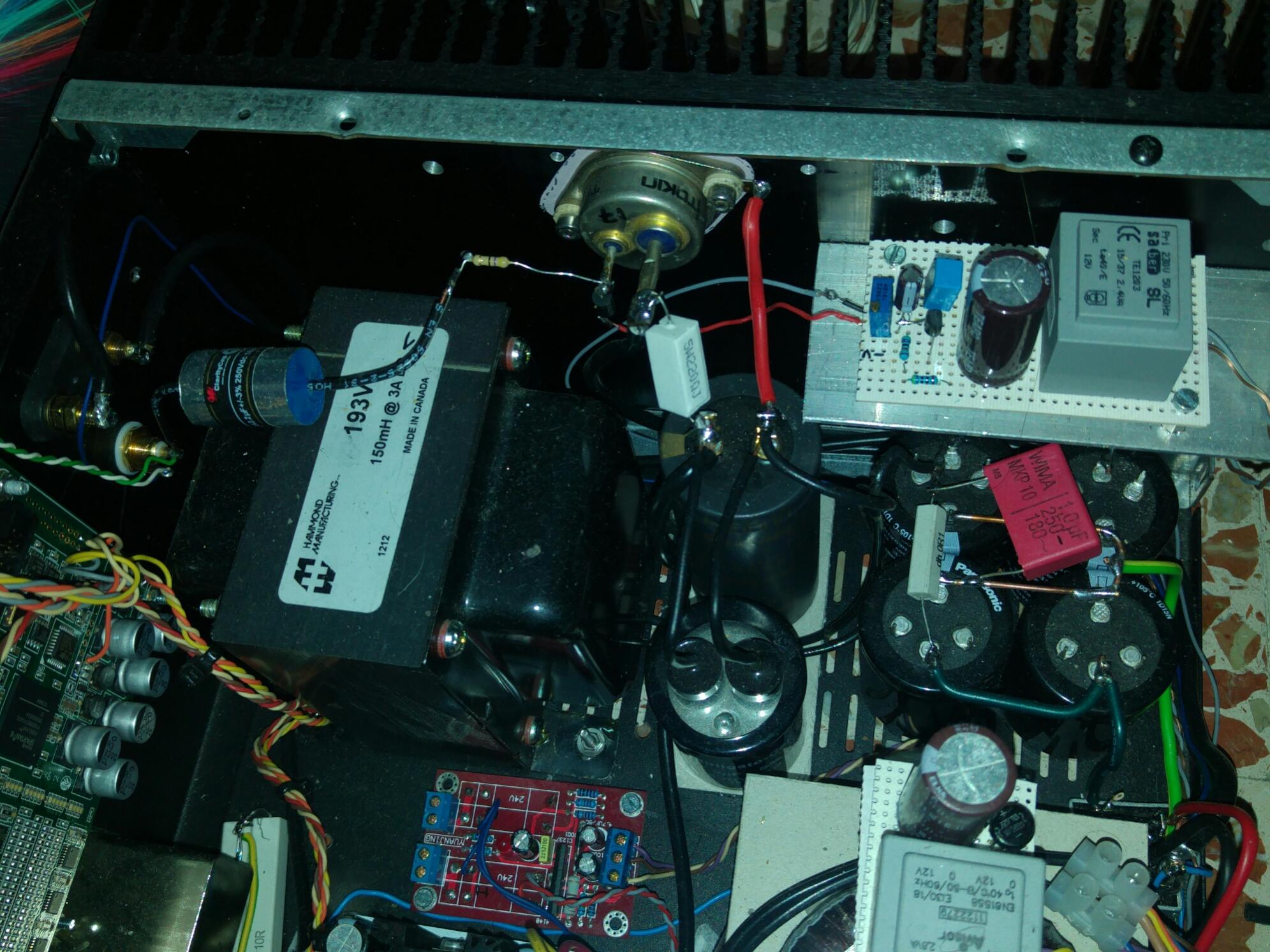

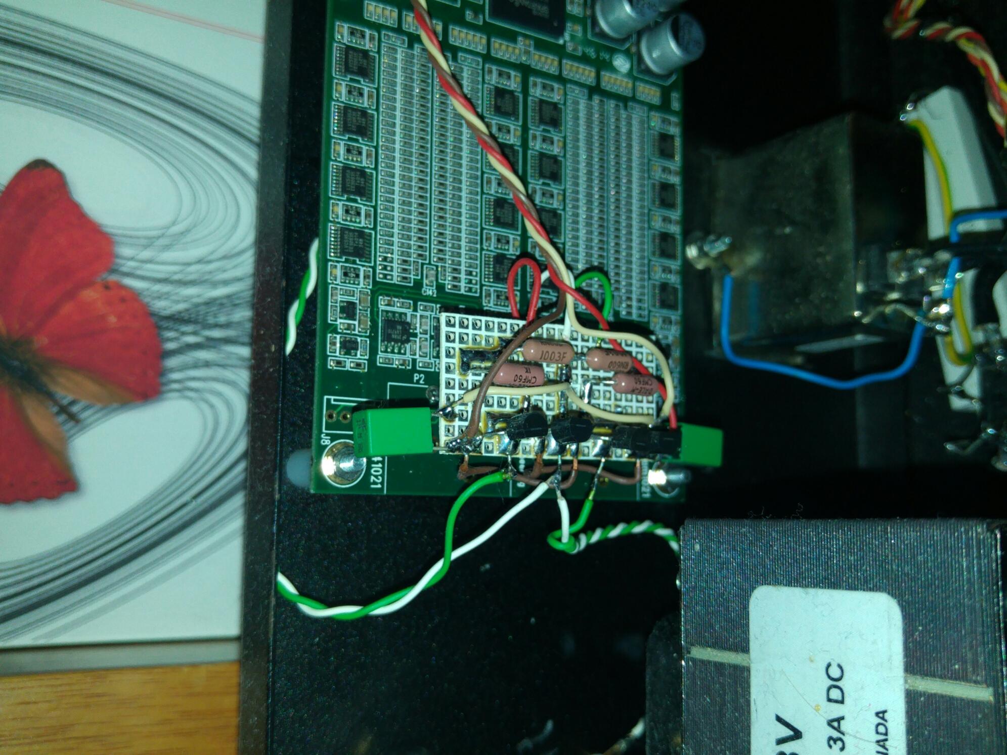

This pcb is Soekris dac, and Mr. Pass buffer with 2sk170 and 2sj74 matched. The final idea is digital input and output to speakers.
Wow, a fully integrated L'Amp

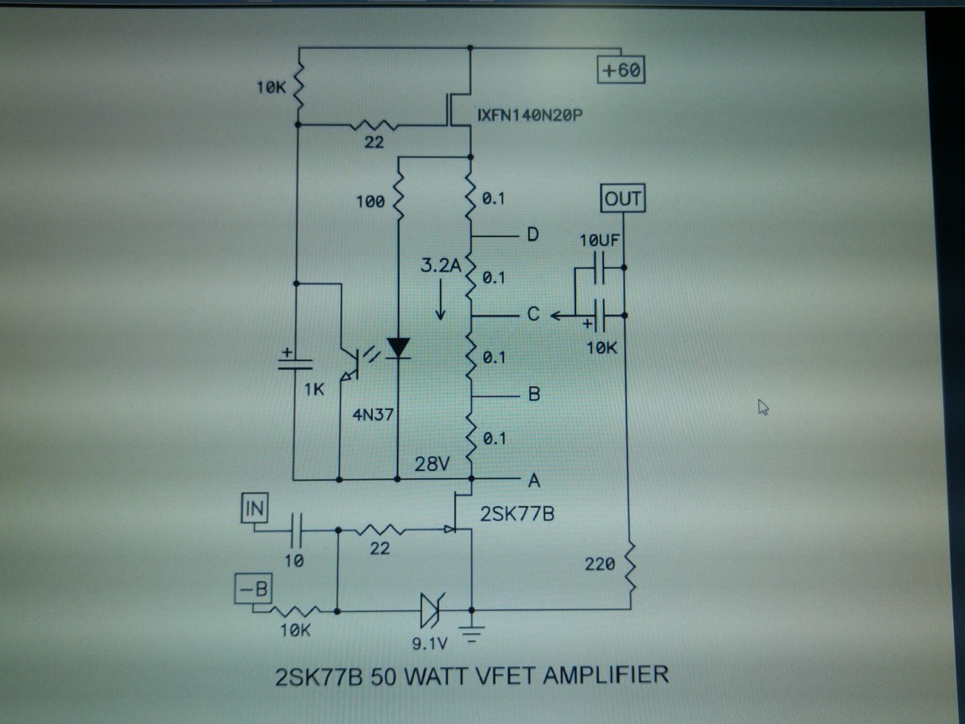

Albert's pair of 2SK180 is a matched pair I received from generg before, and I passed them onto him. He asked me the difference between the various versions (bulb, resistor, 193V, ccs) and I couldn't answer, but now he has all the info 🙂
Very nice to get DAC inside Tokin L'Amp 🙂Hello albertli. Your idea of making lamp with 2sk180 is very good. I have done some versions. The first was with thf51 and 65Vdc 4A of quiescent current. The second one with 2sk180D and 84Vdc 2A; next one with thf51 and the same that second one. And the last with 193V and thf51.
All except the last one were done with resistor (10 ohm 600W and 22 ohm 300W) as drain load.
For me, the first is the better, but heat dissipation was enormous (240W) and the gigant heatsink (50cm x 30 cm and 8 cm) impossible of touch. I got almost 18W rms. Sound, for me very very good. The second better (actual amp) is thf51 with 84Vdc and 2A. With this I get 8Wrms. Enough for me (I am using 100db speakers in open baffle).
The third version, with 2sk180D selected, had worse highs than thf51. Sorry, this was my impression. When I used a scope, I saw that all measurements all worse than thf51, square wave, frequency response and output impedance (more o less 4 ohm). I do not know why nobody want to try this wonderful vfet. I am using low output impedance pre and highs are wonderful.
The last one, 193V version will be a gift for a friend, and sound, for me, is a little dark compare with resistor version. The advantage is heat dissipation a lot lower.
One thing more. For getting channels sound equal,you need select very well vfets. If you can, try use a economic curve tracer, as there is in ebay, because variability is a lot bigger than 2sk82.
If you can get 2sk180, try get D version. They are very very similar each other (at least I own).
Well, good luck in your project.
Jama,
Thanks for all the infos.
I'd build the buffer like you. Please take a look and see if it's the buffer you put on yours. Eh....what cap you use on output ?
Albert
Hi, Albert. Yes, this is the buffer I use. With 193V you do not need a lot of caps in PS. Mine (193V version) have two 22k 0.1ohm 22k, and it is absolutely silent. No hum, nothing. But resistor version, have a little hum (CLCLC in PS, with C 22k 100V and L 2.2mH). I use 10k parallel with 2uf at output. And for input position, 2.2uF.

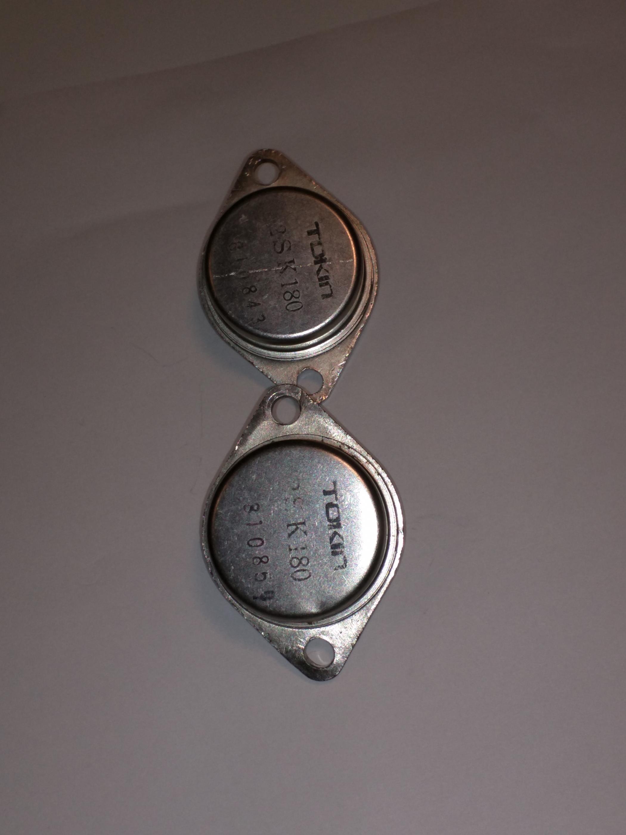

Got a pair of 180 today from Tim today . They're way bigger than what I thought.
All mica insulator I have is not big enough for the job. I have to source the right one now.
Any ideas? Or point me to anywhere I could find them.

Response on that question are in Uncle video Lab Hangout 2.1
it start at 27'min about 2SK180/ 182 thermal pads solutions.
