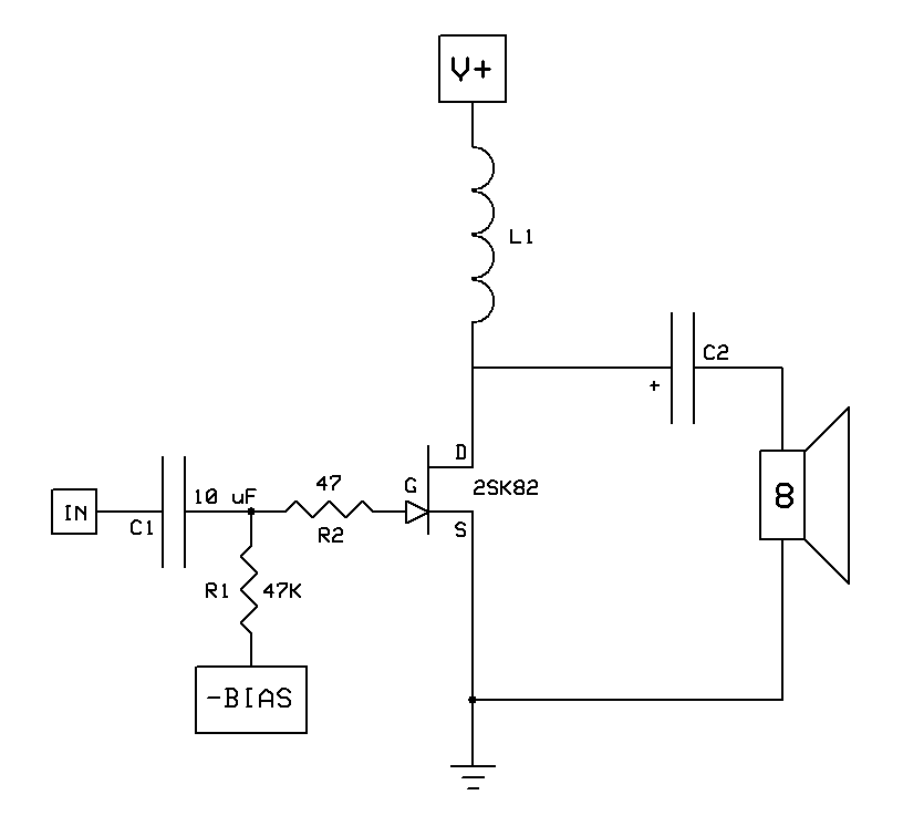

So, maybe you’d like to see a little more gain from our amplifier and while we’re at it some more power would be nice too. And whether you use light bulbs or a resistor, the amp isn’t terribly efficient (not that there’s anything wrong with that) so maybe you’d like to try and improve that figure as well. Oh and maybe you’d like to accomplish all of that without adding complexity to the circuit or more transistors.You’re very demanding, but okay we can do that. Many of the old audio textbooks had amplifier examples which used inductors for the Collector load (Drain for MOSFETs). I asked about this on the forums many years ago and Nelson Pass responded that he’d used a big spool of magnet wire in a Zen-type circuit with good results. A big spool of magnet wire, eh? Again, Pass comes through with a nice hardware store solution. So, I bought a couple of spools, and as happens in this hobby, they went on a shelf and stayed there for several years until recently.

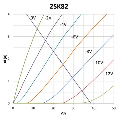

While writing the first L’Amp article, It occurred to me that the middle part of the 2SK82 curve might be interesting with the right load, so an 11 pound roll of 16 gauge magnet wire came down from its shelf. What’s so special about using an inductor as the Drain load? Well, the impedance of an inductor is frequency dependent. The impedance at a given frequency can be calculated like this:
In this formula, f is the frequency in hertz and L is the inductance in henries. We can see that an ideal inductor will have high impedance at high frequency, low impedance at low frequency, and zero resistance at DC.
A big spool of magnet wire isn’t exactly an ideal inductor and there will be some DC resistance and other losses. My spool of magnet wired measured around 110 millihenries and the DC resistance was 5-6 ohms. Lower resistance and more inductance would be nice but we work with what we have.
You may recall from the first article that the resistance of the two parallel light bulbs was around 13 ohms and the effective amplifier load was the bulbs in parallel with the 8 ohm speaker or about 5 ohms. If we replace the bulbs with the spool of magnet wire as in Figure 1, the effective load of the amplifier will be:
Since the impedance of the inductor will be quite high compared to the load at audio frequencies, the effective load is approximately equal to the speaker load or 8 ohms. An 8 ohm load line would be a bit flatter and might just do the trick in the middle of the 2SK82 characteristic curve so we plug in the inductor (Figure 1) and search for the sweet spot.

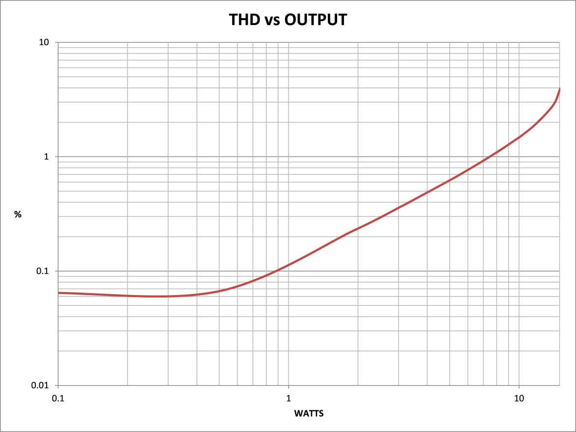

Our 1-watt distortion is about the same, but now we’re reaching 12 watts with less than 2% distortion (Figure 2). The inductor stores energy in its magnetic field which effectively increases the supply voltage (double in theory). This increases our maximum voltage swing and you may have noticed, I lowered the supply voltage to 35 volts. Our efficiency has improved from 4% with light bulbs to around 20%. The gain has gone from 6 dB to approximately 8 dB, which isn’t a lot but it’s about as much as the original 1994 Zen.

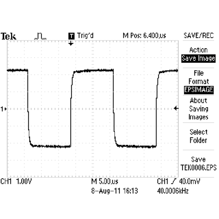

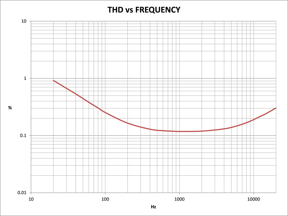

Figure 3 is the distortion vs. frequency and the higher distortion at low frequency is evident. A bigger coil would help but we’ve seen worse.The frequency response was -1.12 dB at 20 Hz and -1.72 dB at 60 kHz. The output impedance was approximately 8 ohms and the amp didn’t have a significant turn-on thump. Figure 4 is the square wave response at 40 kHz.

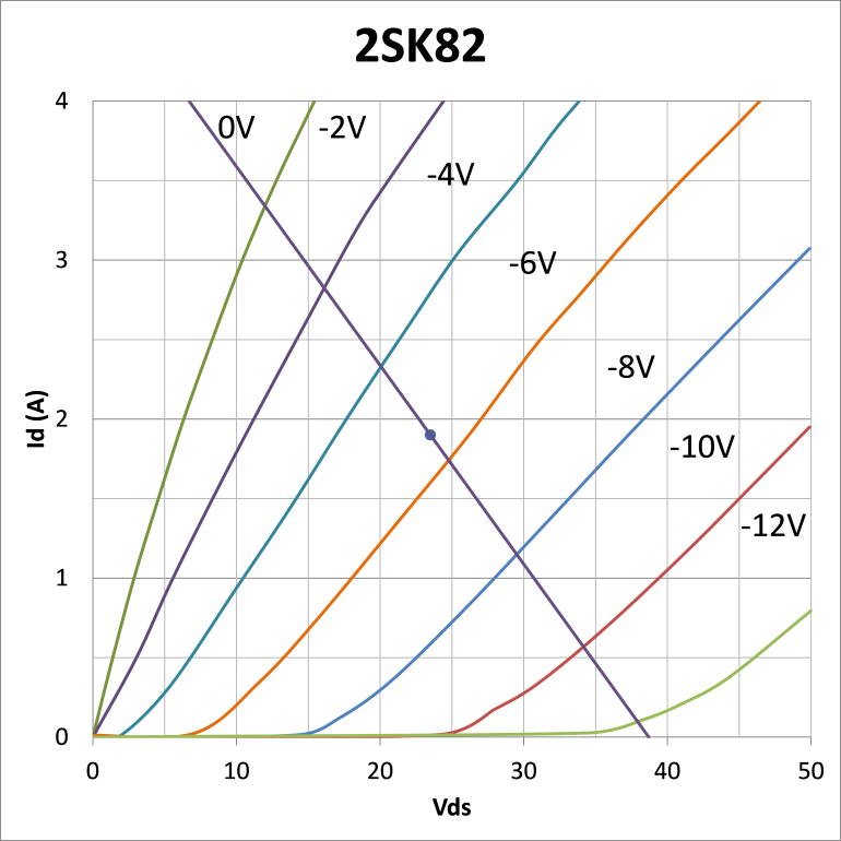

For fun, here's the load line:

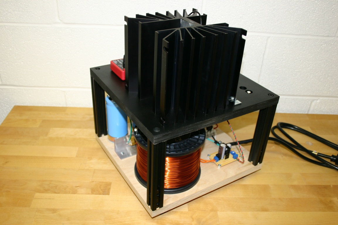

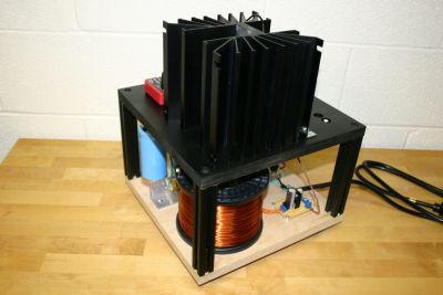

Heavy Metal

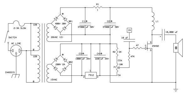

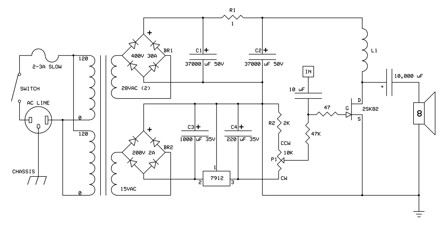

This is a heavy amp which may appeal to you, audiophiles like heavy equipment. One of my monoblock channels with transformer, inductor, heat sink, and case weighs over 25 pounds giving it an impressive audiophile-approved weight to watts ratio. Each spool of magnet wire will set you back twenty times the cost of a pair of light bulbs and about half the cost of an output transformer. The magnet wire I used is made by Essex, and each spool is wound with approximately 1,400 feet of heavy-insulation 16 gauge with a resistance of approximately .5 ohms per pound.Figure 5 is the complete schematic for a monoblock channel. I used a transformer from Antek with two 28 volt and two 15 volt secondary windings. The negative bias supply is just a typical application note circuit using an LM7912 negative voltage regulator. You can try something much fancier if you like. P1 adjusts the bias voltage and R2 sets the minimum bias value.
Once everything is assembled test the power supplies first without the amp connected. If everything checks out, then adjust P1 fully clockwise and bring up the power. You should measure approximately -12V from the wiper of P1 to ground. Now slowly adjust P1 counterclockwise (towards zero volts). You’re looking for approximately +23 volts from the JFET drain to ground. The idle current (about 2 amps) is equal to the voltage across the coil divided by its DCR. The bias supply will be around minus 5-6 volts. If all goes well you’re ready to connect them to speakers and try them out.
NOTE: The author suggests that you should always have a speaker or dummy load connected when powering the amp on and off. Furthermore, you may wish to install a 200 Ohm, 3 Watt bleeder resistor from output to ground to safely discharge the coupling capacitor in case you should forget the foregoing.

Michael,
you mention a hefty bump possibility when turning on off. Is that due to the inductance?
How about a diode across the choke (inverse)? This is done with solenoids. == or one in series. So no energy goes to the power supply. I have seen this in tube amps. Only for the turn-off bump, to prevent Tesla's energy spike from developing.
just a few ¢.

Nothing to do with bump. I was addressing the accidental omission of a bleeder resistor in the drawing. Here's the entire quote:
I don't think your music would appreciate the diode. Have fun 🙂
