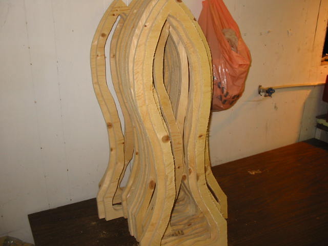

If I may, I suggest you forego the belt sander in favour of the 6 inch random orbital variable speed PSA sander. I have a couple of them and they are the gift to non linear woodworking. It allows you to work in multiple planes and make smooth transitions. The random action means it is a non directional cutter so you do not need to worry about going accross grain, the variable speed allows you to adjust for cuttng diferent material types. I used mine on the hull of a canoe project and it turned out incredibly well. I do not think a belt sander would have come close.
For the side panels you may want to add contour layers to the sides so you can have a completely non linear project.

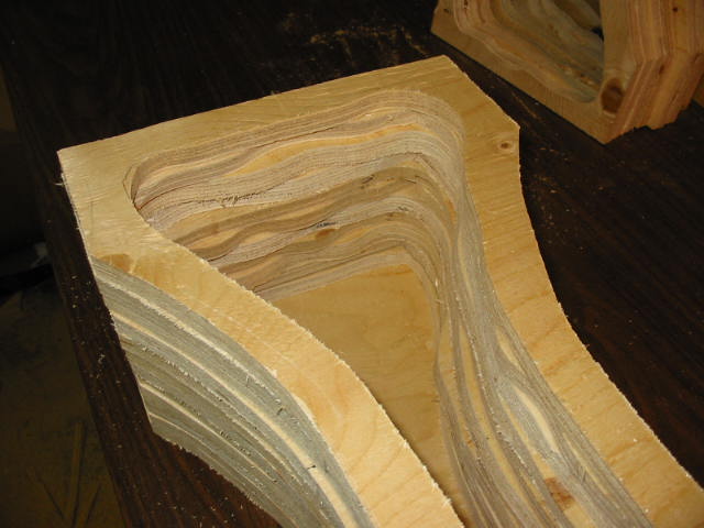

The King Arthur tools lancelot and squire on a small grinder are an incredibly fast and fun way to do your roughing in.
Of course read and abide by all the safety requirements. I wear welding gloves, face shield, safety glasses, dust mask, long sleeves, hearing protection... You get the picture. Two hands on the tool at all times and clamped down workpiece. Be careful not to cut into the endgrain of the ply (tearout)
Otherwise, these are a joy to use and can cut down on your belt sanding time significantly, especially if you move onto the big ones.
As an added bonus, you can carve those scales...

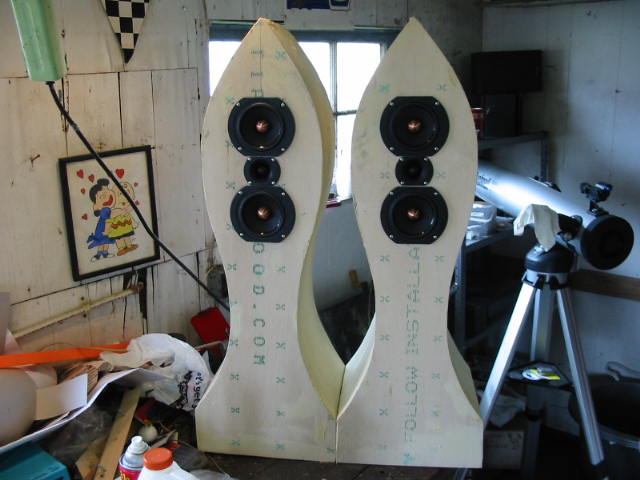

This is getting fun. The cabinets are together and ready for final sanding before paint. I'm impatient so I put the drivers in for a listen.
The sound is pretty good. Those drivers sound bigger than they are. So far running the WR's straight and a 1 mfd cap on the tweet. Light stuffing. Think I will add more and maybe add a coil to the woofs.

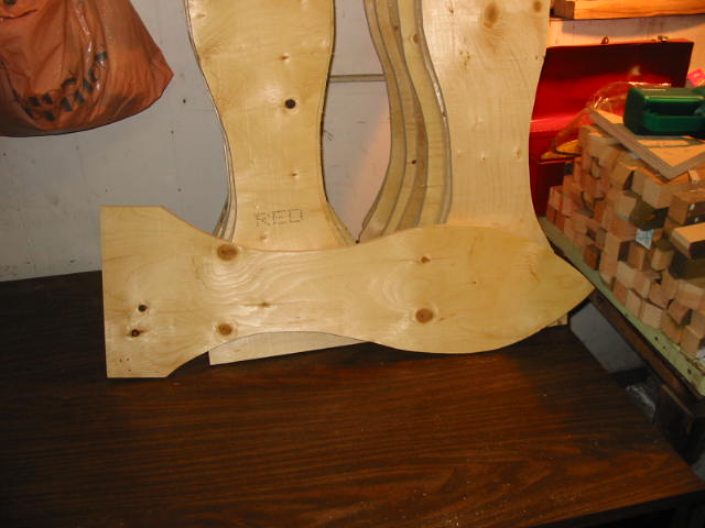

They don't look quite like fish or beer bottles but I think I'll use the inside part of the cut out and recut them to look like fish and decorate a big ugly wall at the back of the property.

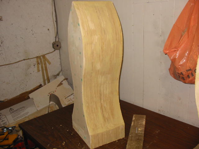

Should have read your posts before I answered.
It seemed to go fine with the belt sander, after I couldn't find a spindle sander that is. Great day for sanding, got the stuff spread around quite nicely, including places you should never find dust. Oh well, a half tank of hot water later I was good as new.

Couldn't wait till they were finished to listen.
OK, that's seven pics, guess I can't count.
First impression with only a 1mfd cap on the tweet and the WR's running straight was good. Then I went in for breakfast.
I had stored the drivers in the garage so when they warmed up they actually had some midrange and it was obvious that XO was not going to do. After spending the afternoon smiling and having a beer or two and I now have a 12dB top and bottom around 8K. I suspect I will fiddle a bunch more. What a difference cold drivers vs. warm.

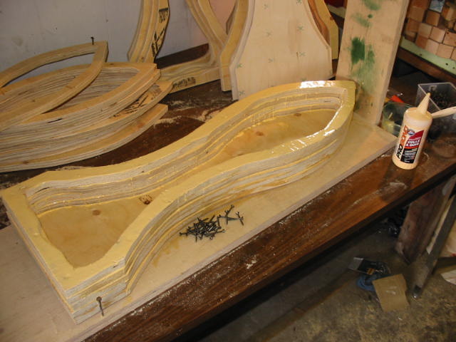

- Laminating cabinets
