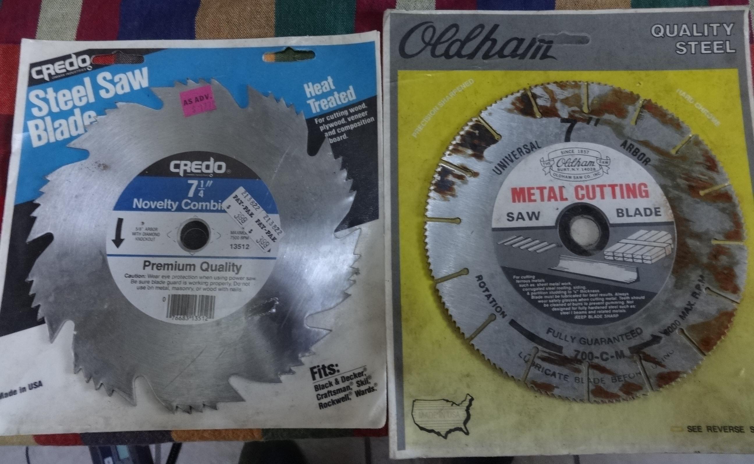

I got one shot at this, to make a nice clean cut on laminated MDF, about 2" thick. I have a circular saw, was hoping to use one of these two blades. Thanks!

Left if you must, but OOOF!
If you can be kind to yourself, go to a big box store and get a Diablo 7 1/2" 48t semi-finish. It's a nice balance between clean cutting and material removal. It's also awfully affordable. Below that I'd recommend the 24T rip and if you want to splurge and go slow, the 60t.
Laminate tends to chip. I've only been able to prevent chips by having a backing board hard pressed against the laminate. But that is going to make the work 3 plus inches thick. Is it laminated both sides, or only one?

I had used the blade that had been used on many projects prior here when I cut my counters some 15 years ago. I recall cutting from the back side.
Just go slow, and use a guide, maybe clean any residue from the sides of the blade first.
You want the "a-face" to be entry point of the cut so that any chipping/blow out occurs on the "b-face". Circular saws spin such that the bottom is cut first which pulls the saw to the material rather than push it away, increasing stability. So, yes, you're correct. 🙂
You'll get the best cut on MDF using a blade designed for MDF/laminate (they exist- might not be cheap though) and a nice heavy guide.
