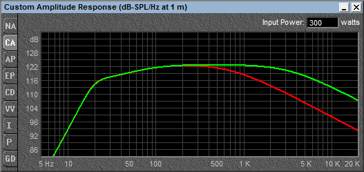

The question still remains... which woofer can do -3 dB @ 20 Hz and be crossed over @ 1 KHz like the Reflexion Arts loudspeaker using the JBL 2235H driver... Two way design (3 way if it includes the BMS 4594ND) encompassing the entire frequency range...
this is for a relatively small room (2000 cu. ft.)... a critical monitoring situation.

The crossover for the 4594ND is not built into the unit. They do have a separate crossover you can buy though.
In reality the best woofer for high end would be the TD15M, but best for the low end would be the TD15H. The TD15H mirrors the response of the 2235H almost identically. The TD15H is however slightly more efficient, has 14mm Xmax vs 8.3mm on the 2235H, .2mH inductance vs 1.2mH, has about 2x the power handling, and the full copper sleeve on the pole will keep inductance linear and eliminate flux modulation. That all said the TD15H is far superior, but as you can see below the low end response curve is nearly exact. The TD15H is in green and 2235H in red.
If you are going up to 1KHz I see no problems at all doing so. I have done similar for recording monitors in the past. The main thing is to make sure that the waveguide you use will work well down to that point.
