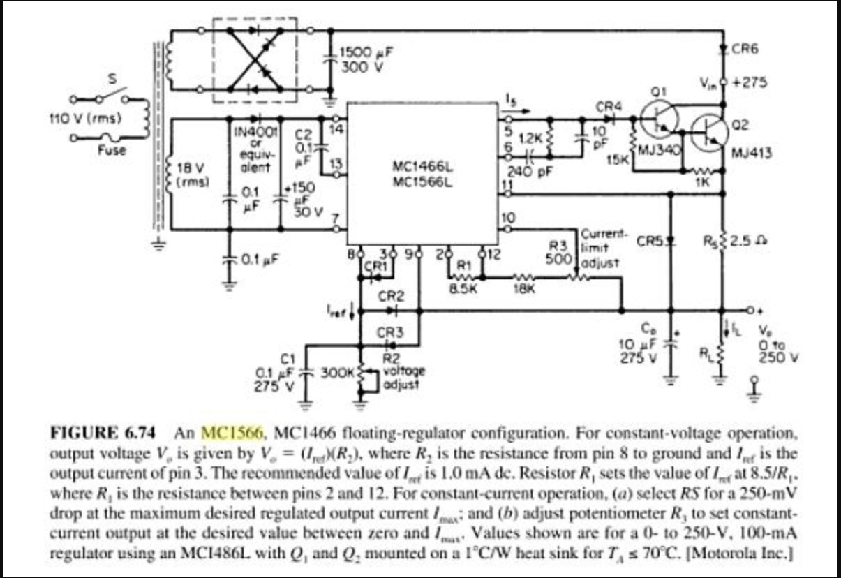

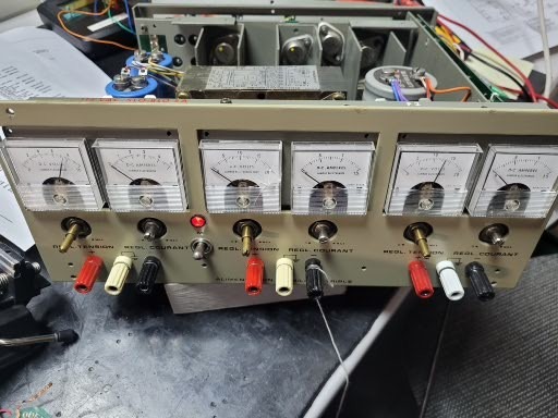

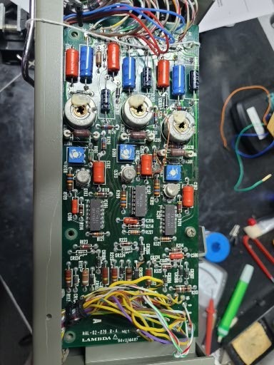

I bought this power supply out of order. I repaired one of the 20 v units, the other has a more serious problem since one of the printed circuit track has melted. Someone tried to repair but without success. The track has been replaced by a red wire and the IC 201 replaced by an MC1466L. I tested the capacitors and checked if the power transistors were in good condition... everything seems normal to me but the unit still does not work. I had the idea to replace all the transistors but I don't know what are the commercial number. I would be happy for any suggestion...
I put in copy two pictures of the power supply and a diagram showing in green the melted track. Thanks in advance
