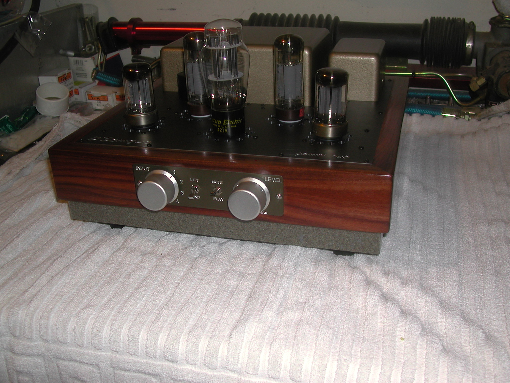

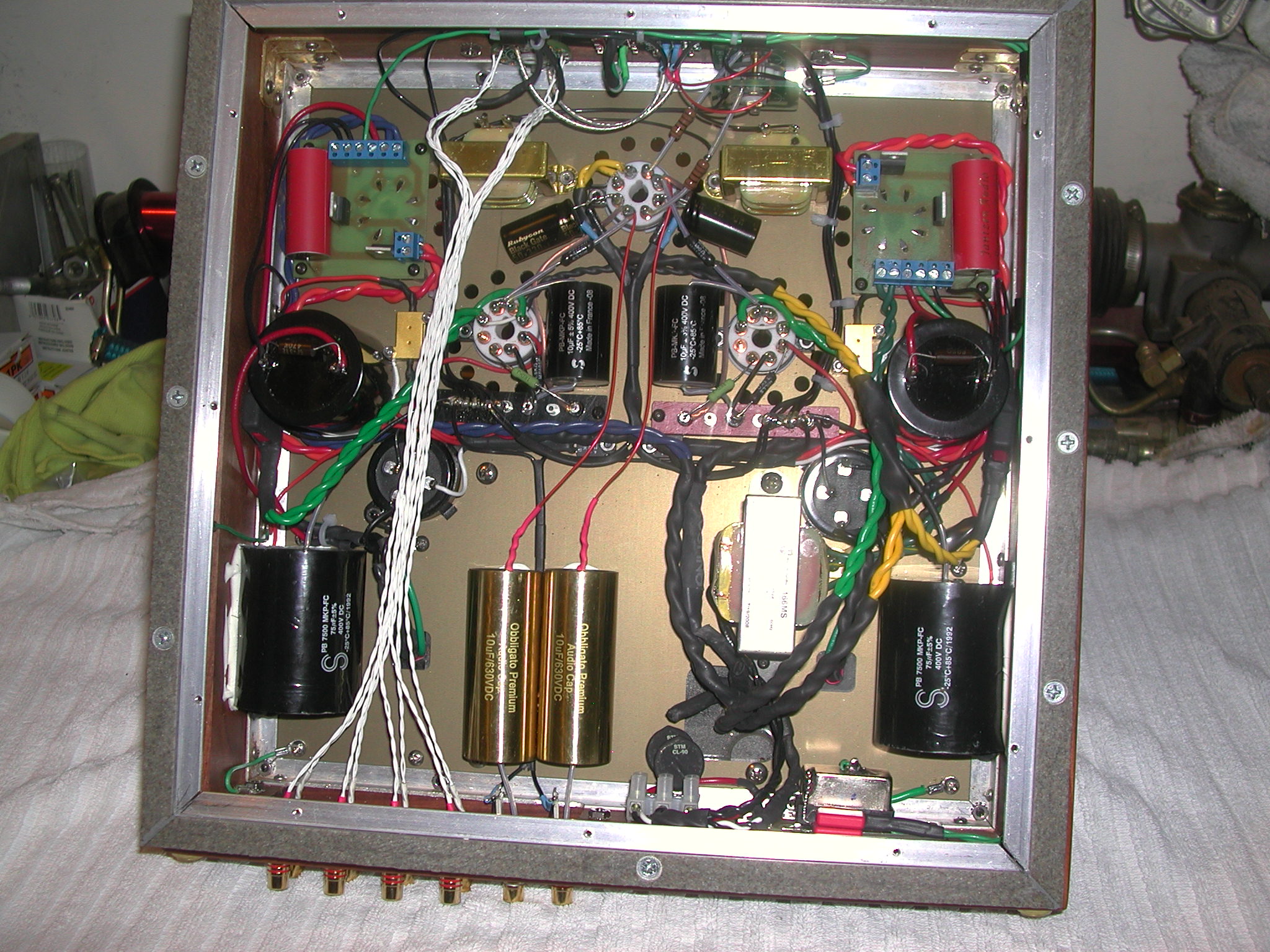

Just found out that Nuetrik makes (what they call) a tiny XLR connector.
The panel mounting hole size is .44" (11.2mm), where as the RCA holes in my pre are .47".
A pair of the "tiny" XLR's can fit in the input panel one for one. Also, there is plenty of room inside my pre for a pair of the Cinemags. My pre is a self built S.E. tube jobbie.
Doing it this way will allow for a set of balanced cables from the Lagato2 to the pre, and the Cinemags will provide galvanic isolation to boot. The internal wiring in the pre from the traffos is about 3" of .5mm Mundorf silver/gold, so capacitance is nill.
I'll run the Lagato2 to Pre in Balanced, and I'll find a proper pair of output traffos for the S.E. duties.....
JD

Actually, I'm doing both. I can't predict how my future systems will be configured. My Buff2 / Lagato will have both a single end out (with the Ll1684 lundahls) as well as the Lagaotos balanced out.
I'm modding my DIY tube pre (pictured elsewhere) to have a balanced in with a pair of Cinemag CMLI-15/15B transformers transplanted into the case (I have enough room) with a pair of REAN tiny XLR's that fit into a pair of existing RCA jack holes. A relatively easy conversion.
Neutrik TINY XLR
This way I can mix and match with a variety of equipment
JD
Why not do the bal->se at the destination rather than the source? Sort of defeats the purpose of having balanced signal...
