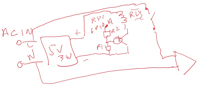

Hi Charlie,
I've built something to power my amp on and off but it's really simple. I use the 5v supply for my r pi and a latching relay, though I only show one leg, which is ok with a better 5v supply.
I just use a pi gpio pin to turn on the relay and trigger it via whatever event I want.

This is like the Arduino. It's about a simple as it gets, if indeed that is all the code you need. I will look into this a little more.
Well, whether you want to use a GPIO pin or my method that requires one $50 cent op amp (an LM358) and a few resistors, you still need the basic transistor-driving-relay circuit to switch the relay, and the flyback protection on the coil.
So I could design a PCB so that you could connect into the circuit at the resistor feeding current to the base of the transistor if you want to use the GPIO pin method (leaving the rest of the board unpopulated) or go the full monty and add the other stuff as well if you are using my approach.
I could easily write up a separate plugin that switched the GPIO pin instead of outputting a signal to an audio port. This doesn't seem like a big deal on the surface of it.
