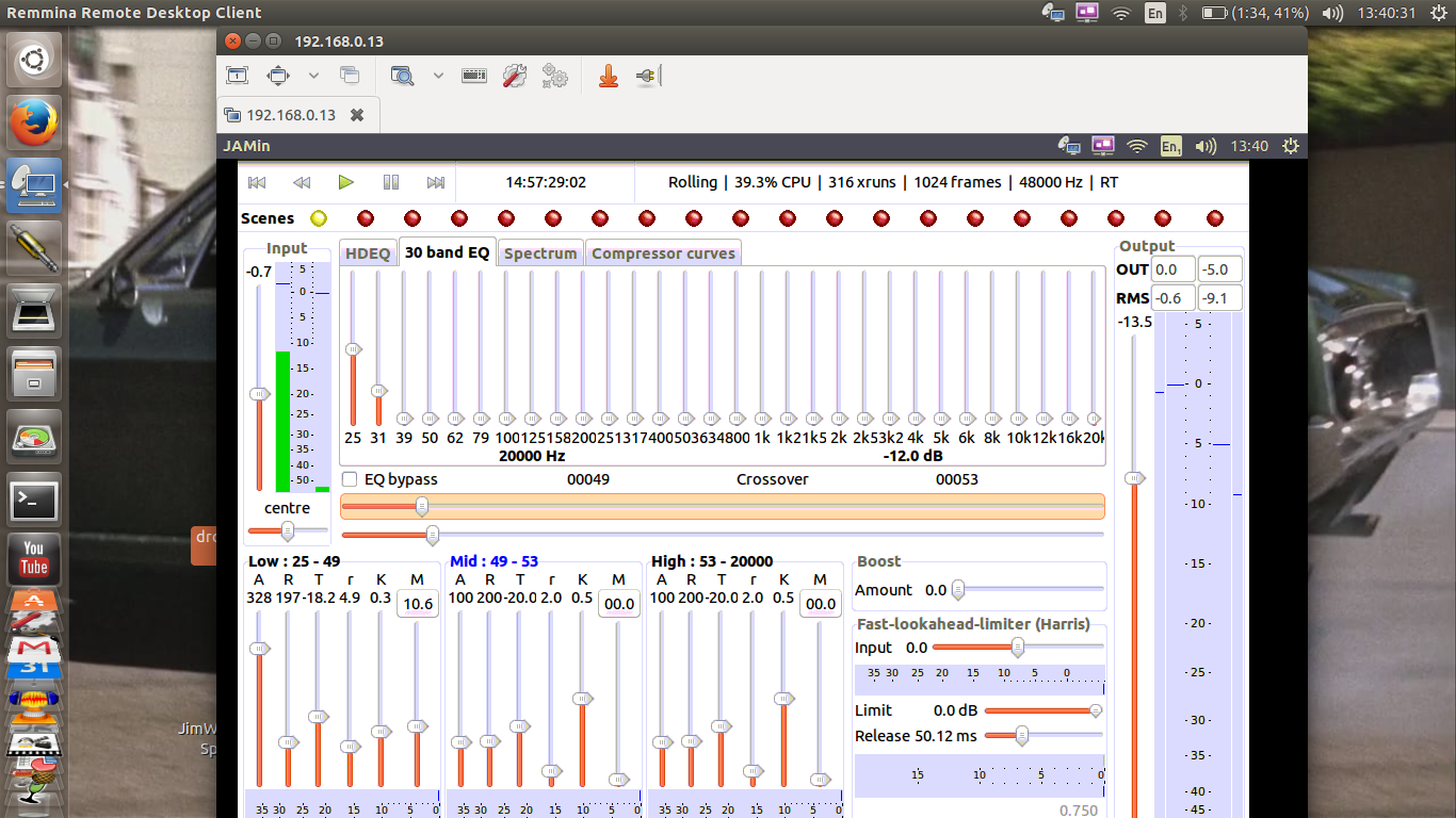

Hi, thanks for helping with my issue. My sound card I was using is a cheapy chinese thing and don't work properly.
My system is a Raspberry Pi model b with Openelec's Kodi installed. I have a Behringer DEQ2496 controlling my IB sub. I always felt the DEQ was wasted and installed it into the chain to EQ my main speakers with its AEQ room measurement system. I have replaced the DEQ sub duty with an Acer Revo, I installed Ubuntu 15:10 on it and installed Jack. I installed Jamin which provides lowpass crossover and a couple of useful bands of EQ.25hz and 31, the other 28 bands are too high to be usable.
I would rather have more bands to play with. I use my laptop and remote desktop to talk to the Revo.
Can I ask, has anybody got any thoughts or ideas on my system?
Mike
