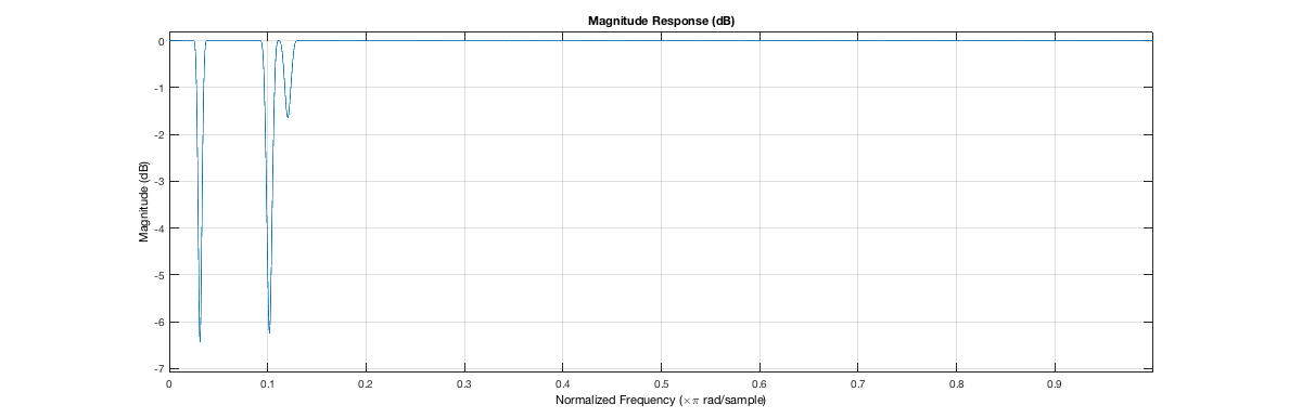

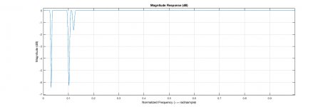

I have been using data from Room EQ Wizard to try to improve the listening experience in my very difficult room. I have a mode at 760, 2450, and a minor one at ~2900Hz. These modes can be addressed using 2nd order eq filters in the ALSA LADSPA plugins, and they work fine. However, when running these eq filters on the raw Squeezelite output, I lose some of the expansive spatial presentation of the soundstage. The loss is directly related to the amount that I cut each of the three bands. For loud play I need more attenuation, while for mid-level play I can halve the peak attenuation and improve the spatial presentation somewhat. I'd like "all the best all the time" even knowing that audio is inherently a shell game of trade-offs.
Hoping to avoid the phase shifts of IIR EQ filters, I am in the process of investigating FIR filters for this step. Knowledge-wise I'm starting from scratch, as always! I think of these filters as 'pre-eq' because they are ahead of the IIR crossover (3-way, LR4) plus a couple of minor bottom-end corrections limited to the bass channels. I was able to approximately match the IIR 'pre-eq' filters using the 'fir2' algorithm in Matlab - graph below. The easiest way to test them is using the FIR convolver in SoX. I find that 1024 taps at 48kHz uses about 18% of the BBB's available CPU. That's about the max I can support if the system is going to function as high as 96kHz. Sure enough, there *is* better spatial representation.
However, the down-side is that there is less sensation of 'smoothness', for lack of a better term. A bit of a gritty edge comes along with that soundstage. At this stage, I'm thinking I should try BruteFIR - which will be a shallow learning curve for sure! But then I can try FIR with reference tracks whose resolution is better than the stuff I'm now playing via USB.
Assuming that the details of the implementation are all important, I'd love to hear any suggestions from any of you with experience designing and using FIR. I've only tried a few linear-phase coefficient sets - single precision. Again, I think 1024 taps will be max. Any and all suggestions/comments much appreciated!
Frank
Frank
