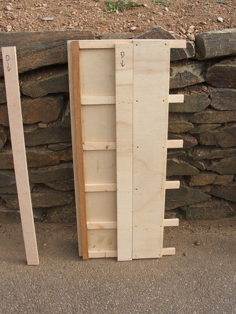

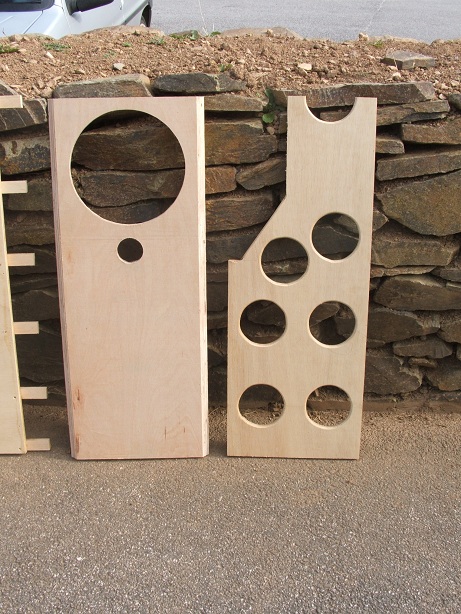

First picture shows front baffle and brace - might have taken a bit too much out when cutting holes.

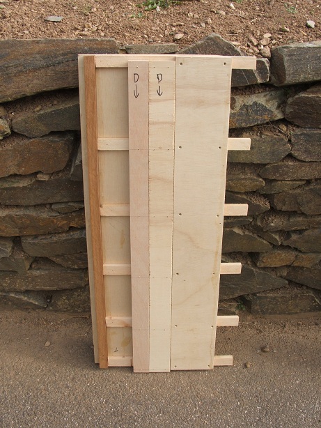

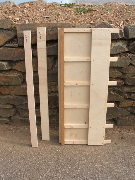

Picture 2 - 4 show alternate vent parts, When all are in place these give a vent length 'close' to JKRO's, the wider of the two parts installed gives 'close' to Dave's modified porting.
A cunning arrangement with plenty of scope for twiddling state of tune.
