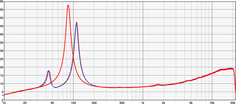

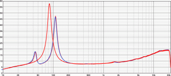

Don't recall ever seeing even a sim of a Fonken, so no clue how close to aperiodic it is. Ideally, we need a measured impedance to find out.
Not completely aperiodic, just towards aperiodic... an example impedance of the original FonkenPrime vrs a typical FE127.
dave
Thanks, I assumed as much, but always nice to know for sure. 😉 Looks like what I strive for in my MLTL alignments and knowing how 'tight' they sound, no doubt yours do too.

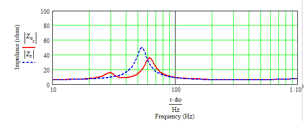

Here's the simmed impedance for my ~10.58 ft^3 net MLTL:
GM
