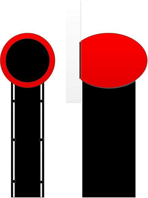

I have what is likely a stupid question I would like to ask. I will be recieving a pair of the 12LTAs later this week. I will play with them on open baffle but ultimately they will likely go into a box for my son who does not have the space required for an OB. To get these speakers to fit in his space they will likely be located in a space that is too close to walls, at least on one side. To accomodate his space I would like to make a narrower version of the EmKen that utilize a larger "cylindrical head" to accomodate the actual driver. This head would be open to the tower base internally. My question is, are these types of alignments changeable assuming you maintain the volume and vent space? Of course I would have to ensure that there is adaquate space around the driver as well. I envision building the head out of laminated rings glued together, this would also allow for an internal cavity with variations to reduce sound bouncing back through the cone.
Somthing like this:
Somthing like this:
These designs are VERY specific (thank goodness for Planet10 & his generosity/curiosity) so I don't think you'd be able to 'adapt' the design
To be honest the 12LTA is great in a sealed box and the size you're talking about would be pretty good on bass and in a sealed box its tight & fast. Have a look for another thread on the 12LTA started by Godzilla. I participated and we had a hoot!! Its the biggest thread on the driver on DIYAudio with the most info.
Not a bad look btw your design
You could reconfigure to look like that. All the appropriate detail would need to change, and too keep the driver height appropriate they would be much deeper.

wont the 'head' act as a sort of rear chamber and change how the restrictive ports are loaded? Also volume looks to be 60% of Emken

There would need to be no restriction in the transition from the column to the head. There may need to be additional damping at the bottom.
The reduction in width may require as much or more than a doubling of the depth if made as skinny as the illustration.
dave
Aha - so volume is still important for the tuning to work. At double the depth would the slots have to be longer and narrower?
