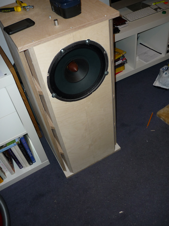

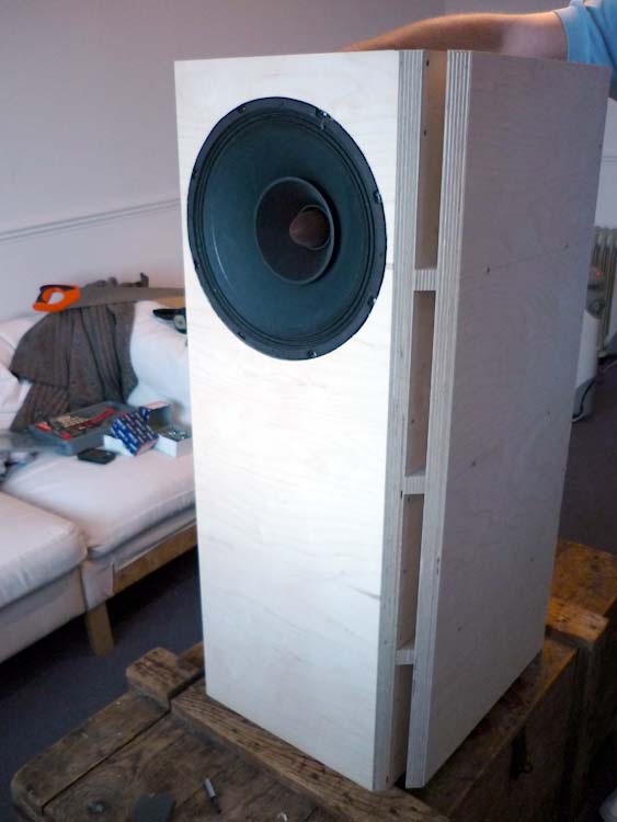

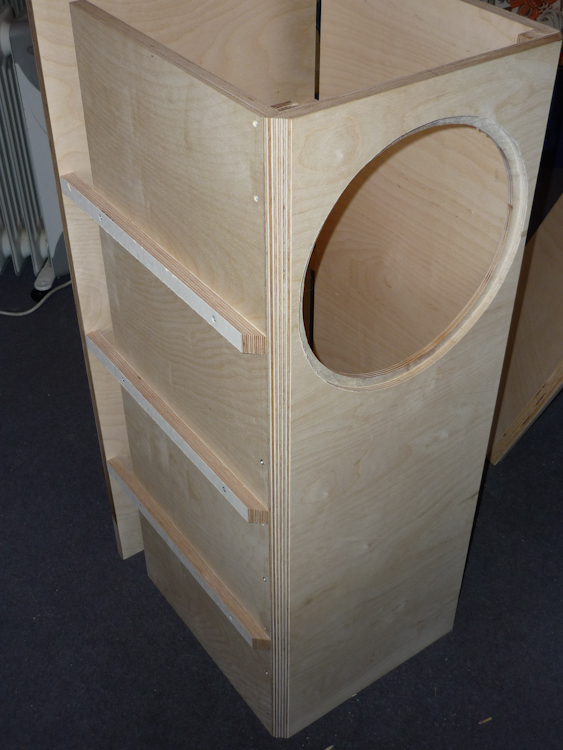

With thanks to Dave (Planet10) I present the Emken. The biggest mini-Onken using the Eminence 12LTA
I'll post more pix later that I remembered to take during the build. They use a FT17H helper and sound, in a word, AMAZING. For detail and accuracy they are headphone like

Sick! Just SICK! looks really cool. what kind of cabinet treatment is planned, veneer? Fleckstone? Asphalt driveway paint?
Oh yeah the top and bottom vents are open? Unfinished perhaps?

Hehe yeah its not mini for sure. Its driven straight from a hifimediy 2050 via cat5 cable, no filter. The FT17H has a silver foil 1uF or 1.5uF to taste. No nasality that I notice. I have a wooden phase plug that really smooths things out.
I'm a massive fan of the big driver sound. These go plenty low (i need a cable to test an iPhone freq generator app i have). I had to get used to the bass as at first i thought it was light, but having listened longer I find it is in fact very accurate rather than boomy or weighted in the lower regions
No idea on finish - cant stop long enough for listening!! all vents are open

The original intention was that this would be another stab at a "mini" PA with hifi pretensions... from James feedback we have at least the hifi pretensions covered -- and the driver can't help but get better with treatment. Need to find a complementary bass driver for it that can be fitted in a simlar footprint box forPA use.
Zilla's comments on the 12LTA goosed me to move on the project. I have just found where my set were hiding and we will be doingour own build. I have phase plugs and will be using the Foster tweeter that came in the RadioShack tweeter pod.
dave

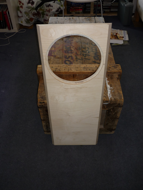

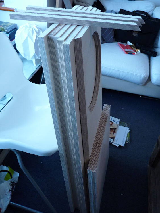

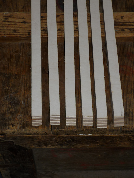

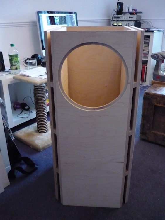

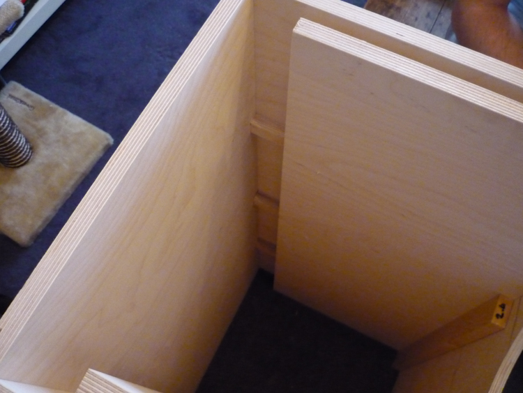

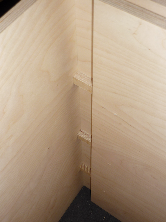

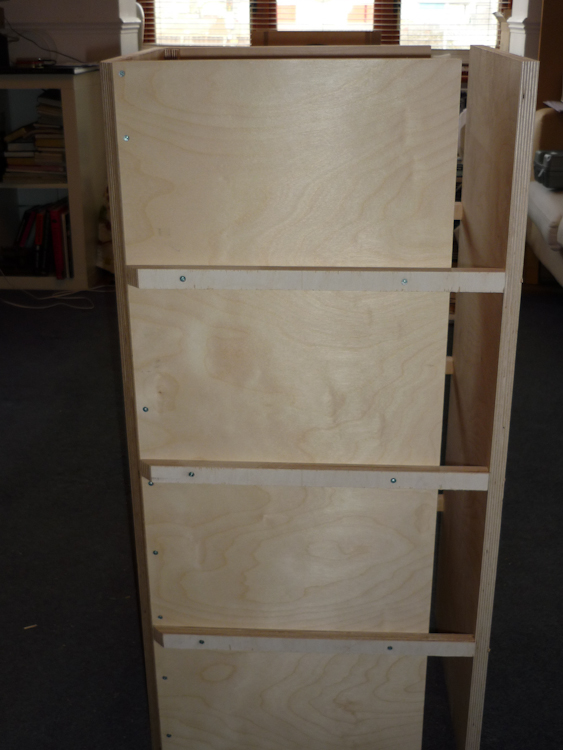

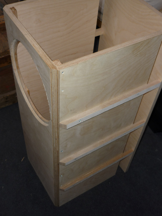

some more pix for you guys
Last pic shows them as they are at the moment. They've been lined with wadded cotton. I've yet to cut the corners of the tops & bases - gotta get its done but listening is getting in the way 🙄
